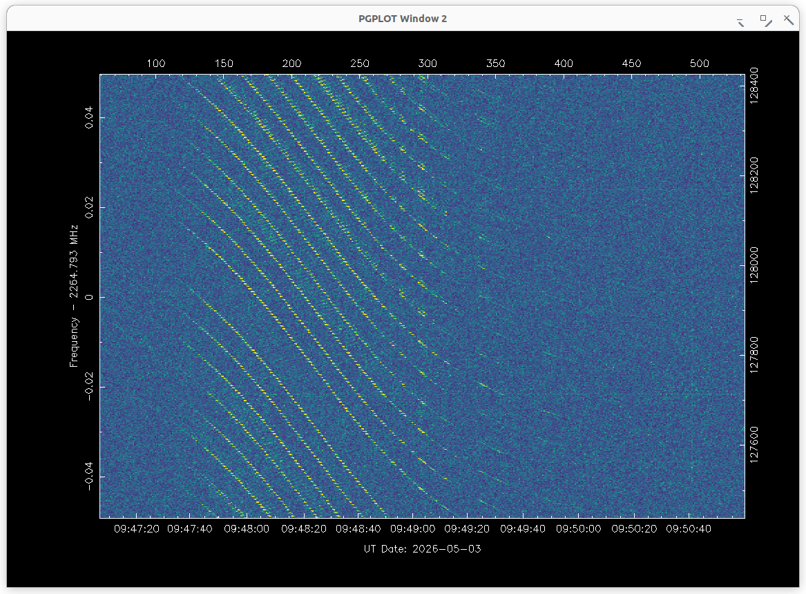

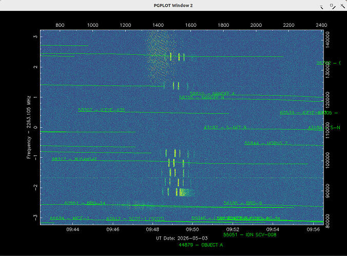

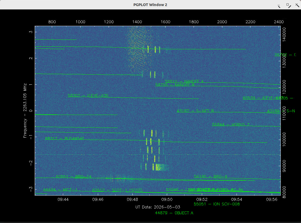

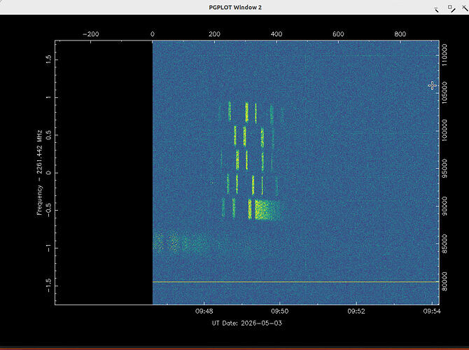

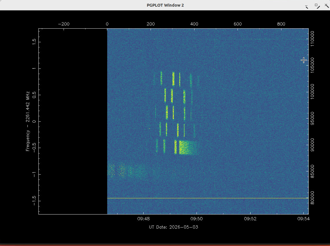

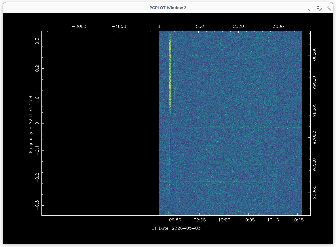

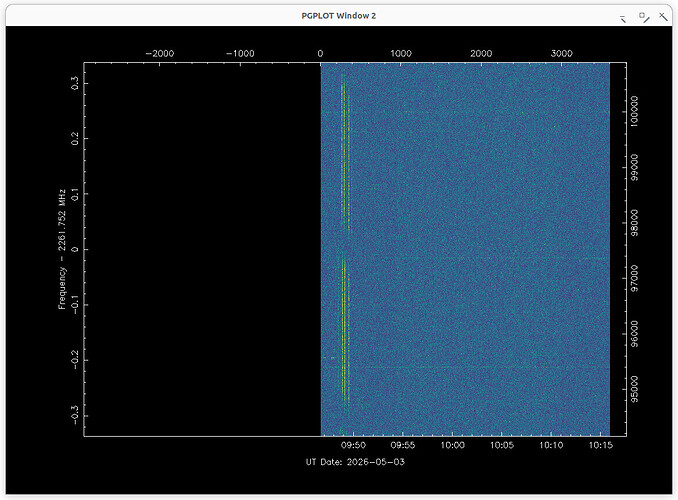

I did add this latest BUSANSAT TLE against my strf 09:48 UTC pass.
The TLE appears to fit, but the 2261.950 MHz is not the center of the 5 signals, Is it possible there are 5 separate satellites, and is it possible the signals on top 2264.3 and 2265.5 are also from BUSANSAT ?
