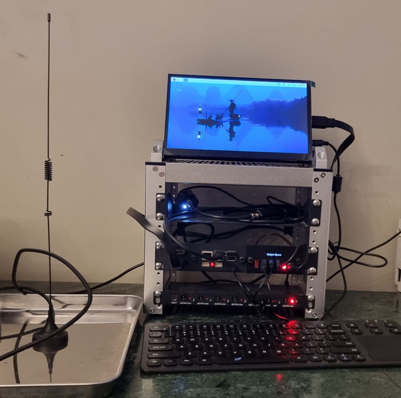

The final hardware build integrates dual PDUs to solve earlier power issues:
  • Antenna: Omnidirectional, mounted on the building roof.
  • Signal Chain: Antenna β†’ LNA β†’ NooElec SDR β†’ Raspberry Pi 5.
  • Power:
    • The original DeskPi PDU remains for 12 V and mixed loads.
    • The new 52Pi 5 V PDU exclusively powers the Raspberry Pi, LNA, and LCD screen.
    • Both the Pi and PDU are mounted using the DeskPi DP-0039 bracket for stability and modularity.
Assembly
First, assemble the DeskPi Rackmount following the included 14-page manual (6 steps). A YouTube guide is also available, though not necessary due to the straightforward assembly.
Next, install the DeskPi Rackmate 10-inch 1U Rack, designed for the Raspberry Pi 5. It provides a robust and efficient housing solution for both the EP-0249 PDU (52Pi 4-USB Channel PDU) and Raspberry Pi. Connect the 52Pi 4-USB Channel PDU to power the 5 V components, LCD screen, LNA and Pi.
For more information about the EP-0249 PDU, consult the wiki β€” it includes detailed information on the built-in Raspberry Pi Pico IΒ²C LCD display of the PDU.
Finally assemble the LCD Display and place it on top of the mount, wire everything together and your station should be up and running. If not checkout the trouble shooting page of the SatNOGS Wiki, https://wiki.satnogs.org/Troubleshooting.
This configuration isolates sensitive 5 V components, ensures stable operation, and leaves room for a future rotator upgrade without redesigning the power system.
