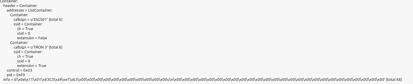

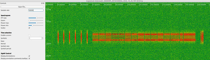

Hello everyone,
We are from Tron Future Tech Inc., Taiwan, the team behind the T.MicroSat series.
Following the launches of T.MicroSat-1 and T.MicroSat-2, our next two satellites, T.MicroSat-3 and T.MicroSat-4, are scheduled to launch aboard SpaceX’s Bandwagon-5 mission.
We would like to kindly ask for the community’s assistance in monitoring the UHF beacon signals from both satellites after deployment, particularly during the early stages of LEOP.
Below are some details that may be helpful for identifying our beacon signals:
  • Frequency: 401.025 MHz
  • Modulation: GFSK
  • Baud: 9600
  • AX.25 source addresses:
    • T.MicroSat-3: TRON 3
    • T.MicroSat-4: TRON 4
  • AX.25 destination address: ESGS01
Any reception reports, decoded beacon frames, or other observations would be greatly appreciated and would be very helpful to our team in confirming the satellites’ initial communication status.
Special thanks to @fredy for sharing the pre-launch TLE data. We sincerely appreciate the community’s support and look forward to any observations you may be able to share.
Best regards,
Tron Future Tech Team

T.MicroSat-3 and 4 are both alive. Just received over North Texas, EM12. Tron 4 signals appear stronger than Tron 3). 20261020_T12-40-05Z. Tron 4 playing Ode to Joy melody transposed into the key of G. Tron 3 also playing the music, albeit much weaker signal for this pass.
Frames uploaded to @satnogs. Congratulations to the teams!!

Confirming also from Network observations that both T.MicroSats are alive, also the TLE for now looks pretty good. Will check tomorrow for any update.

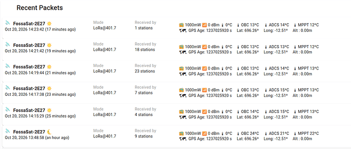

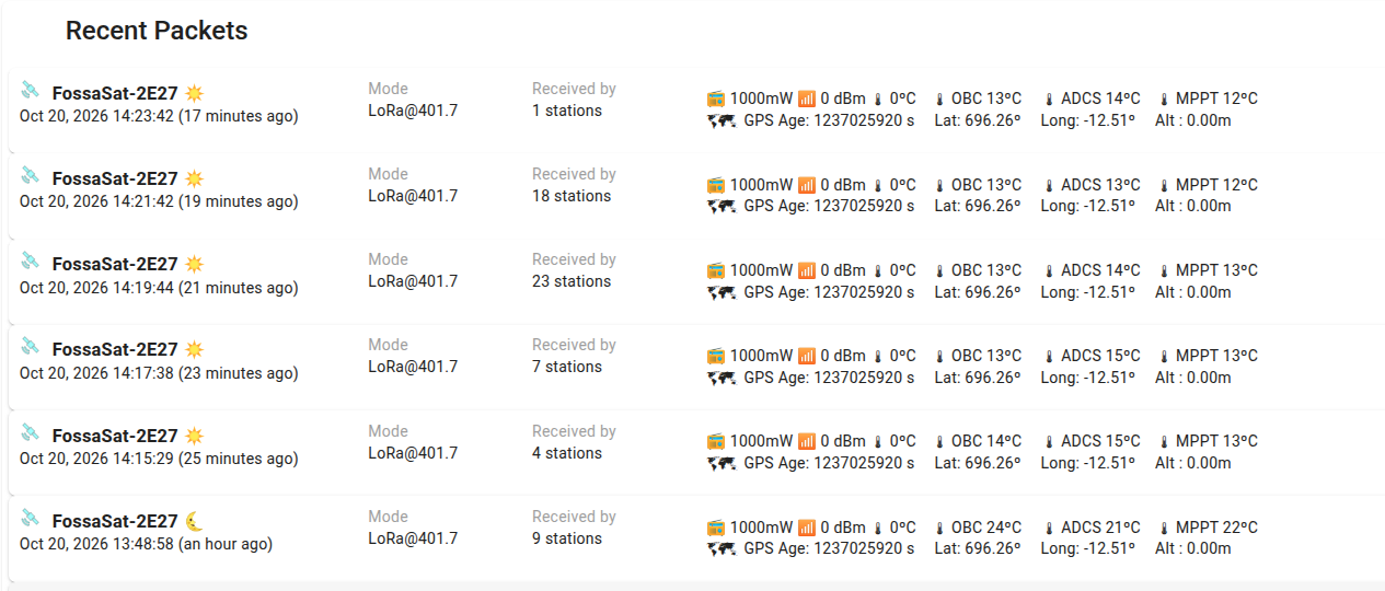

tinyGS also showing good packets from FossaSat-2E27!

T.microsat-3 over KO95
Ode of Joy - two times in a row)
