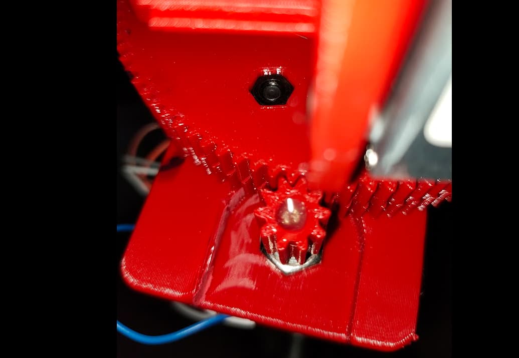

One of the settings in the original (unmodified) arduino code set the max azimuth at 450 degrees.
I have a large gear with 100 teeth , and the potmeter gear has 10 teeth. So, one turn of the large gear (AZ) , 360 degrees, makes the potmeter rotate 10 turns. There is no space in my brain to make this setup work for 450 degrees, unless I set minimum AZ to 90 degrees which, I think, absolutely makes no sense.

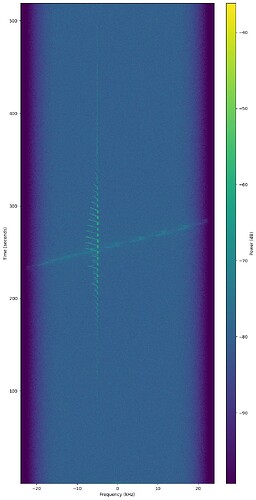

This all because the direct rotor control from station 3442 by USB connection to the Arduino Nano gave intermittent signals in the waterfall, with the antenna still being fixed and outdoor.

Finished cable wiring for the mount on the TV stand, testing dry run, controlled by station 3442 but that station still connected to it’s fixed outdoor antenna.
Strange things noticed: Timed out messages on rotor control and strange results in the received signals.
Timed out messages appear to have disappeared after changing the ROTCTLD model to 601 (GS-232A) instead of 602 (GS-232)
Now changed the rotor setting in satnogs-setup to 1 degree instead of 4 degrees to check if that has positive results for the waterfall / received signal.
Step bij step… Recognized with help from Satnogs enthousiasts that this is caused by the doppler correction running behind. Which is caused by this rotor interface software not sending back the AZ and EL to the rotctl Pi after which the request times out and the doppler correction can continue (timeout is about 2 seconds)

So, after running and rotating for several hours it ended in an error condition. After leaving it unattended and returning to the shack (radio amateur name for the Main Equipment Room) I noticed scheduled obs where finished. Climbing to the attic revealed a motor noise, which I stopped by pressing one of the manual movement buttons (those are guided by diodes to one pin of the Arduino Nano making it stop excecuting movement commands)
Cables where to short, it somehow over rotated. AZ was at 5 degrees, which looked close enough, but manually rotating either left or right did not change AZ value on display. Rotated backwards 360 degrees to release the cables, no AZ display change. Those gears are not really tight connected to the potmeters, making it not break them if rotation is out of mechanical limits.
Took a look outside (motor was still outside the top roof window) to notice there was no gear on the AZ potmeter. I found that one back on the floor of the attic, completely in good condition.
So, now I assume with the rotating / vibrating the gear just came off from the potmeter / multiturn.
I was still in the decision moment for either locktite or superglue to mechanically lock the gear to the potmeter, so now I decided to make the hole in the top of the gear also 5 mm diameter and add hotglue to that hole to fix the potmeter and gear together without making it 100 percent permanent.
