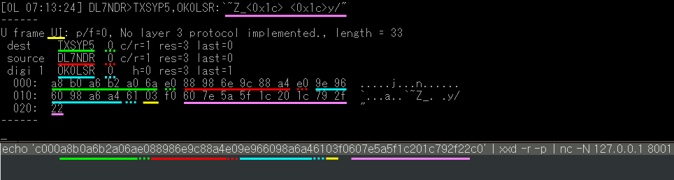

To generate a valid AX.25 frame, please refer to the AX.25 protocol specification.
For example, to send an APRS (UI) packet via LASARsat (OK0LSR) holding my Mic-E-encoded position, I use the following command.
The c000 at the start and c0 at the end is the KISS framing, necessary for the modem you are talking in KISS to (for example Direwolf).
The 03 (yellow) says send it as an UI frame beacon.
Direwolf also allows messing with the protocol, return messages like this, but sends them out anyway.
Station address, in position 0, is empty! This is not a valid AX.25 frame.
Destination Address “” is empty.
*** The origin and journey of this packet should receive some scrutiny. ***
Hi, I’ve been wanting to experiment with satellite packet stuff, and I’ve just tried to make my own mic-e frame following the APRS/AX.25 spec. However, I noticed at the end of your frame you have the three bytes 79 2f 22. I can’t find what their purpose could be. The speed/course section seems to be optionally followed by either some telmetry or a status message, but these bytes don’t seem to be one of those.

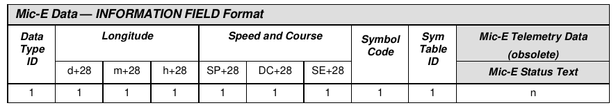

Hi Leo,
According to
(APRS Protocol Reference 1.2c, page 46)
the three bytes (79 2f 22) at the end are the symbol code, symbol table ID and the Mic-E status text.
y/ (79 2f) means Yagi @ QTH.
However, I don’t remember why I chose 0x22 for the Mic-E status text.
There is no meaning. Perhaps it was just decoded correctly by Direwolf.
Thank you for the response.
I don’t know how I missed the symbol bytes. I’ve added them to my mic-e frame now.
