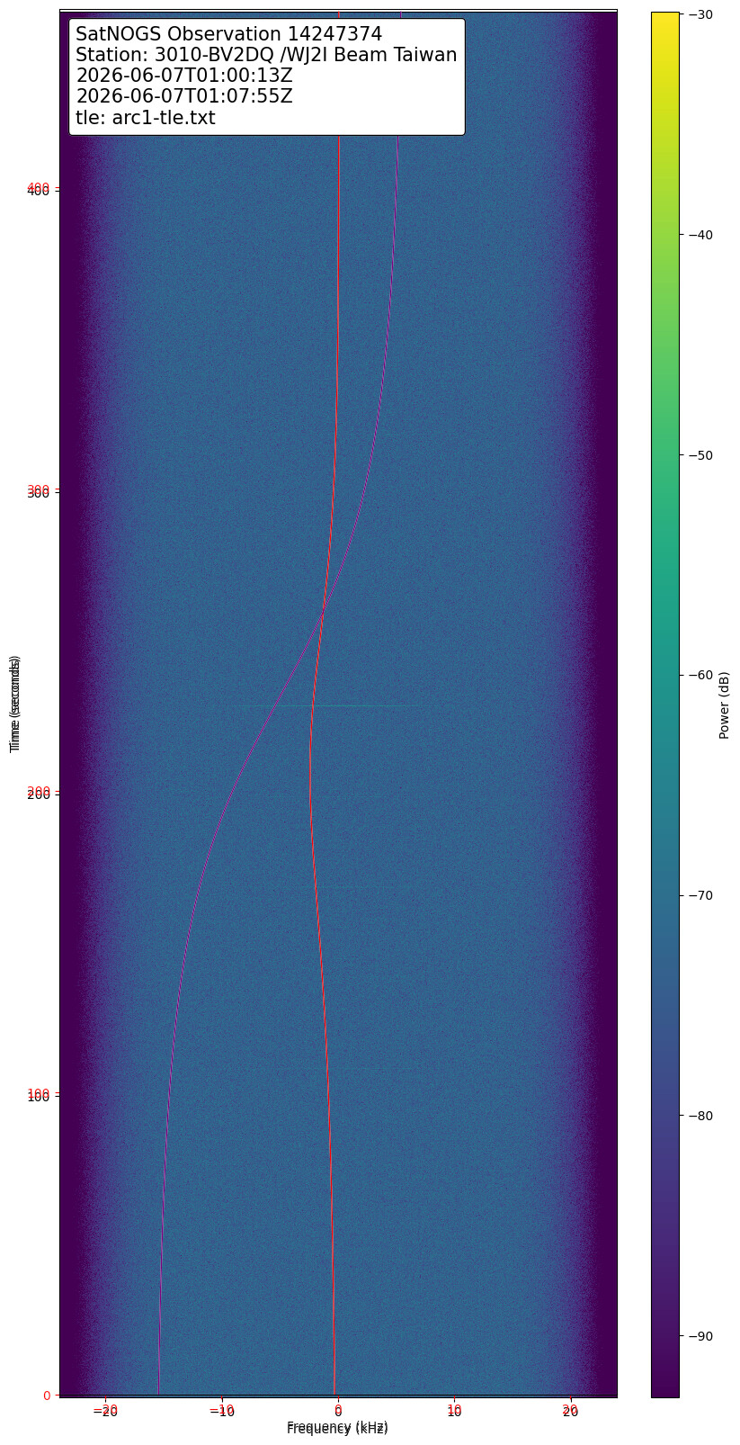

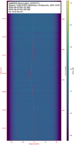

from this obs
drop drop drop…
ARCTICSAT-1
1 61762U 24199AD  26158.03458560  .00000000  00000-0  12270-2 0    07
2 61762  97.2851  42.3435 0006188 198.3612 131.9046 16.05687502    04

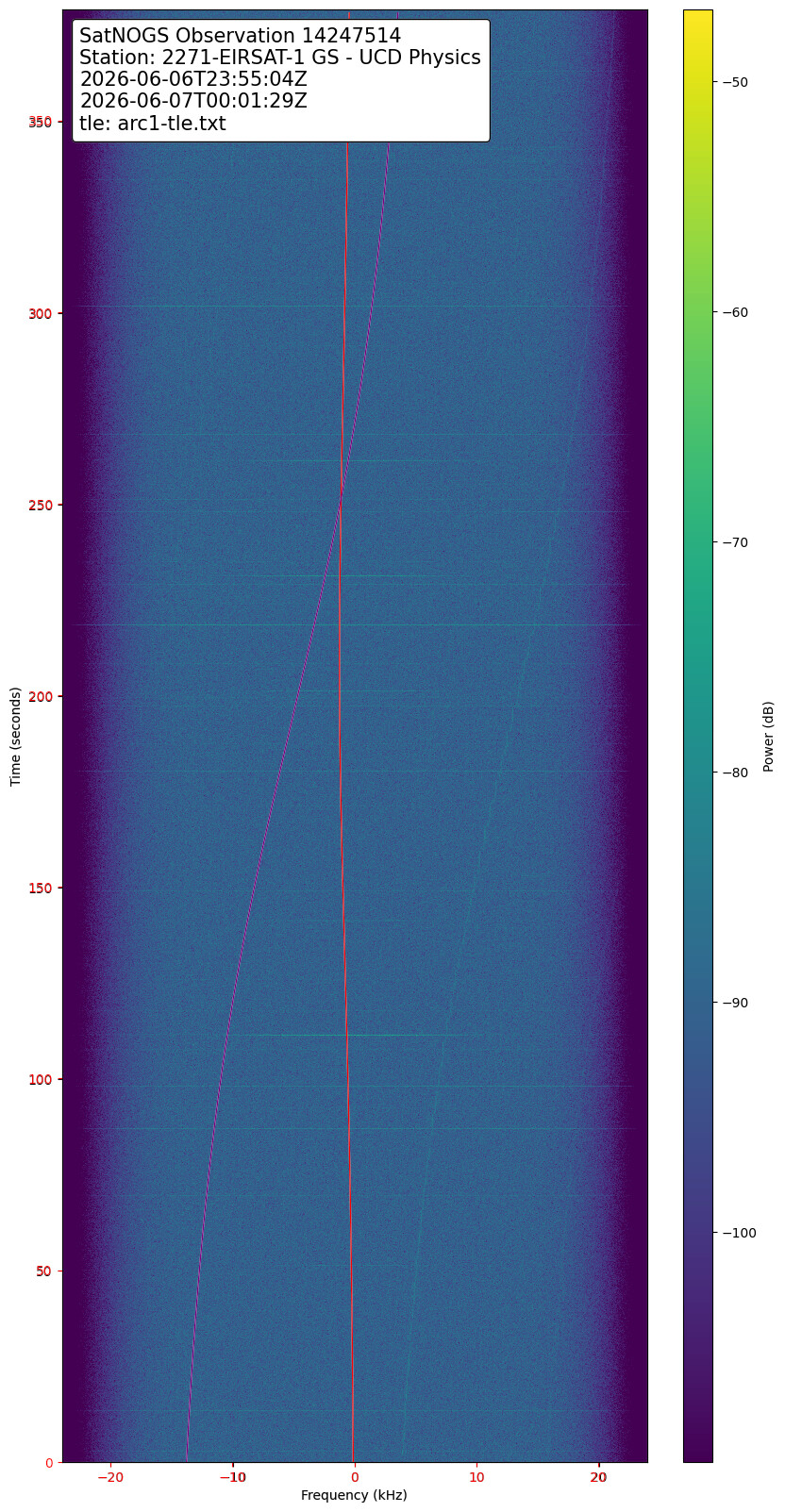

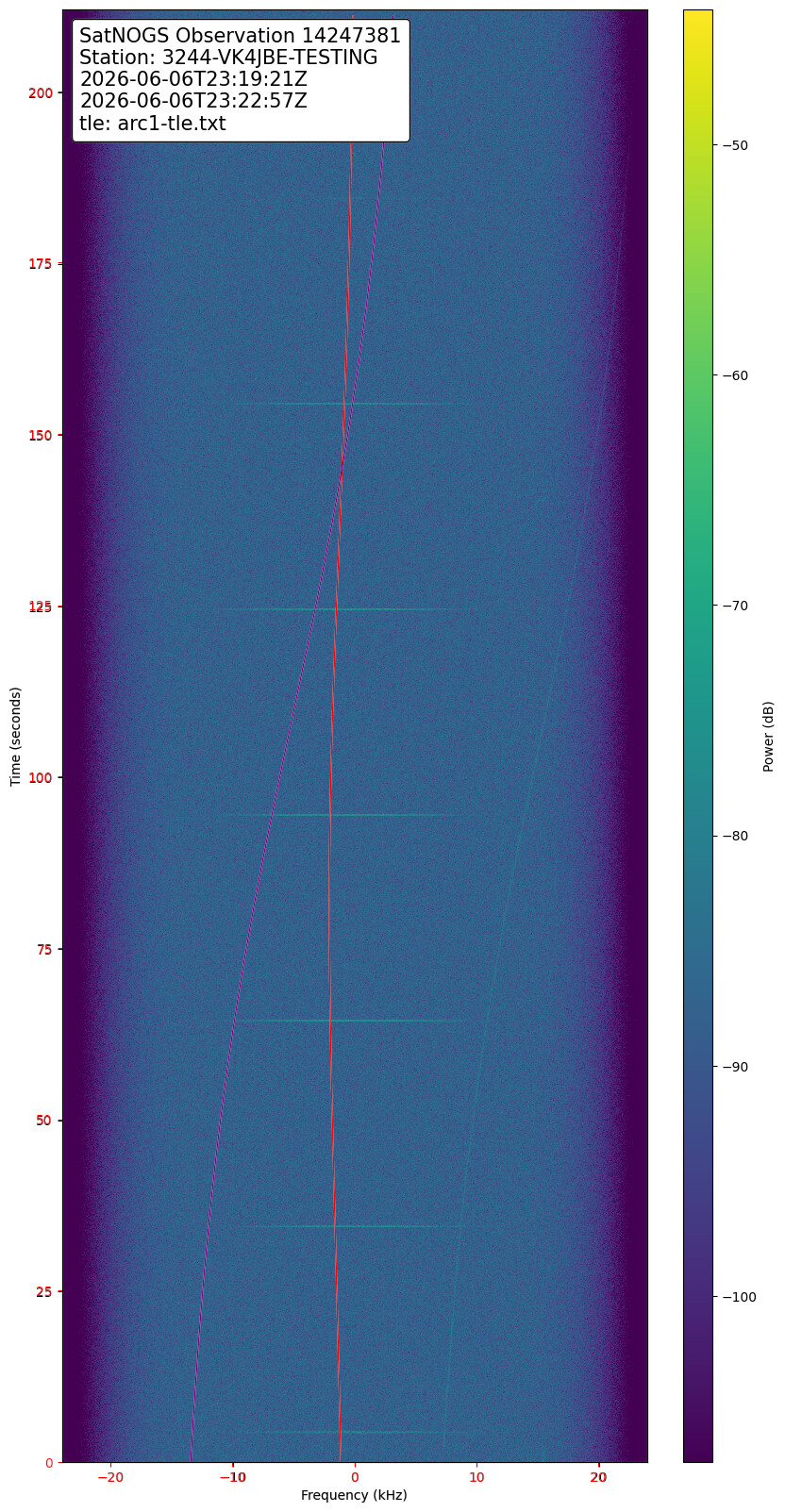

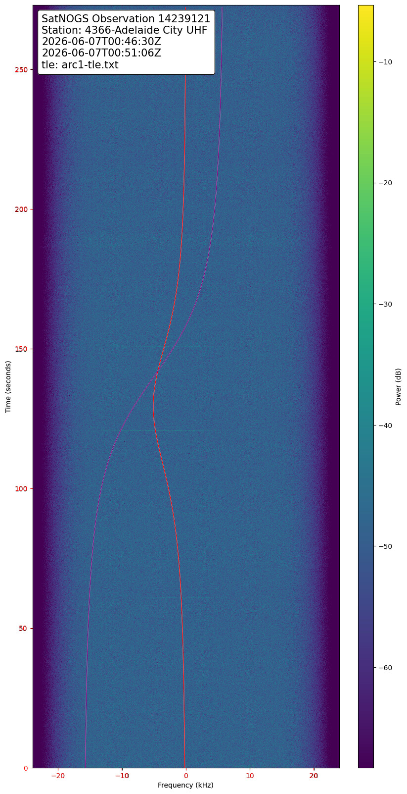

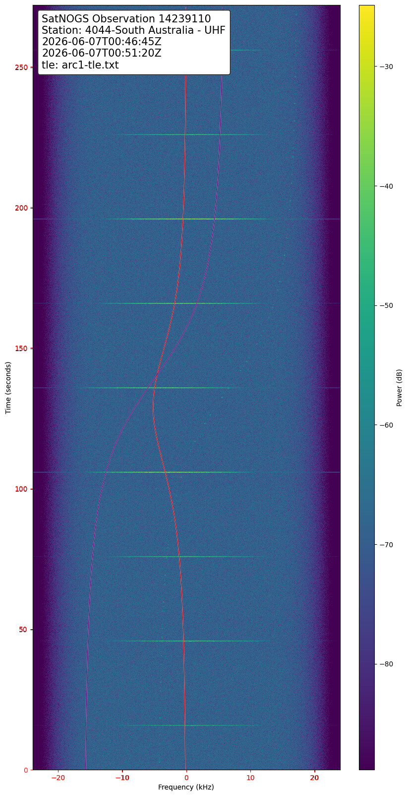

# 20260606.03-20260607.04, 18 measurements, 0.256 kHz rms
# 14239109_14239110.dat (total: 2 obs) (duration: 24 hours) (magic key: 256sfefef)
# generated using: https://github.com/hobisatelit/satno2tle (v0.03)

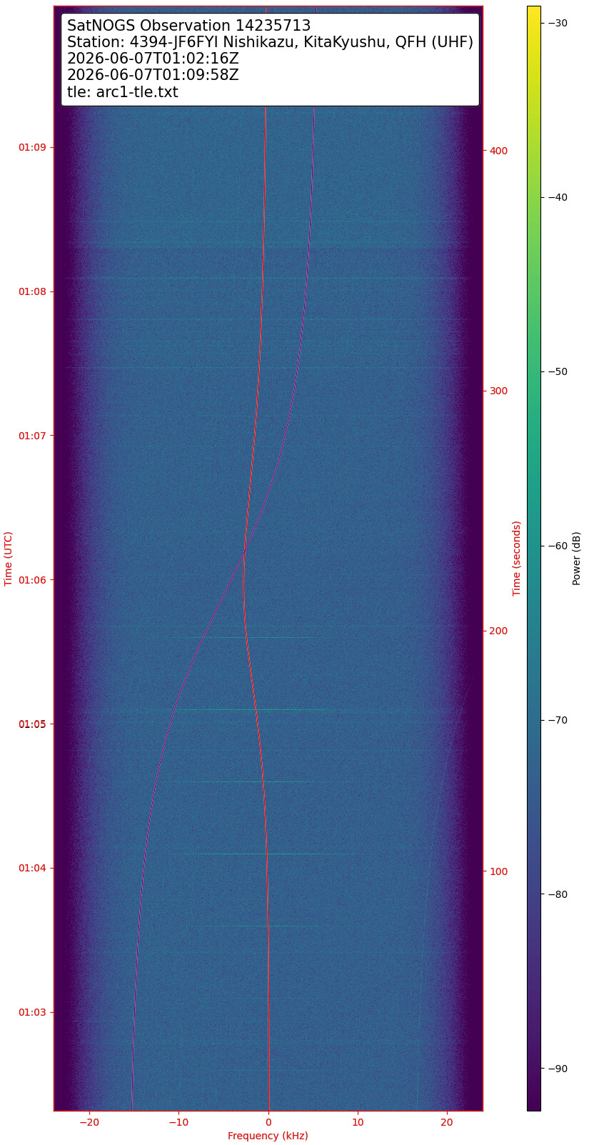

compare with June 5, drop around 1 km (based on gpredict)

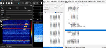

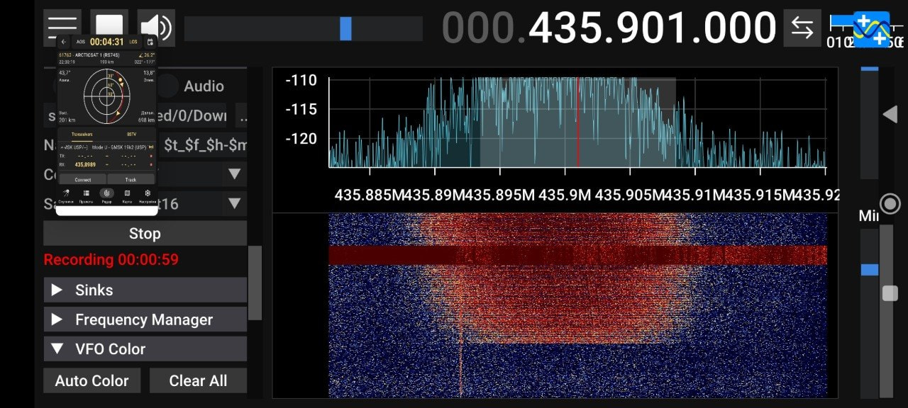

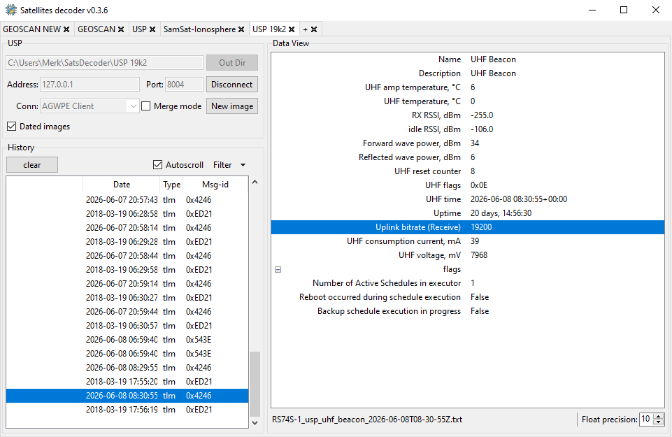

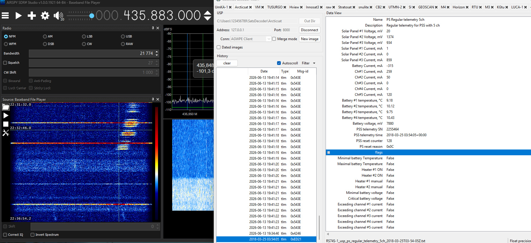

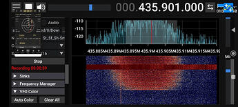

2026-06-08 08:30 UTC. Telemetry reception from the decaying :russia: :satellite:ArcticSat-1 (RS74S) on 435.890 MHz, in GMSK USP @ 19200 bd. Current altitude ~260 km. Decay prediction: June 14, according to https://sonik.space/decay/
Unfortunately, the operator announced that there will be no farewell SSTV broadcast :cry: Telegram: View @amateursat
current altitude around ~230 km

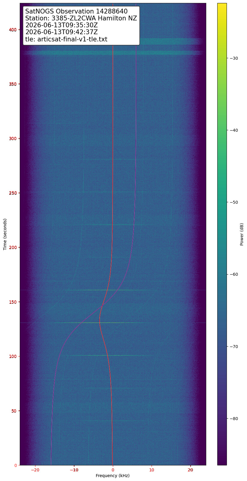

ArcticSat-1 is about to re-enter (few hours), let’s try to track it until its last orbits!
articsat-final-v1-tle.txt (384 Bytes)
ARCTICSAT-1
1 61762U 24199AD  26164.37295920  .00000000  00000-0  12507-2 0    03
2 61762  97.2825  48.7302 0009254 217.8157 195.2378 16.27093808    01
# 20260613.37-20260613.40, 29 measurements, 0.584 kHz rms
# 14288727_14288921_14288720_14288728_14288640.dat (total: 5 obs) (duration: 0 hours) (magic key: manual)

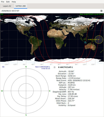

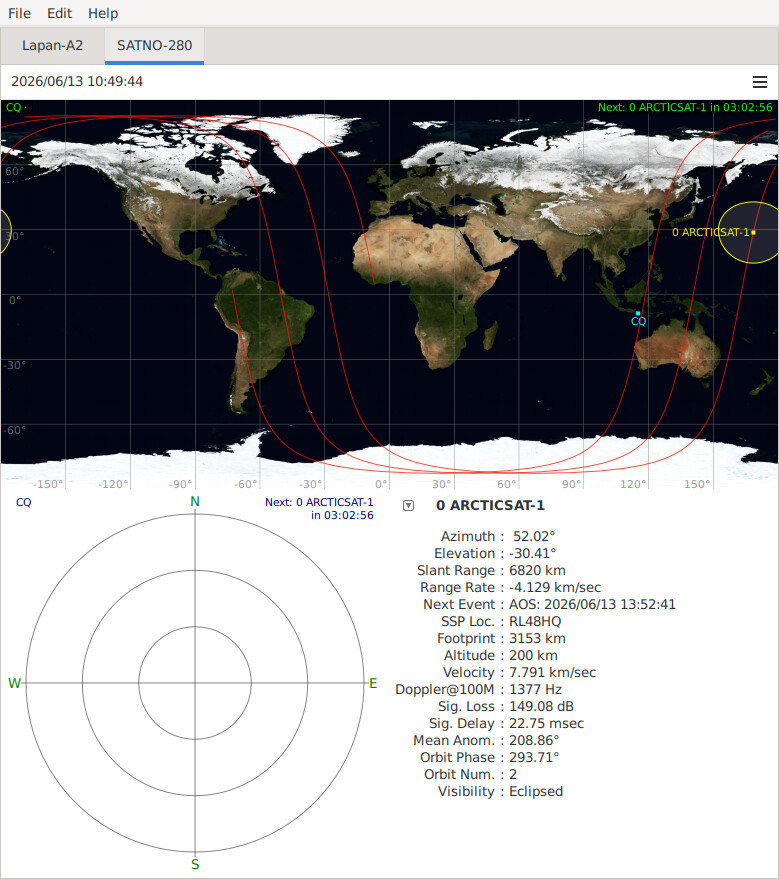

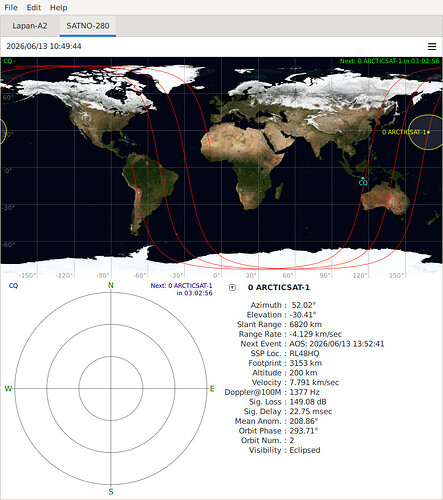

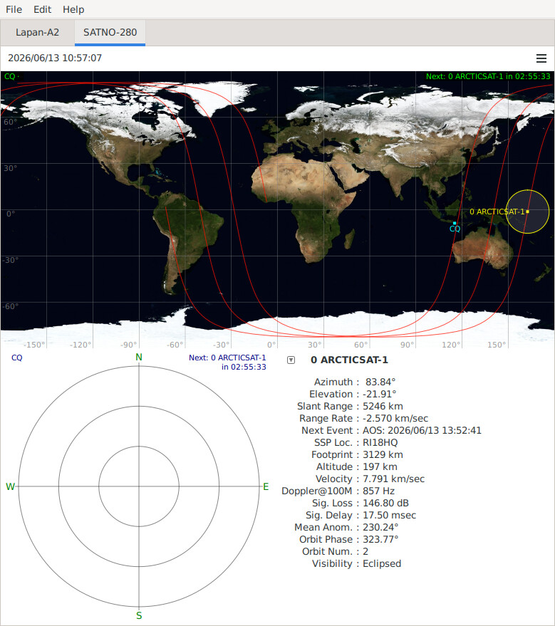

prediction base on gpredict and custom tle. the first under 200 km will start from east coast japan toward to australia
2026-06-13T10:49:44 (200 KM) — 2026-06-13T10:57:00 (197 KM)

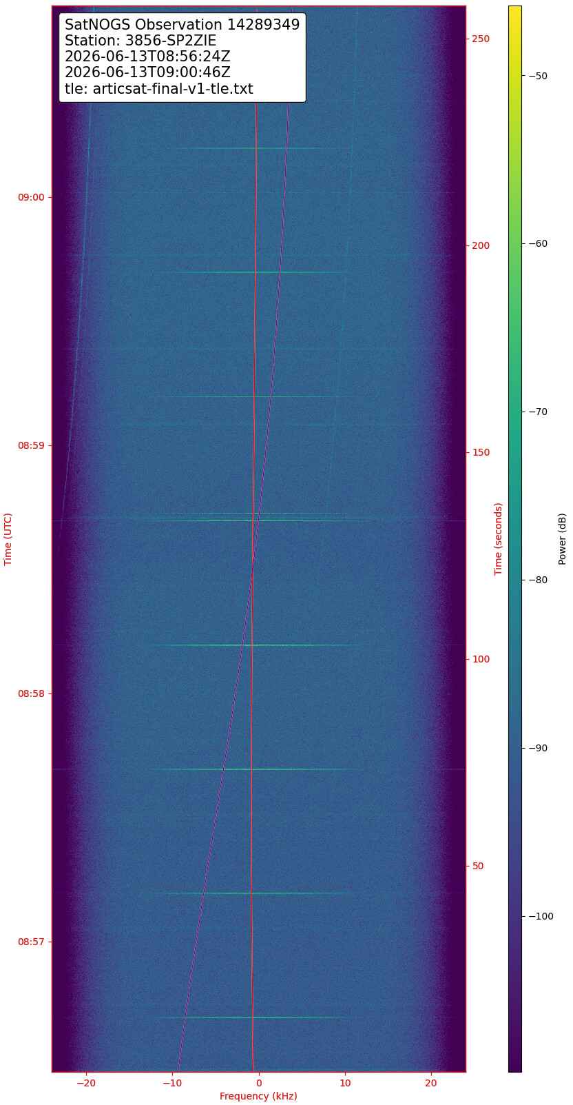

One update on TLE after the latest passes:
ArcticSat-1
1 61762U 24199AD  26164.58064222  .00000000  00000-0  12978-2 0    07
2 61762  97.2825  48.8534 0009254 217.8157 332.5632 16.30601223    08
arcticsat_164_v1.dat (1.6 KB)
sites.txt (13.5 KB)

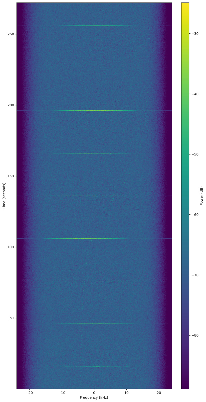

One more update, not very good accuracy as it is difficult to extract points from the waterfalls but I think it is close enough:

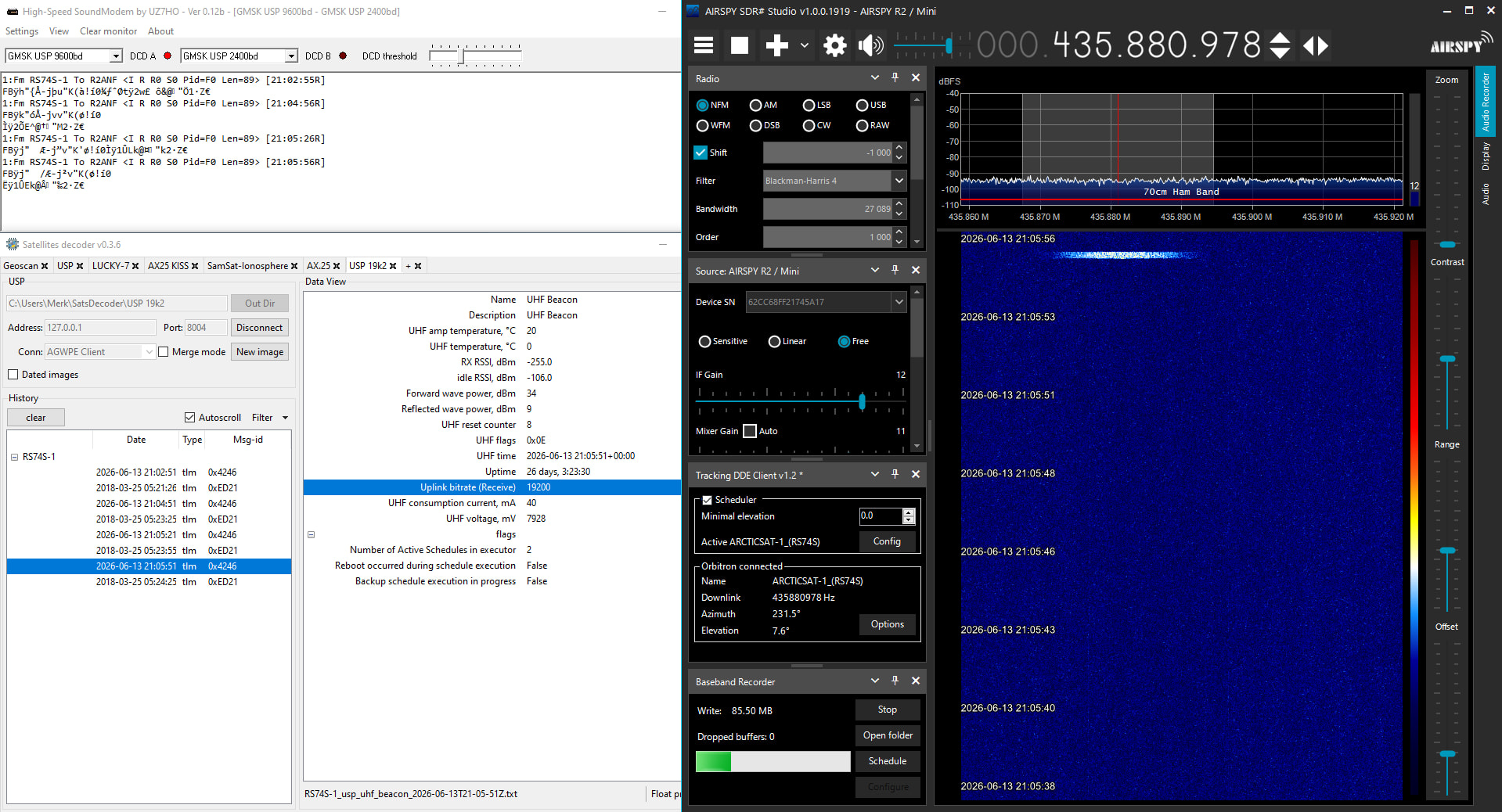

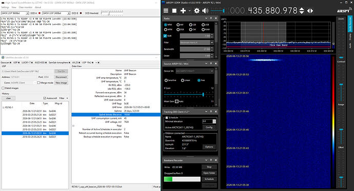

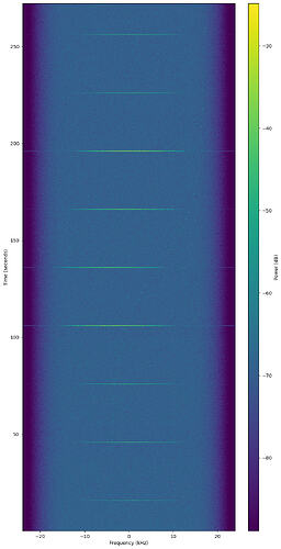

One (last?) decode from ArcticSat-1. Waterfall looks interesting at 197km.
Stefan/Oe6ISP
2026-06-13 21:05 UTC. Probably my last reception from ArcticSat-1
