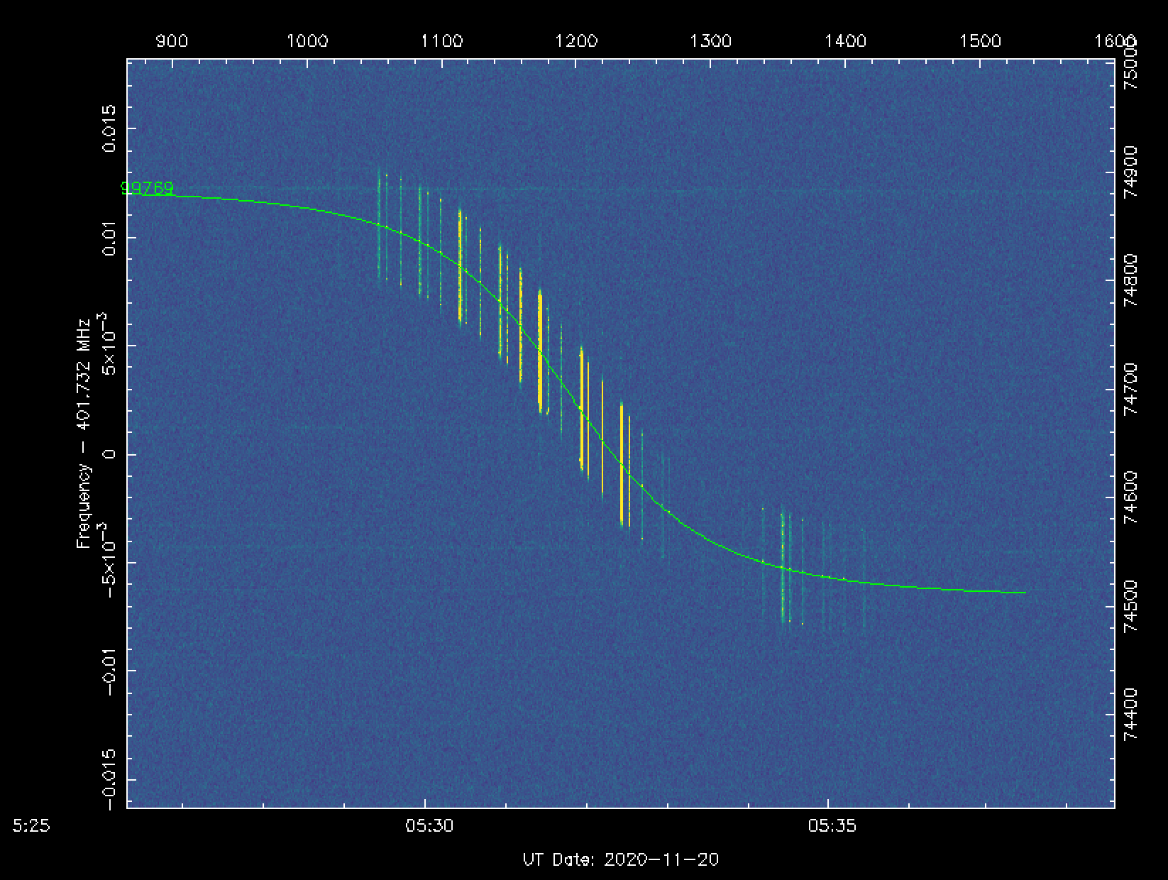

After some adjustments and based on an object at around 400MHz that seems to be from this deployment we have made a small fix to our previous generated TLE set:
1 99769U          20325.13194444  .00000000  00000-0  50000-4 0    04
2 99769  97.3700  99.8400 0000726   0.0000  35.2405 15.20445498    04
Special thanks to @cgbsat and @vk5qi. Here is a related tweet:

  3. We have added an unknown satellite from this deployment in DB that transmits at 401.735MHz and it seems to fit OBJECT W(46949), so for now we follow this NORAD ID for this satellite in DB.
