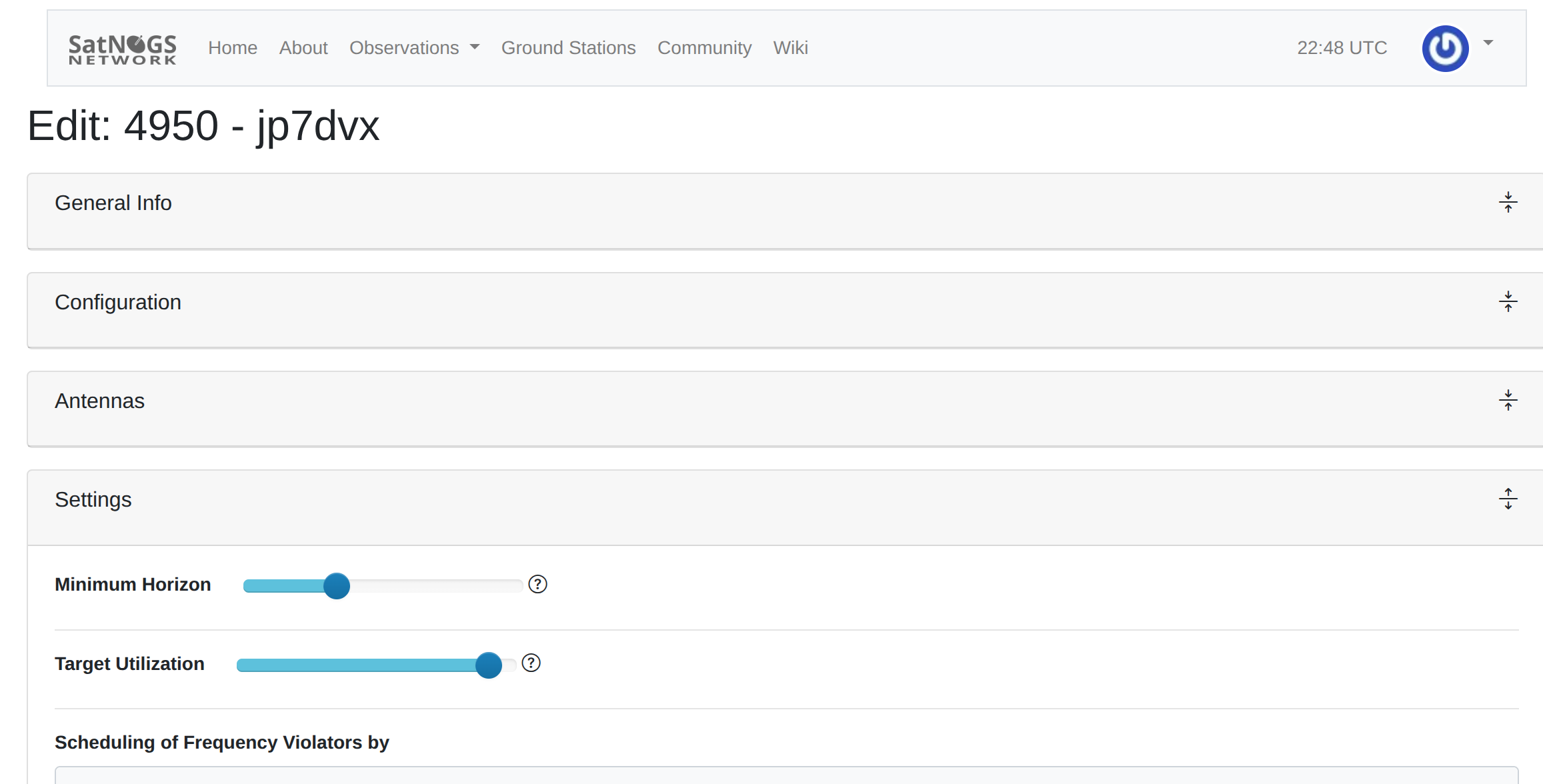

Please excuse me, I’m still a newcomer here and not entirely sure how everything works…
While looking at my station settings, I found this “Target Utilization” slider (as shown in the screenshot below).
Does lowering this percentage help limit or control how heavily the network schedules my station? Or is this related to what was discussed earlier about managing station workload?
Any advice would be greatly appreciated!
Currently this is just an indicator and it isn’t used for limiting the workload. This value will be used when auto-scheduling is implemented.
Mystery solved! So the “time machine” feature was already hiding in my settings panel waiting for the future. :grinning_face_with_smiling_eyes:
Thanks for the clarification, fredy! Looking forward to when that future arrives.
