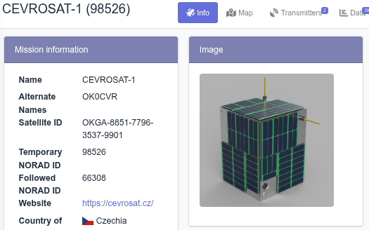

Welcome Olaf,
Before Satellites are launched, the final orbit and the id that belongs to it are unknown.
Therefor we use a temporary id, these are selected by @fredy, a SatNOGS core member.
Then once when the orbit is determined by Space-Track and with the help of the SSA proces it will be changed to its definite value.
During orbit determination,we have a period where changes can happen and therefor we also have the Followed NORAD ID. Below an example.
