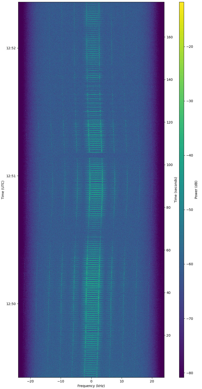

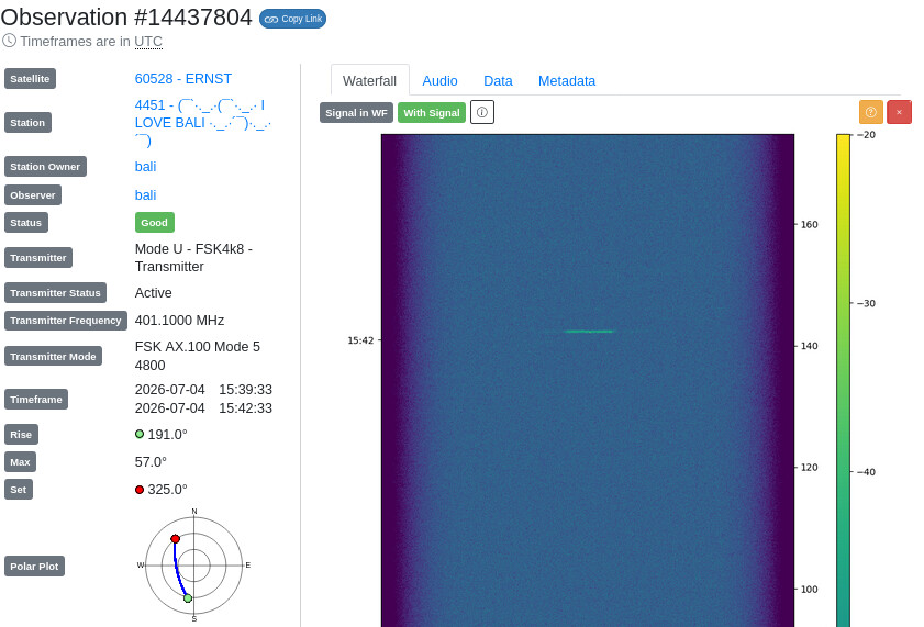

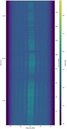

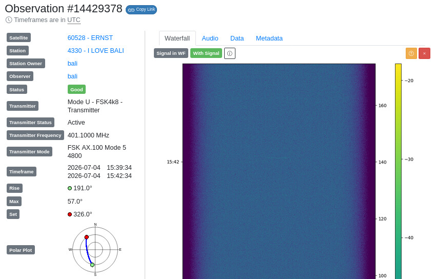

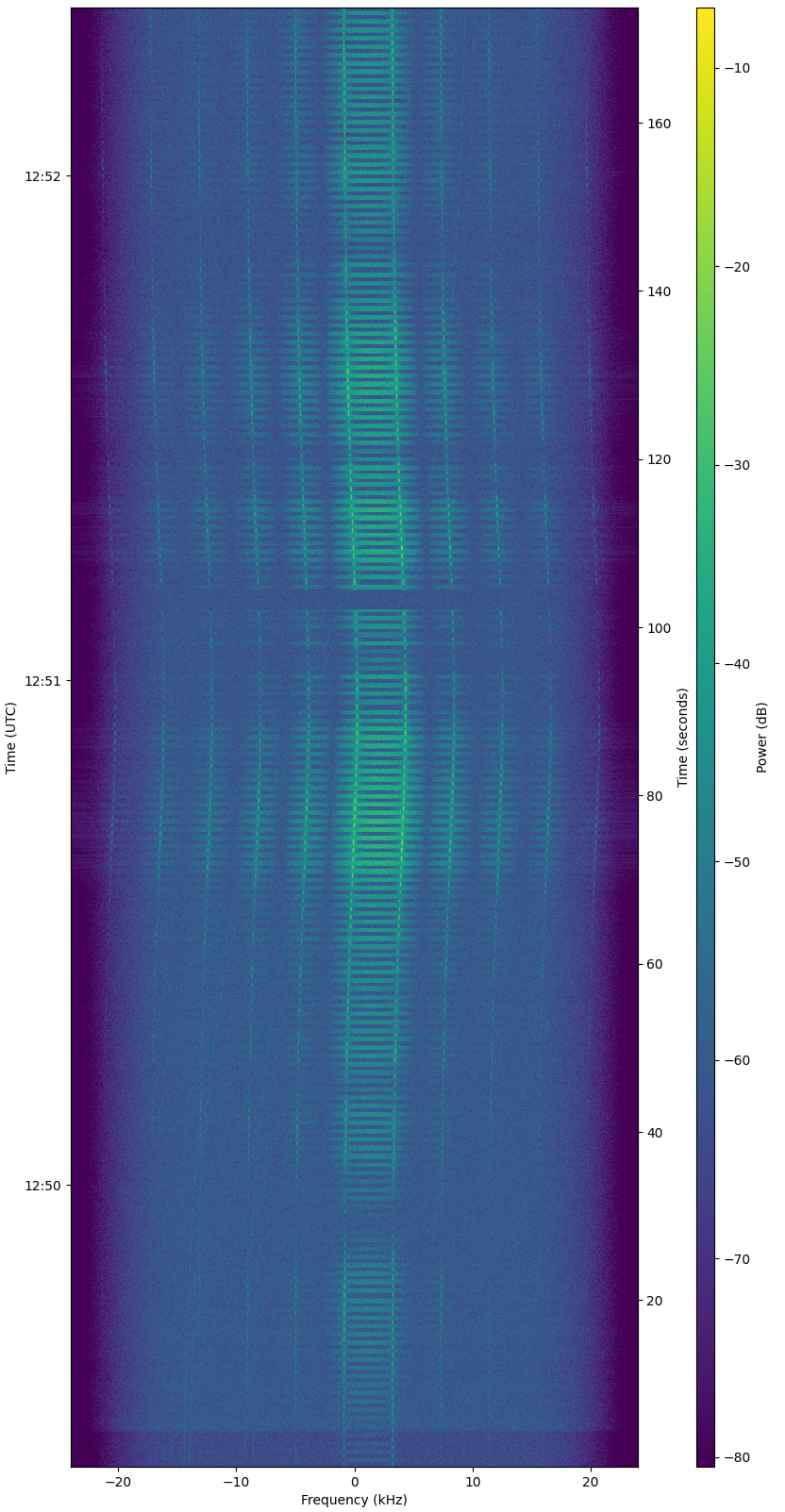

2m antenna vs 70cm antenna
left: 2m antenna
right: 70cm antenna
when receive 400 mhz signal from uhf sat
Thanks, Nice visual comparison of the 2. The 2m (VHF, 144–148 MHz) and 70cm (UHF, 420–450 MHz)… 2m antenna can often act as a 3/4-wave antenna on 70cm so for starting out use what you got and get those sats :eyes:
