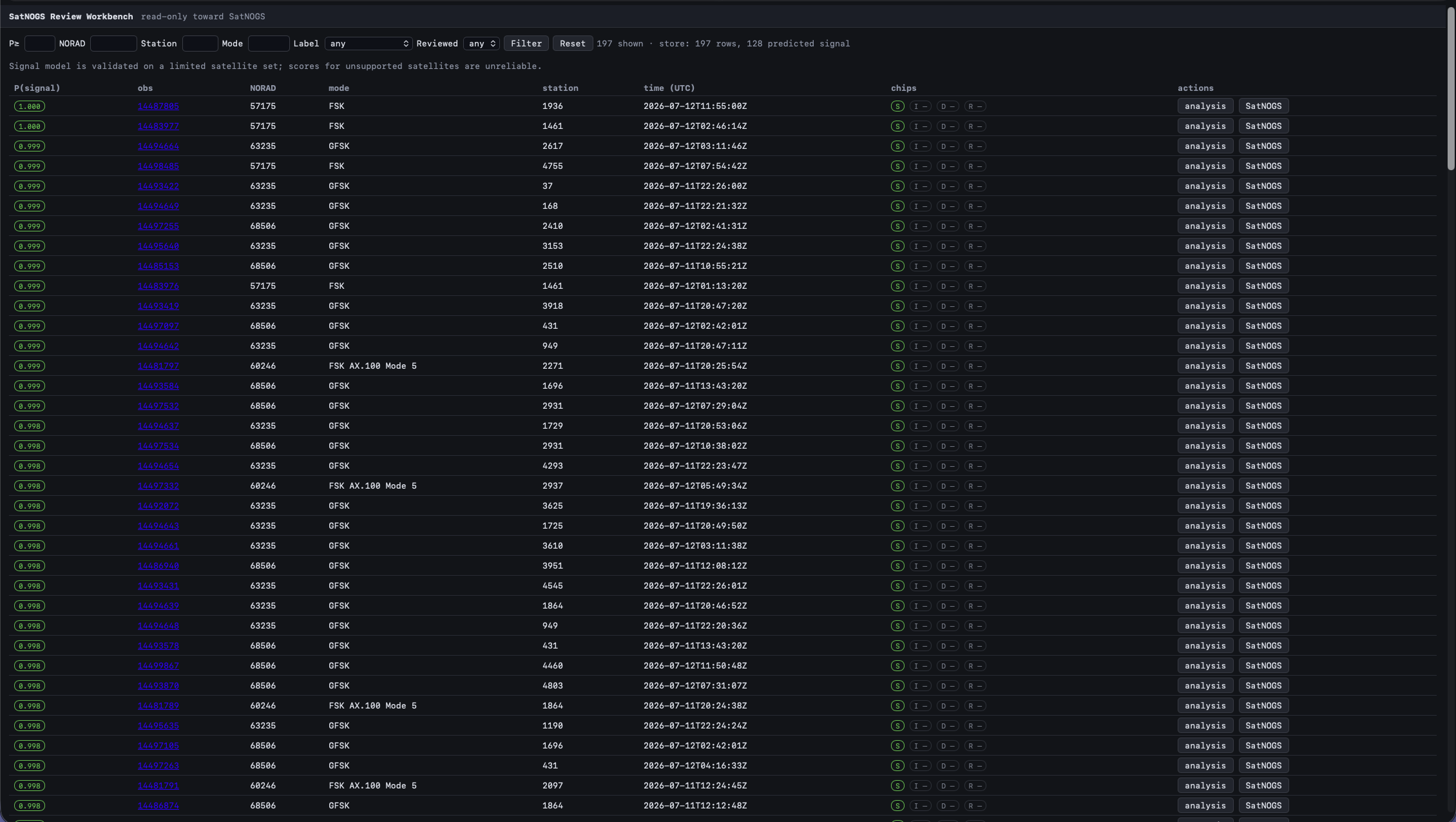

I’ve been building a self-hosted Observation Review Workbench for SatNOGS, and before I take it further I’d really value feedback from the people who actually run stations and review observations.
It’s a small, read-only web dashboard that pulls together three analysis engines so that reviewing an observation becomes: open it, read the evidence panels, decide. It only ever reads from SatNOGS — it never writes anything back to the network.
Note: this is an unofficial community project, not affiliated with the SatNOGS / Libre Space Foundation team. It’s early, so expect rough edges.
What it is
Four small pieces that run as four Docker containers:
  • satnogs-dashboard — the web app (on port 8000) that ties everything together and shows the review UI.
  • satnogs-signal — ML signal/noise triage; scores new observations and fills the review queue (about every 15 minutes).
  • satnogs-id — Doppler-based object identification; runs on demand.
  • satnogs-decoder — decoder validation and maintainer-review evidence; runs on demand.
How it works
  1. satnogs-signal continuously scores fresh observations into a review queue.
  2. You open one and hit Identify or Decode — the matching engine runs and its result is cached, so you only pay the cost once.
  3. You read the evidence panels (signal, identity, decode, related passes) and make the call.
That’s the whole loop. Nothing is written back to the network — it’s purely a review/triage aid.
