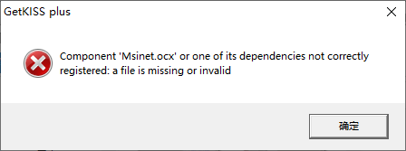

Followed your instructions. Installed VB6. Added .ocx files. The issue was with TLE format and had to place the TLE outside the C:/ drive. Used compatibility mode to run the .exe as admin.
Well, Whats happened?:smiling_face_with_tear:
Look THIS
