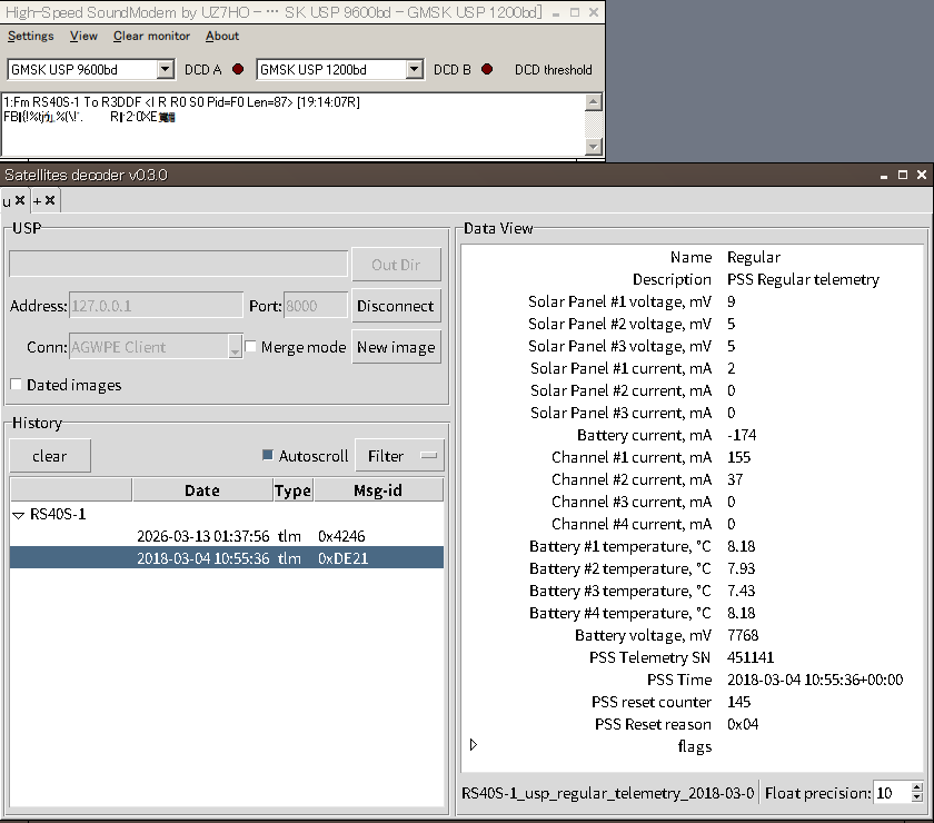

Sounds you are looking for something like this?
You’ll need a modem for USP and a telemetry decoder.
I already have this program, and it worked fine with the WAV sample PU4ELT kindly sent me. Thanks for your comment.
