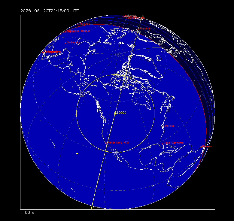

I looked at these parameters, and made a tle of it. Problem is it does not pass over the launch site around the mentioned epoch. I am not sure if I messed something up, or if there is another problem.
If I play a bit with the RAAN and Mean Anomaly to get the TLE to pass over the launch site 5 minutes (21:23) after launch at 21:18 UTC, then I get this:
1 99999U          25173.88750000  .00000000  00000-0  50000-4 0    03
2 99999  97.7490 286.0000 0008420  87.7550  38.5000 14.91986371    00
Please check if it makes sense before usage! :smiley:
Looks pretty good
