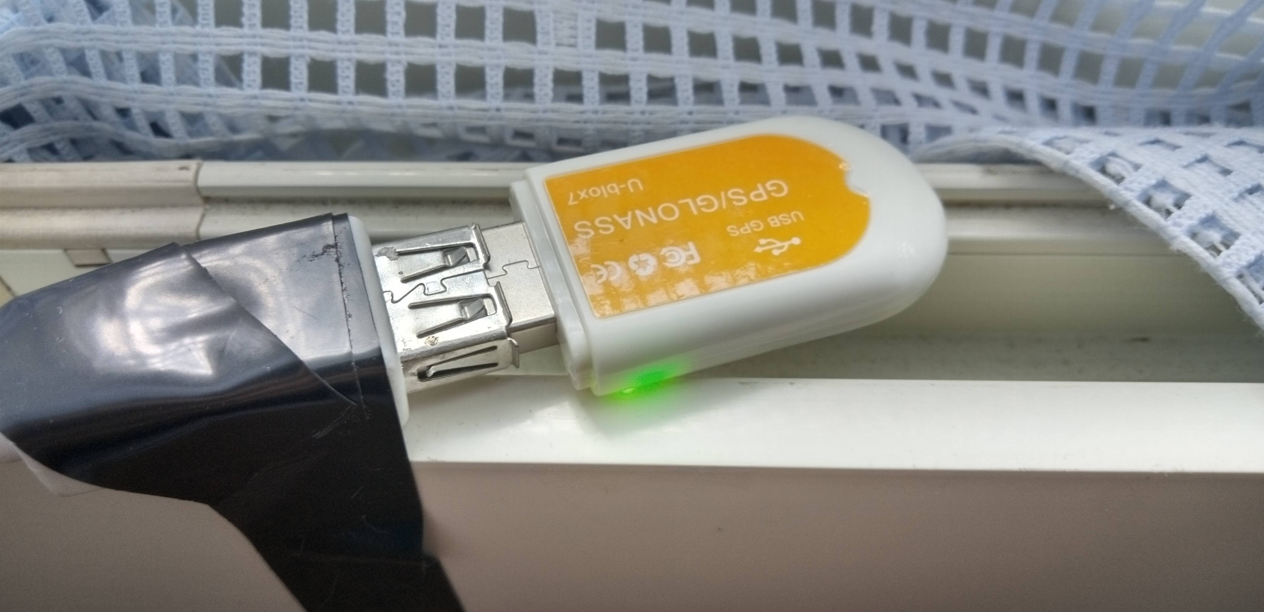

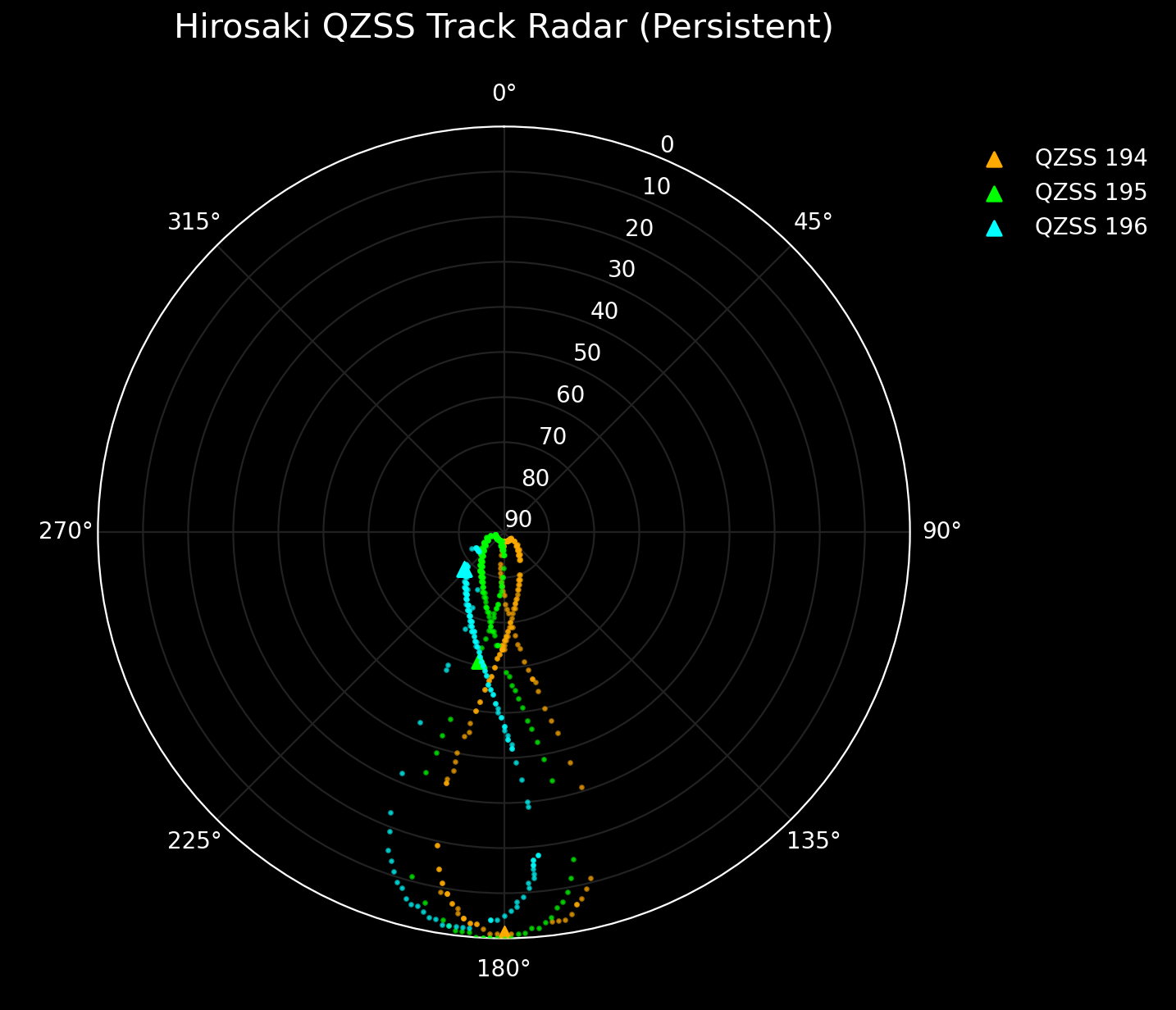

I wanted to share this beautiful “figure-eight” track of QZSS satellites I captured from my study window in Hirosaki.
It is truly impressive what a simple, inexpensive USB GPS module (costing less than 1,000 JPY) can achieve when set up properly. As shown in the attached image, I just placed it by my window, and it successfully tracked the precise orbits.
It’s always a joy to see such clean data from such modest equipment!
can you explain what is you post, as i’m noob?
btw the track remind me the gps / high orbit sat motion on sky over optical observations
Thanks for the comment, bali!

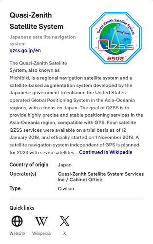

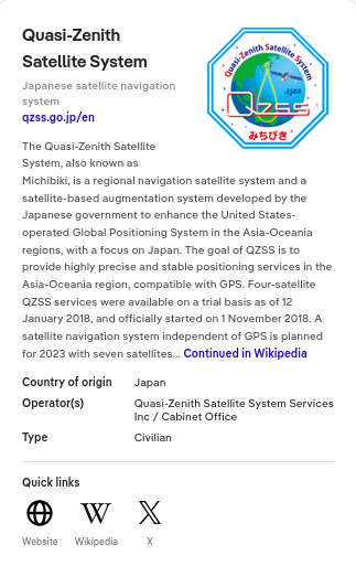

QZSS (Quasi-Zenith Satellite System), or “Michibiki,” is a Japanese satellite constellation designed to enhance GPS in the Asia-Oceania region.
The reason for this “figure-eight” pattern is that these satellites are in a specialized “high-inclination” orbit. They are designed to spend most of their time near the zenith (directly overhead) in Japan, which is why their ground track forms that distinct shape over time. It’s effectively a stationary-like performance despite the movement!

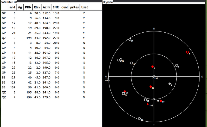

Also, I have attached a screenshot of the GPS module data currently running on the same Linux machine (LMDE 7) just for reference. It is working very smoothly.
In addition to the QZSS ‘figure-eight’ pattern, I’m getting great results with other constellations as well. Here is a screen recording of my Linux system tracking them all in real-time.
