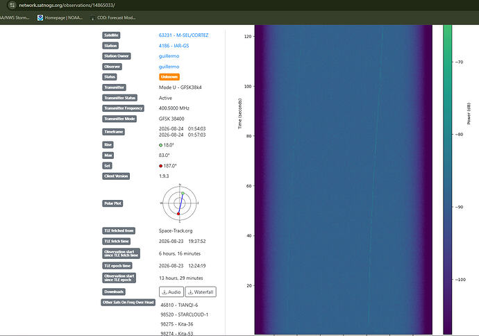

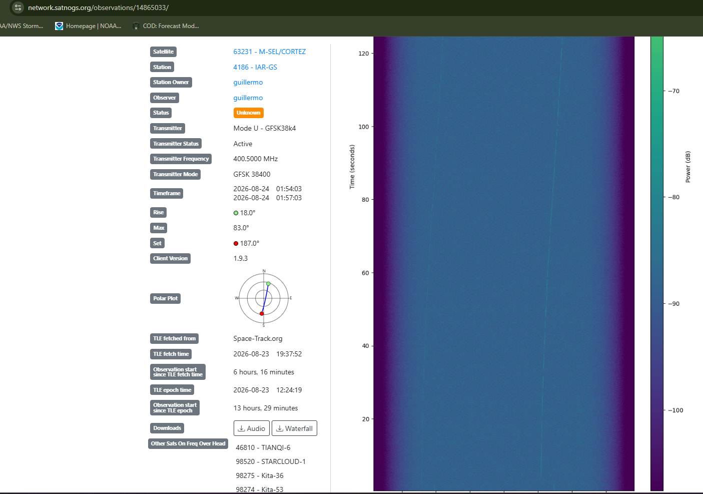

TamperMonkey Script for seeing others sats on Observations
I wrote a TamperMonkey script for adding a list of others sats over head on or neat an observations frequency to the bottom of observation pages.
It works using a new endpoint on my satnogs map server to let python handle the heavy lifting. Currently it just shows sats that are within 30Khz either side of the observation frequency using the current TLEs (I may add support for using old TLEs later)

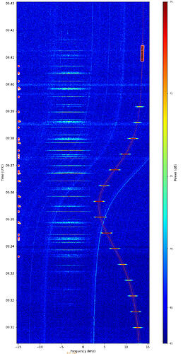

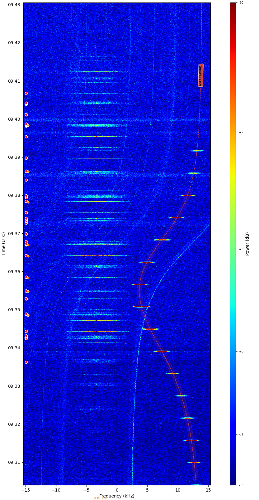

I have plans to expand it to generate ikhnos like waterfalls that display all the other satellites on the waterfall.
Here is an example.

Just a quick note, there is a plan to replace waterfall (image) with waterfall data (aka artifacts), so while the backend would remain the same, I wouldn’t spend a lot of time on the frontend part that uses the waterfall image, however I don’t say it wouldn’t be useful to have something like ikhnos written in javascript and plot directly on the observation page the other satellites.

Yeah I need to do a push for my Map to add it. But basically it has a copy of the transmittet list it downloads once an hour or so, that it searches thru to find the near by in freqency sats, (this would be just a basic DB querry if adding to the network) then I am propagating the satellites over the observation timeframe to generate if they are above the horizon for the station AND to get the range_rates for the waterfall stuff.
