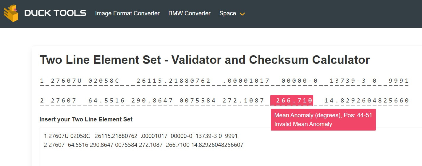

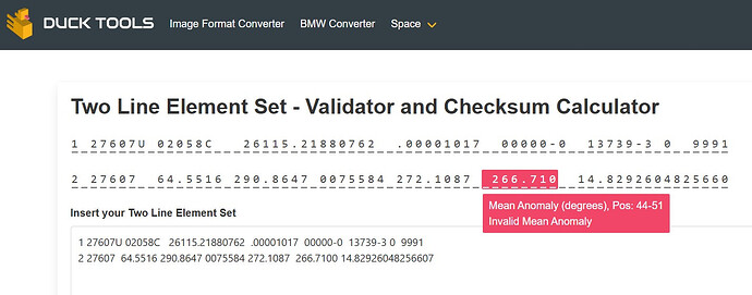

You can see the mean anomaly is very different from the reference (TLE from Celestrak) and when I checked on TLE validator, its showing error.
Is there any explanation for that or a step that I missed on strf? It only happened after I updated the epoch on strf but not when I didn’t update it. The Cubesat XI-IV also has similar issue but not with LAPAN-A2.

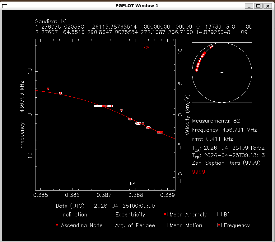

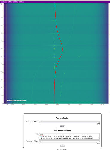

Oh I forgot, here’s a screenshot from the strf.

you should clean the dot, remove unnecesarry dot.

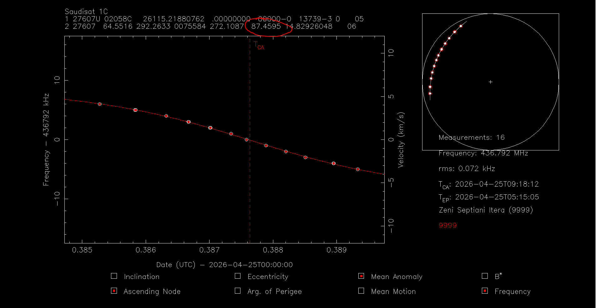

Thanks for the input, I have cleaned the dot
Here is after fitting the Ascending Node and Mean Anomaly without fitting the epoch at all:

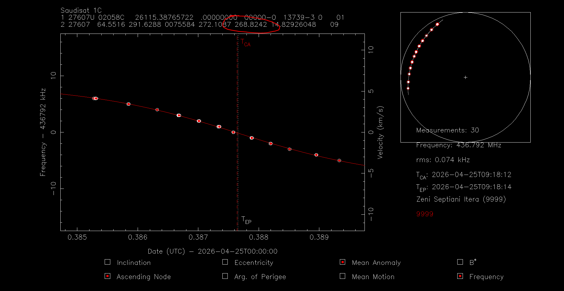

And here is after fitting the epoch, then the data (Ascending Node and Mean Anomaly):
You can see the Mean Anomaly value differs very much from the reference. If I fit the data first then the epoch, then the Ascending Node value will differ very much.
If I may, what is the correct step to fit the data, I may miss something as different step resulting with different value.
can you inform the max elevation of sat when obs?
if check from screenshot seen low elevation
i recommend you to use another obs that have higher elevation. for the best result i recommend above 45 degree. more higher more accurate
The mean anomaly represents the position of the satellite in the orbit at epoch. So if you change the epoch you should expect mean anomaly to change. Quick calculation:
  • your epochs are 26115.3876 - 26115.2188 = ~0.169d apart
  • with a mean motion of ~14.829 rev/day, that means (assuming a circular orbit) you have moved 14.829 * 0.169 * 360° = 902°
  • 87° + 902° = 989°
  • that wraps to 989° - 2 * 360° = 269°
So a mean anomaly of 266.71° is pretty close to what I would expect.
Regarding RAAN I can’t tell you why there is a difference. But I don’t think you can reliably fit RAAN with measurements from only a single pass.

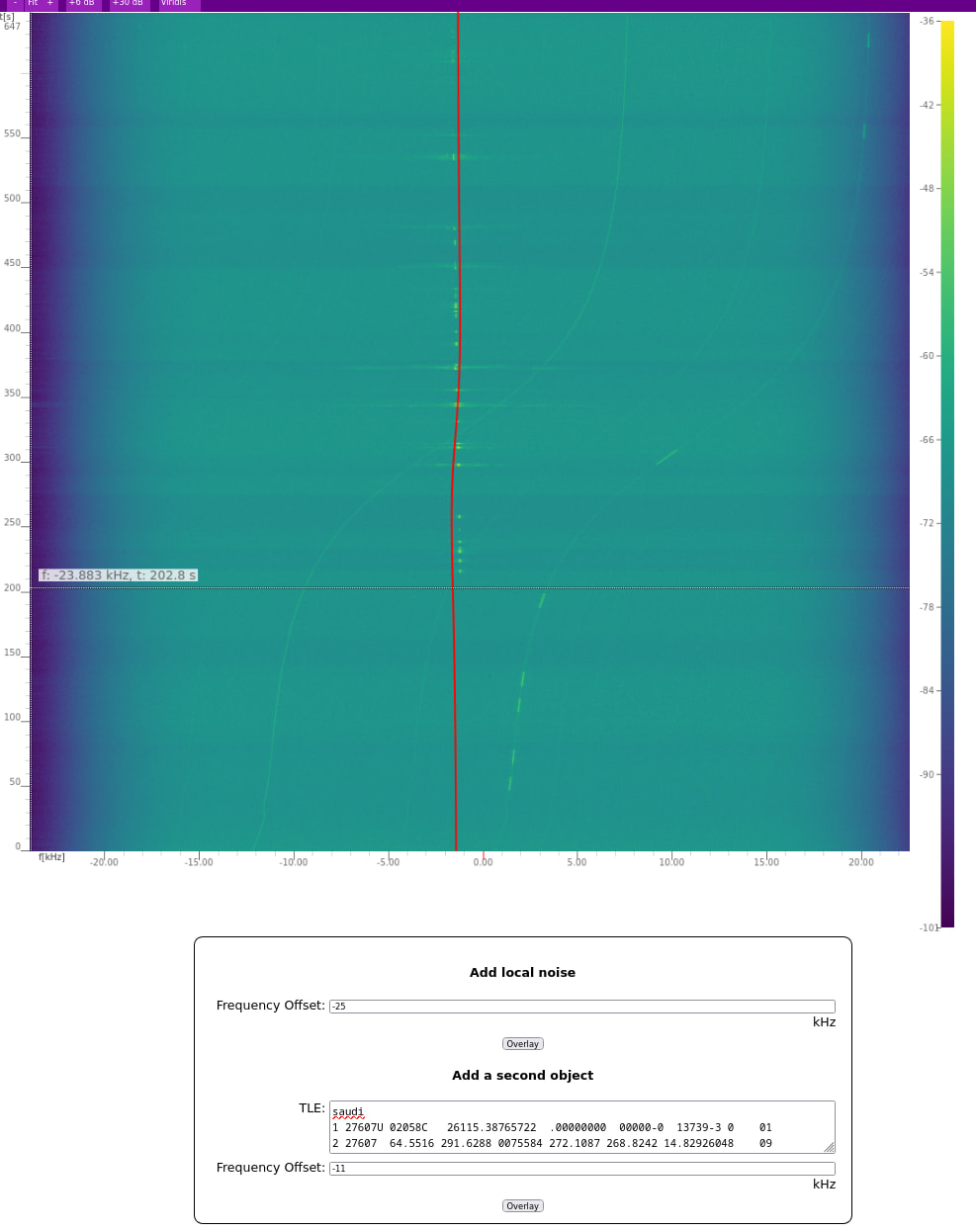

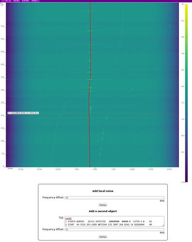

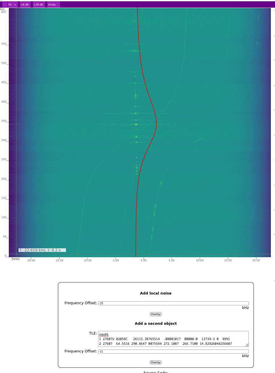

i test your tle on my observation around that date , and the result is better than before remove unnecessary dot
before:
1 27607U 02058C   26115.38765514  .00001017  00000-0  13739-3 0  9991
2 27607  64.5516 290.8647 0075584 272.1087  266.7100 14.82926048256607
after:
1 27607U 02058C   26115.38765722  .00000000  00000-0  13739-3 0    01
2 27607  64.5516 291.6288 0075584 272.1087 268.8242 14.82926048    09
so as @jazzpi post , the mean anomaly value is still ok, and not always close with the reference. mean anomaly between 0-360 degree is valid.
i use this tool
