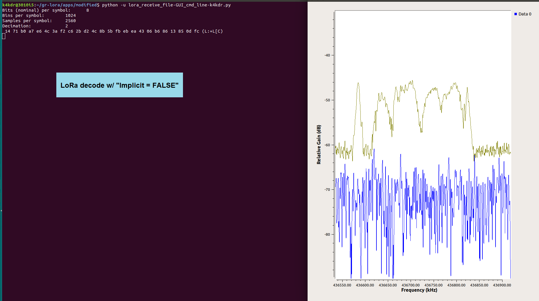

As a non-programmer, I will almost certainly embarrass myself with this, but here is the result of my first flailing attempt to decode the 250k LoRa from NORBI (even though we don’t know what all the settings are supposed to be) with alterations to the default scripts in gr-lora:

NORBI LoRa Update:
I have been able to assemble most of the LoRa settings used on NORBI from various sources including R4UAB (thanks!), which unfortunately indicate that my decoding efforts so far have not been accurate. But now I finally have a known format to shoot for, so will keep trying!
NORBI LoRa settings list: SF=10, BW=250, CR=4/5, parameter LowDataRateOptimize is activated, Explicit Header mode, CRC – on.
The “SYNCWORD” value on NORBI is 0x12
Packet format on successful decode:
8E – frame length in bytes
FF FF FF FF – broadcast address
0A 06 01 C9 – source address
0A F1 00 00 00 00 – block of specific information
F1 0F – header signature
00 00 D2 0B EE 9F 02 00 – block of specific information
42 52 4B 20 4D 57 20 56 45 52 3A 30 32 5F 31 32 – ASCII string “BRK MW VER:02_12”
