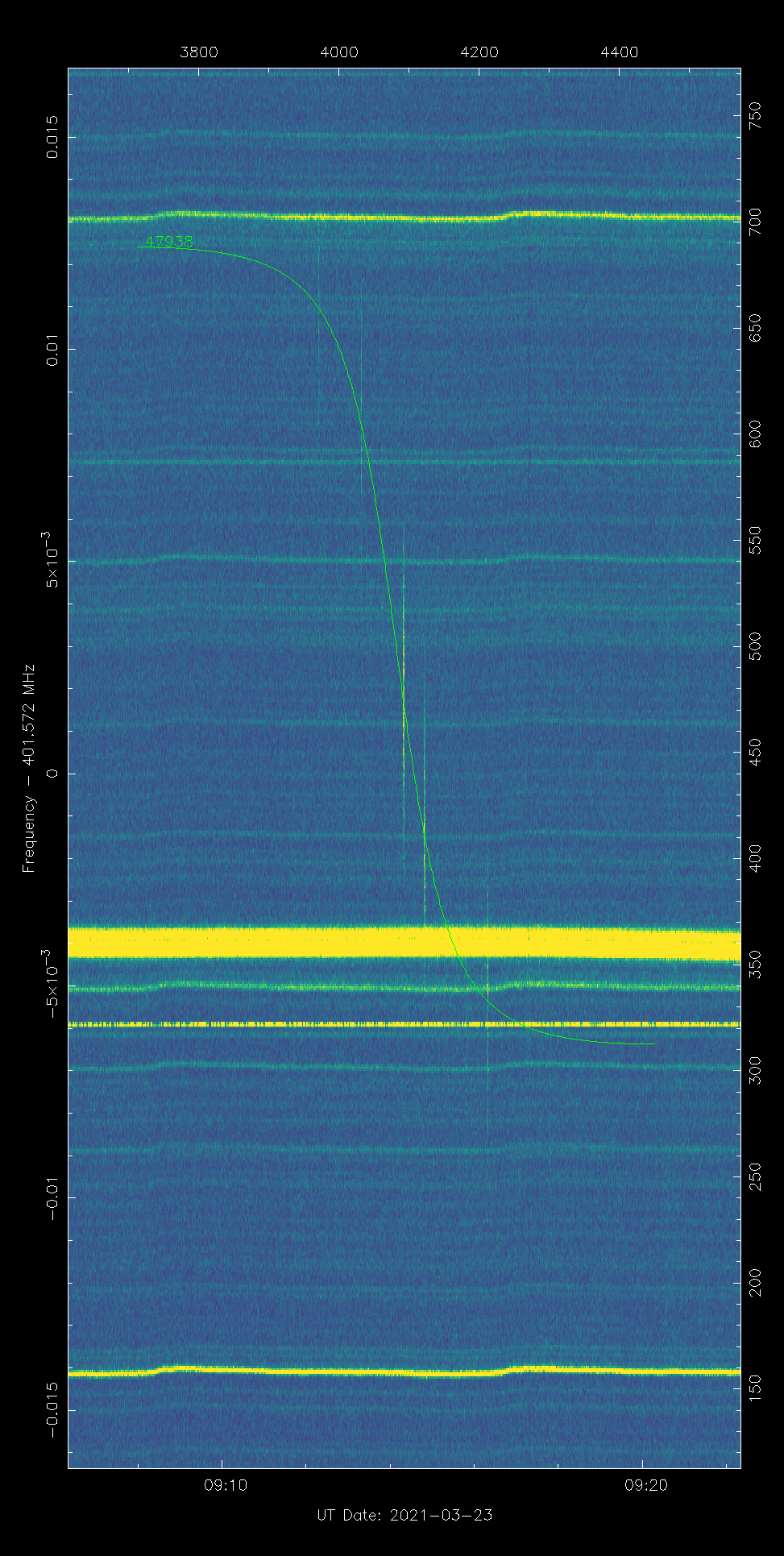

              Almost 8h from the deployment of Unisat-7 satellites and none has been received. Most observations are low passes but I would expect we had at least some faint signals. Let’s keep watching!
No change from the rest of the satellites, except from ChallengeOne which may transmits to 401.575MHz instead of what we thought(401.500MHz). I’ve created a new transmitter and changed some of the scheduled observation to check that frequency and see if we can confirm that this is ChallengeOne. The new frequency comes from @pierros  strf observation:
