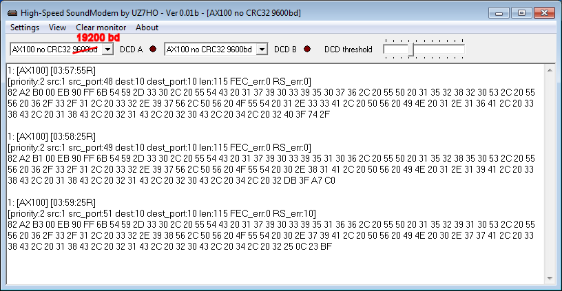

2026-09-26 03:57 UTC. Unattended reception of raw telemetry from HONGHU-2.
The signal was demodulated with UZ7HO’s ax100nocrc32 SoundModem using the same trick I had published on “X” .
1: [AX100] [03:57:55R]
[priority:2 src:1 src_port:48 dest:10 dest_port:10 len:115 FEC_err:0 RS_err:0]
82 A2 B0 00 EB 90 FF 6B 54 59 2D 33 30 2C 20 55 54 43 20 31 37 39 30 33 39 35 30 37 36 2C 20 55 50 20 31 35 32 38 32 30 53 2C 20 55 56 20 36 2F 33 2F 31 2C 20 33 32 2E 39 37 56 2C 50 56 20 4F 55 54 20 31 2E 33 33 41 2C 20 50 56 20 49 4E 20 31 2E 31 36 41 2C 20 33 38 43 2C 20 31 38 43 2C 20 32 31 43 2C 20 32 30 43 2C 20 34 2C 20 32 40 3F 74 2F
1: [AX100] [03:58:25R]
[priority:2 src:1 src_port:49 dest:10 dest_port:10 len:115 FEC_err:0 RS_err:0]
82 A2 B1 00 EB 90 FF 6B 54 59 2D 33 30 2C 20 55 54 43 20 31 37 39 30 33 39 35 31 30 36 2C 20 55 50 20 31 35 32 38 35 30 53 2C 20 55 56 20 36 2F 33 2F 31 2C 20 33 32 2E 39 37 56 2C 50 56 20 4F 55 54 20 30 2E 38 31 41 2C 20 50 56 20 49 4E 20 31 2E 31 39 41 2C 20 33 38 43 2C 20 31 38 43 2C 20 32 31 43 2C 20 32 30 43 2C 20 34 2C 20 32 DB 3F A7 C0
1: [AX100] [03:59:25R]
[priority:2 src:1 src_port:51 dest:10 dest_port:10 len:115 FEC_err:0 RS_err:10]
82 A2 B3 00 EB 90 FF 6B 54 59 2D 33 30 2C 20 55 54 43 20 31 37 39 30 33 39 35 31 36 36 2C 20 55 50 20 31 35 32 39 31 30 53 2C 20 55 56 20 36 2F 33 2F 31 2C 20 33 32 2E 39 38 56 2C 50 56 20 4F 55 54 20 30 2E 37 39 41 2C 20 50 56 20 49 4E 20 30 2E 37 37 41 2C 20 33 38 43 2C 20 31 38 43 2C 20 32 31 43 2C 20 32 30 43 2C 20 34 2C 20 32 25 0C 23 BF

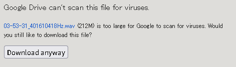

Sorry for the late reply, but my Internet connection at my summer QTH in Chalkidiki is somewhat slow. Anyway, here it is Upload files for free - 03-53-31_401610418Hz.wav - ufile.io

Download
No Google account needed.

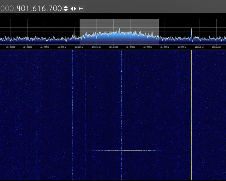

here i convert to sdr++ and cut at 2 frames..
baseband_401610418Hz_11-26-39_26-09-2026.wav.zip (9.7 MB)
