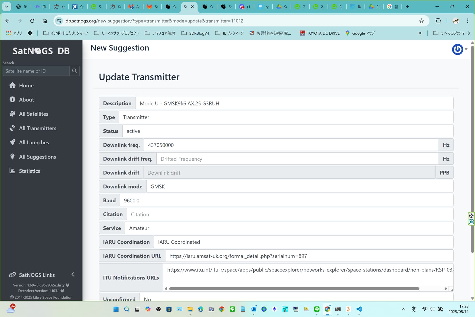

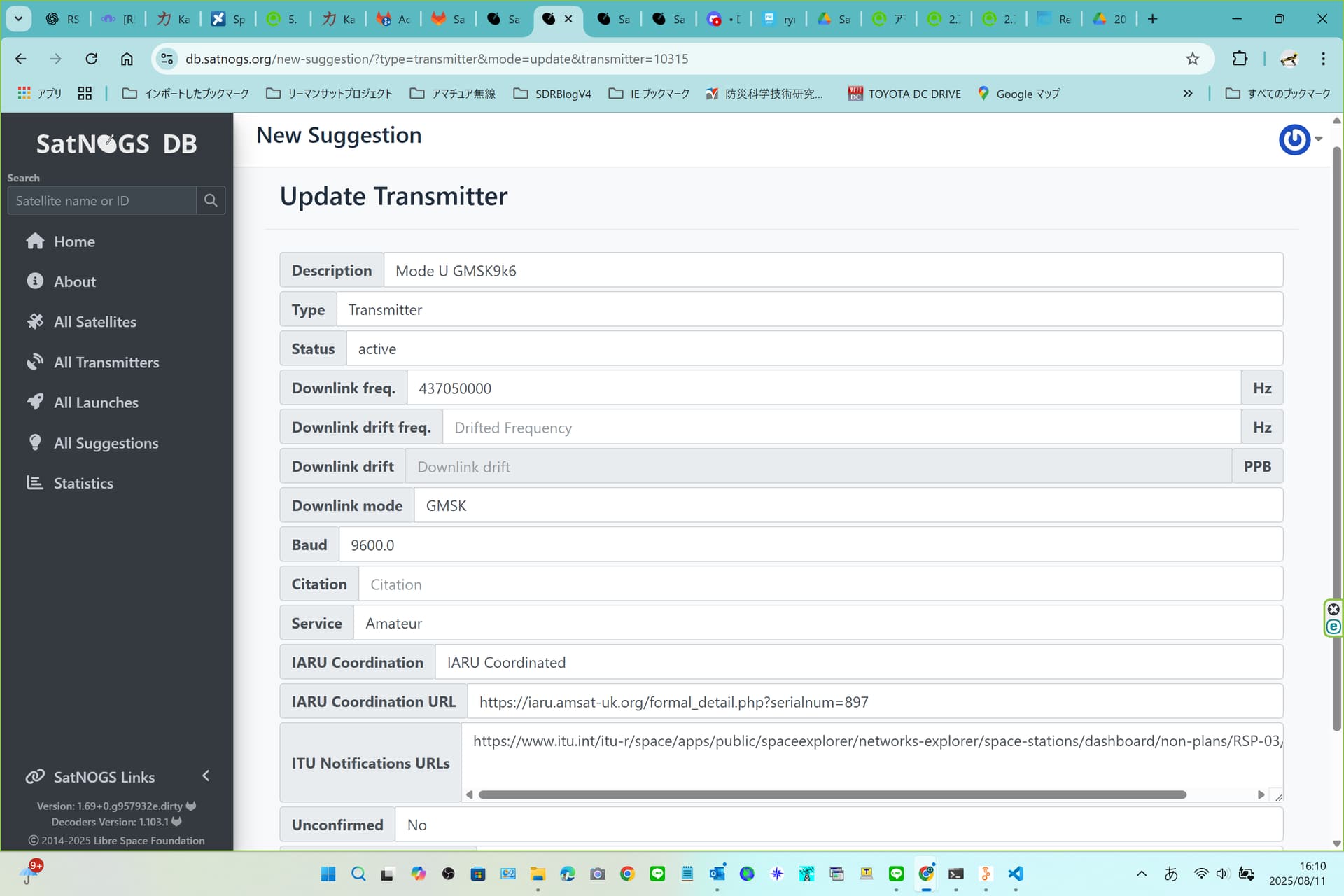

So do you confirm it is AX25 G3RUH ? if so we might need to change the information of this tx in DB.
I also ping @fredy @PE0SAT @pe2bz @SA2KNG in case i forgot something :slight_smile:
It’s a regular/common 9k6 transmission, so it’s (like almost every 9k6) G3RUH scrambled.

Hello @deckbsd, and @dl7ndr,
Our RymanSat ground station team has confirmed through ground testing that the RSP-03 GMSK beacon is indeed AX.25 with G3RUH scrambling (baudrate 9600).
We used GNU Radio (AX.25 Deframer block with G3RUH scrambling enabled) to successfully decode the beacon.
Therefore, the SatNOGS DB transmitter entry should be updated from “AX.25” to “AX.25 G3RUH”.
I have attached the updated RSP-03.yml (zipped) reflecting this framing change for your review. rsp03.zip (2.9 KB)
Could you please confirm the correct merge request workflow for this file?
Should I fork and submit an MR to satnogs-db directly, and request your review?
Could you please clarify exactly which field on the transmitter page needs to be updated to reflect that it’s AX.25 G3RUH instead of plain GMSK?

Regarding the DB transmitter update, the downlink mode should read: FSK AX.25 G3RUH
@estima5633 @SA2KNG @dl7ndr ,
Perfect, thanks for confirming my thoughts, i introduced a suggestion for the transmitter : SatNOGS DB - Transmitter Suggestion ( @fredy )
@estima5633 Once the suggestion accepted, you will be good to go for RX on SatNOGS side of things for the GMSK 9k6 Telemetry beacon, no need for further changes :slight_smile:

This value for mode is deprecated and is kept for compatibility reasons.
I’ve changed the mode to FSK and add in description the rest (AX.25 and G3RUH). By default satnogs-client uses AX.25 G3RUH for FSK, so it should be fine.
By the way we are looking on improve this situation with adding all the necessary details in DB and use them in stations in this milestone.
Oops I missed that, so I’m going to change the transmitter back to GMSK from FSK, again the default for GMSK is AX.25 G3RUH, so it will be ok.
Thank you, I have confirmed that it will be finally registered as GMSK.
