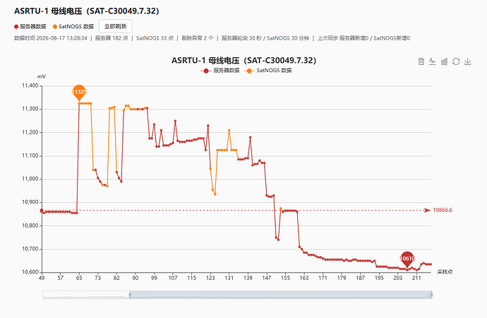

Two days ago, we uploaded new commands intended to adjust the satellite’s attitude. However, it appears that the satellite may not have successfully completed the expected detumbling process. After the angular rate increased, it automatically entered rate damping mode and subsequently transitioned into three-axis control mode. As a result, the attitude did not change as expected from our commands.
We have just discovered that the battery voltage is lower than expected and have urgently uploaded another set of commands in an attempt to improve the situation.
Therefore, I would greatly appreciate it if SatNOGS station operators could schedule some additional observations of ASRTU-1 during the next 24–48 hours. Additional telemetry and observations from different parts of the world would be very helpful for us in assessing its current power and attitude-control status.

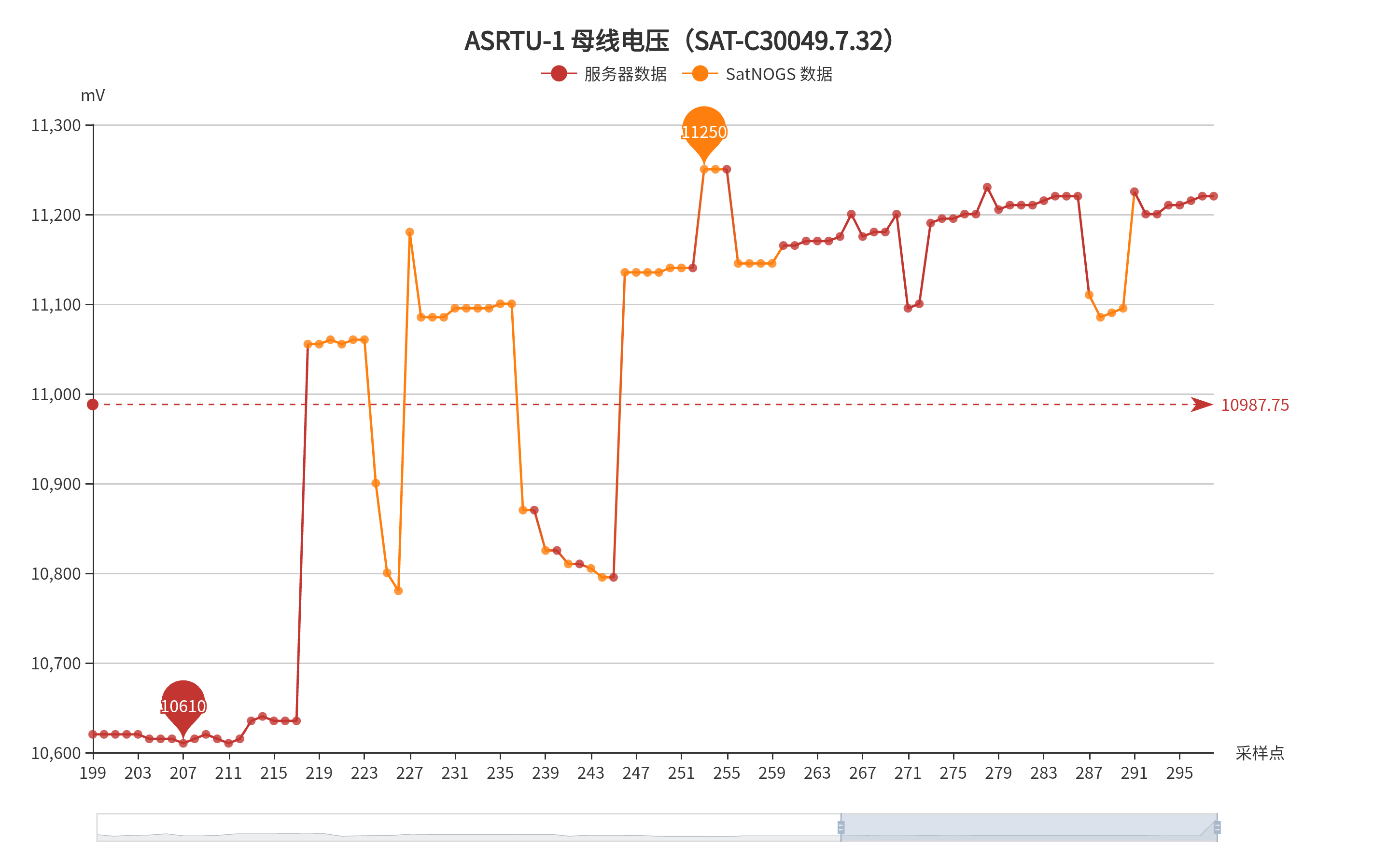

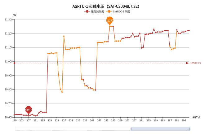

Are the values of the graph when the satellite is in umbra? The voltages from this morning’s reception at ~06:40 UTC look good to me.
ASRTU-1 uses a 3S3P Li-ion battery pack. In the telemetry, “Bus Voltage” refers to the battery pack voltage itself, so this is the main value to look at when evaluating the battery condition. A bus voltage below about 10.5 V indicates that the battery level is relatively low.
The charger voltage is also related to the bus/battery voltage to some extent, so it can be used as an additional reference.
The 12 V and other regulated voltage readings should not be used to judge the battery state, as those are regulated outputs after the DC-DC converters.

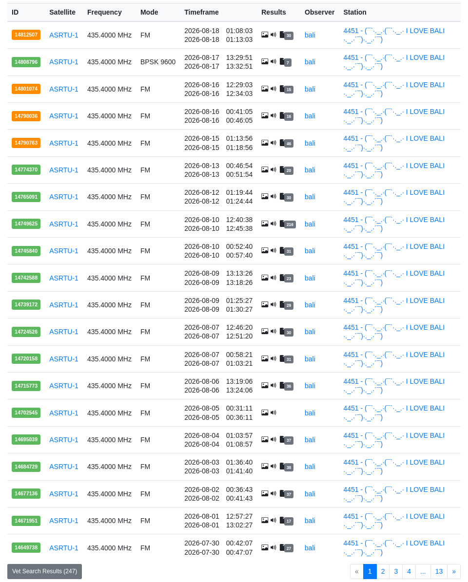

my station auto schedule asrtu-1 everyday. twice post on QSL events, but never got … :frowning:
Thanks to you all for your help! We are seeing encouraging signs that the satellite is recovering well!

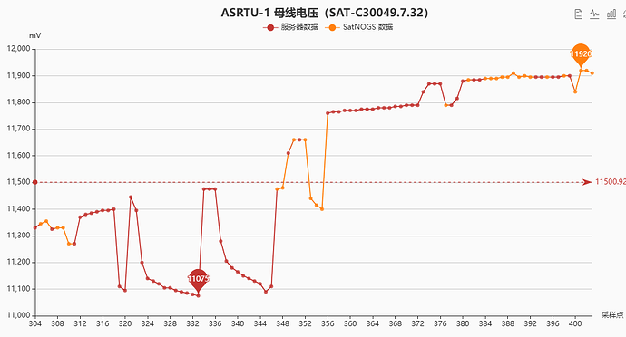

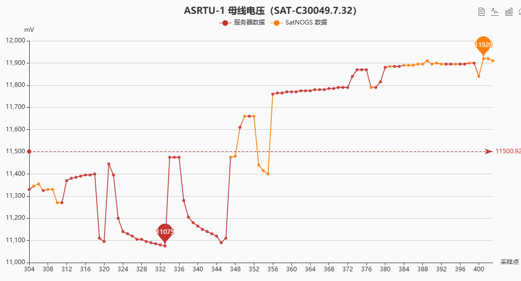

Thanks to continuous monitoring by the SatNOGS network
ASRTU-1’s battery voltage has recovered to near the safe voltage level (11.9V).
This indicates that our attitude adjustment was very successful, and it may recover to a much higher value in a few days.

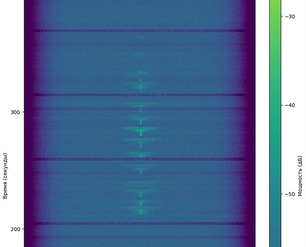

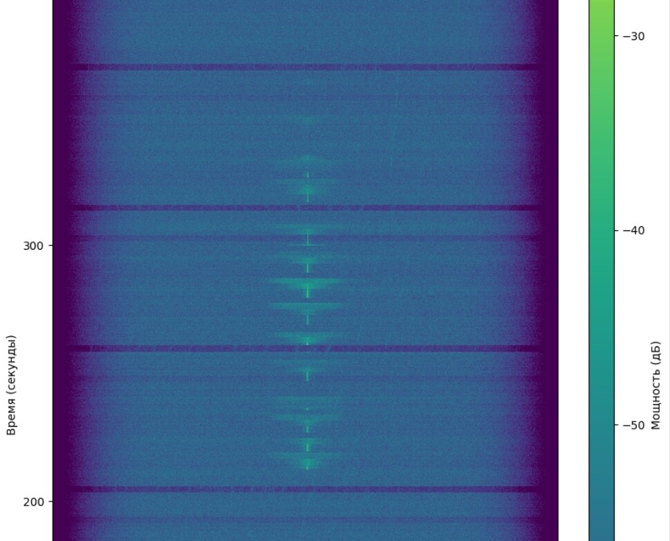

https://sonik.space/observations/1535879/
Got telemetry and transponder pattern (?) this morning
Also for the last 2-3 days of ASRTU-1 observations from my ground station telemetry packet number and signal strength

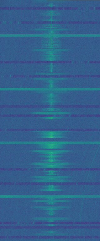

Voice FM
Very great signal,I really happy you can give me this information。
Also we can see the TLM stop becasue FM Carrier​:+1:
