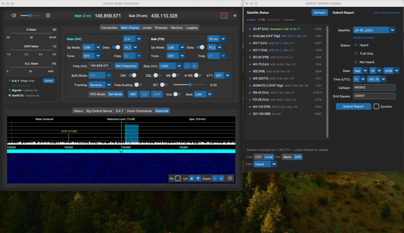

Free Software - Remote Control Of Your ICOM IC-9700, IC-7610 and IC-7300MK2 With AI-Assisted Operating. First class satellite operations.
Built into the software alongside the Hamlib rigctld server is support for popular satellite tooling, such as WSJT-X, Gpredict, CSN Techologies S.A.T controller and SatPC32. This enables full duplex remote doppler control from programs you already use.

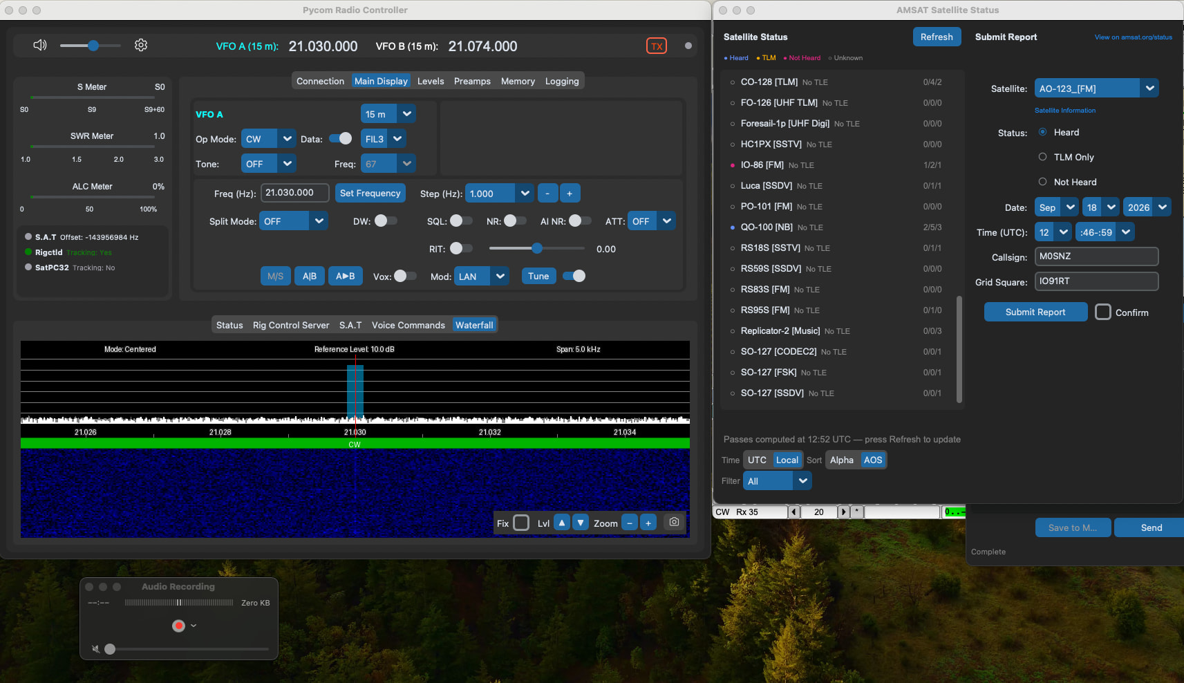

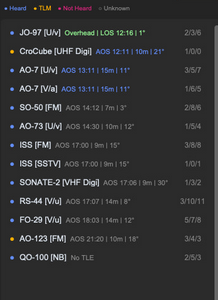

why no IO-86 bro? you should add bro!
It’s driven by the Amsat status page - if you look down the bottom there’s filters, it probably hasn’t been heard for a day or two…
without io86, its not complete
for io86 tle you can get from satnogs. becase celestrak and space-track not update their tle.

That window is just an Amsat status/update window - the software relies on something else to supply the doppler for example Gpredict (via rigctl) / CSN S.A.T or SatPC32.
If you use S.A.T or SatPC32 it additionally sets up the radio with the settings for the satellite.
