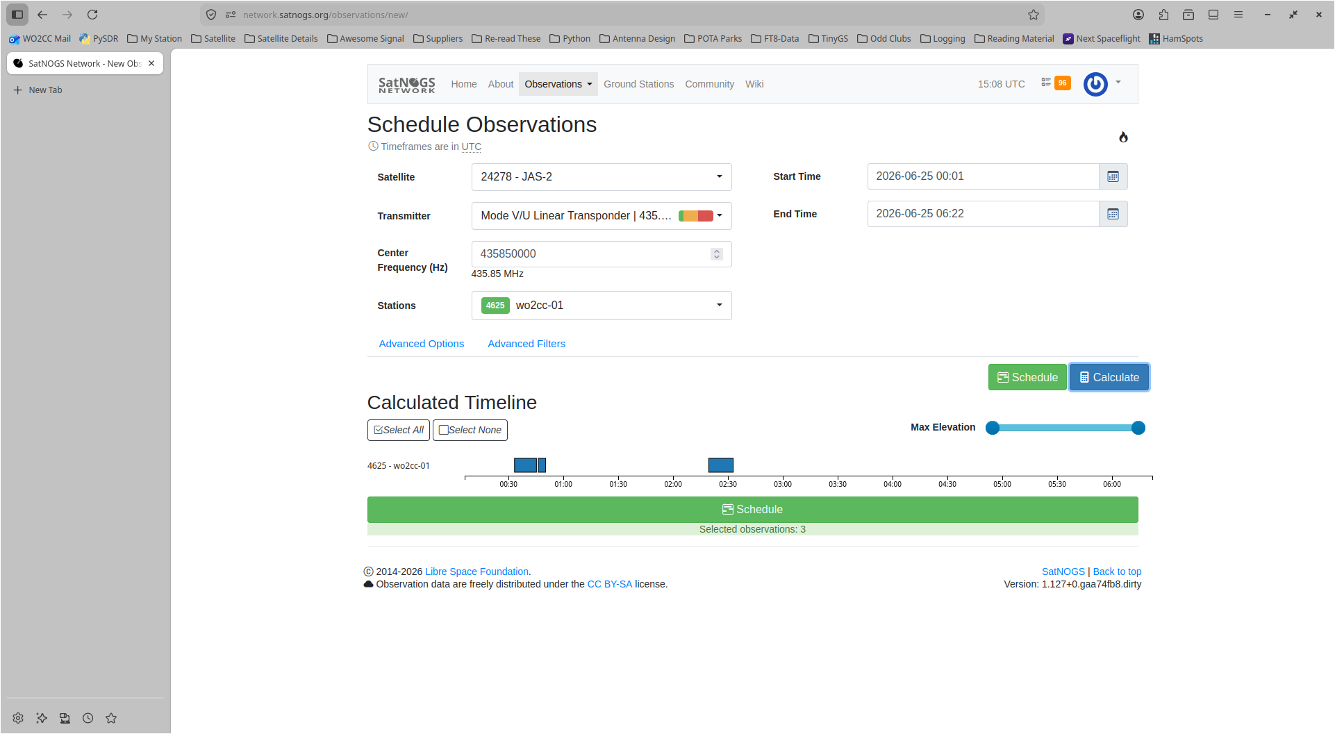

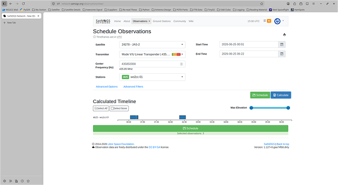

Any idea why this happens (the first “two” passes on the 25th)? If you mouse-over on the new-obs screen, it’s like an 80/20 of a whole pass, but … weird. It doesn’t happen ALL the time, but this is the second or third time I’ve noticed on JAS-2 (FO-29).
PRETTY sure it’s not operator error, but I cannot exclude that right now… :sweat_smile:
Advice?

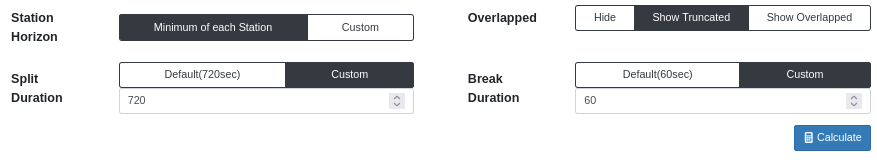

There is a minimum duration for each observation, which is 12min(720sec), whatever is over this gets split to a new observation. There is also gap with a 1min(60sec) default duration between split observations.
Both of them can be changed/set in the advanced options in the observations/new page.
Oof… it WAS operator error…
Sigh… Thank you. In another 2 or 3 years, I think I’ll have all the nooks and crannies of SatNOGS figured out. Maybe… maybe not…
Hopefully earlier :slight_smile: as we (slowly) build user manual/documentation in wiki on how to use SatNOGS Network and DB.
wow. the custom feature is cool…
