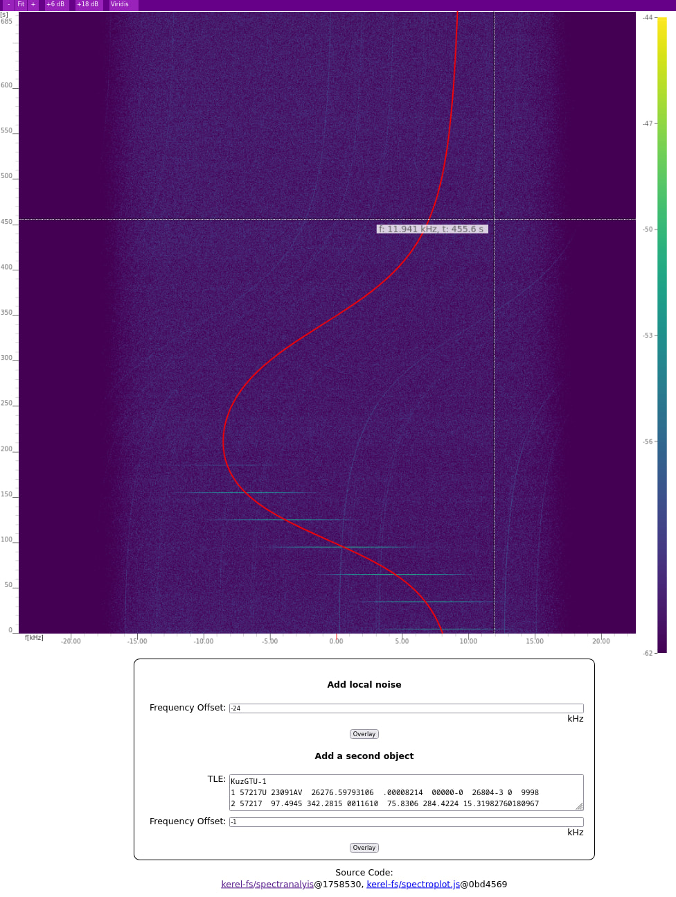

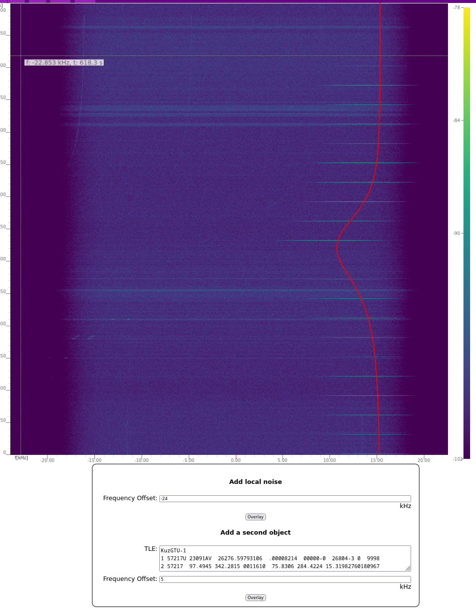

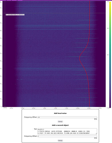

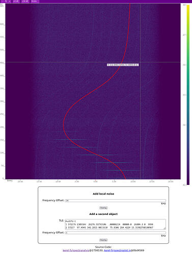

i confirm this is not kensat,
obs on @stefanp also not kensat
both are KuzGTU-1 (Alternate Names RS47S) (GMSK USP 9K6 - 437.100 MHz)
-> Packet from 9k6 FSK USP downlink
