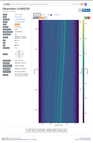

Following my previous observation of TRITON-1, I’ve captured another pass (Observation #14840214) for PRATHAM (41783) with my station (4950 - jp7dvx).
Once again, the waterfall shows very clean Doppler curves (around +12 kHz). Since the status is “Unknown” again, I am curious: is this characteristic signal behavior for PRATHAM, or am I catching another “unexpected visitor” passing through the same frequency band?

If all is set well, and the TLE for the satellite you are observing matches the satellite, your satnogs station is compensating the frequency “drift” caused by the speed of the moving object. So, a valid observation should be as close to a straight line as possible.
This also causes terrestial signals which are being picked up on that same frequency. do shift with that compensation and cause a doppler curve in the waterfall results.
So the signal showing is not the satellite but could be caused by anything local, even some radiation from an Internet / network router.
For example, from my S-band station, this is a valid one, because the Optsat is classified and does not get a daily tle update
while this one is failed, this is a local signal which follows the tuning doppler and is a locally received signal.
Last one https://network.satnogs.org/observations/14725401/
Shows the satellite in the center, which makes it valid, and also shows some local signal being moved over the waterfall because of the doppler tuning.

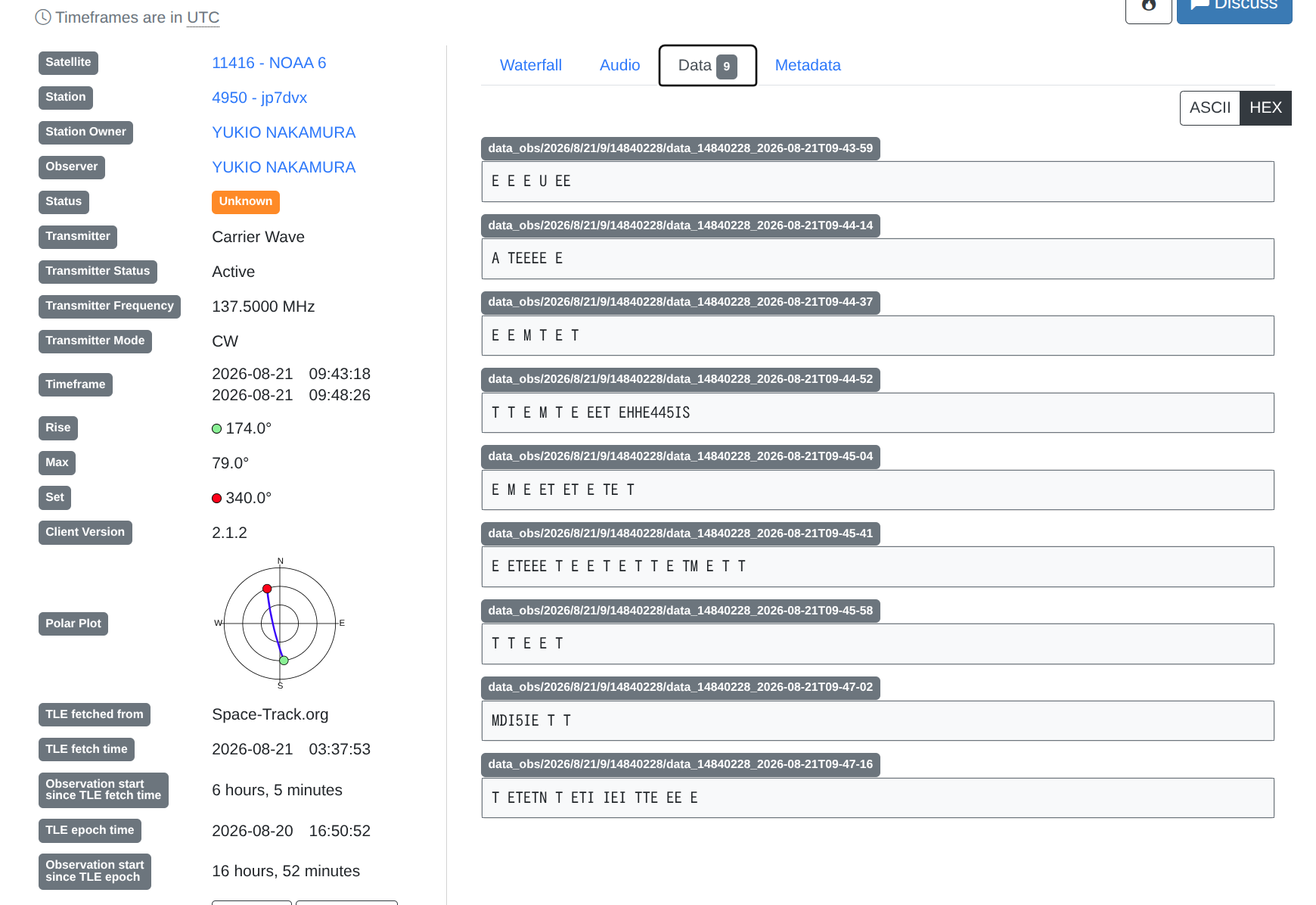

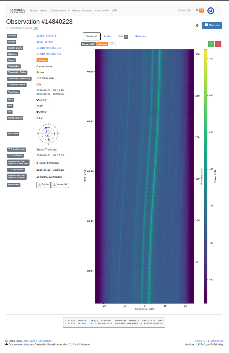

In fact, looking at one of my other recent observations (Observation #14840228 for NOAA 6), I noticed that even the decoded data tab was full of random “E” and “T” strings (like E E E U EE, A TEEEE E). Now it all makes total sense—the CW decoder was simply mistaking my local noise curves for Morse code!
