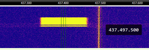

Observation 14425602: Coconut (98292)
Regarding Observation 14425602 … and others
I am not sure whether these are LoRa Signals - I usually don’t have QRM like this here and they only occure during Coconut passes. I could not decode with the SX1262 on TinyGS with the published parameters. Unfortunately the WF resolution is not good enough to identify the signal - needs an IQ recording during next passes.
Stefan/OE6ISP
The signals are from Coconut. analyzing the I/Q rec. now …
as the BW is 128K, this is more likely from a PROVE. It’s difficult, when they are all on the same QRG and same orbit :slight_smile:
Finally K4KDR found, that this is HUCSat.
