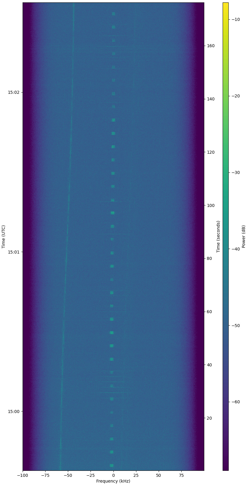

Observation 14244999: PHASMA-DIRAC (66681) ? WOW - RARE EVENT
Regarding Observation 14244999

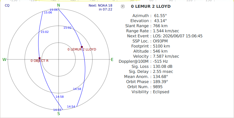

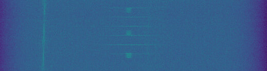

when PHASMA DIRAC (object R - 66681), and other satellite LEMUR 2 LLOYD (60577), in one waterfall, in one straight line
Phasma Diract / object r altitude 495 km
Lemur altitude 546 km
reality :
rffit -d 14244999.dat -c tle-satno-2026-06-07.txt
Loaded 1611 orbits
rms limit (kHz): 1
70369: 0.586 kHz 400.550628 MHz | NEWSAT 33
60496: 0.663 kHz 400.550291 MHz | TYCHE
60577: 0.672 kHz 400.550423 MHz | LEMUR 2 LLOYD
63257: 0.580 kHz 400.550373 MHz | ICEYE-X51
66681: 0.246 kHz 400.549729 MHz | OBJECT R
Identified 5 candidate(s), best fitting satellite is 66681 - OBJECT R.
