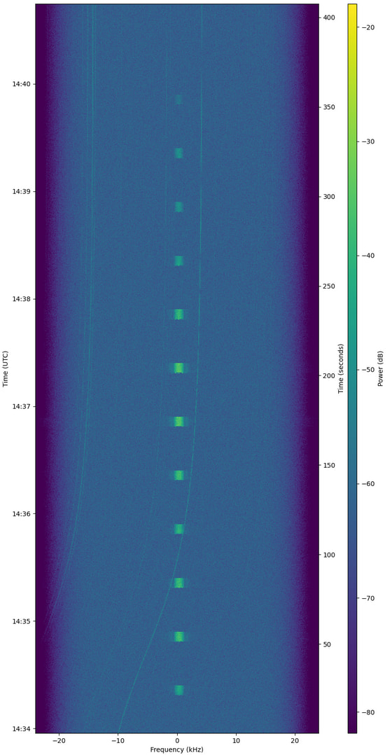

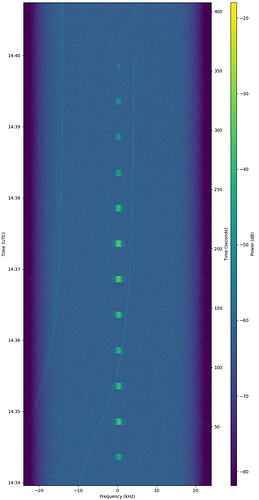

mhuebner:
Just sharing a quick hotfix, hoping its the right place here.
On Station 1860 , we patched the satnogs-client, to just don’t use the AX100 flowgraph anymore:
it work on my station. thank you! very simple. only change one line. for decoding data, just put satyaml of ax100 mode 5 satellites on gr-satellites satyaml folder..
observation 14938126 - ion-scv-014
i got many decoded data
full waterfall:
time for push rank
sdoukos

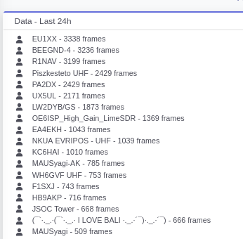

AX.100 is back with stunning performance!
thank you @sdoukos !
