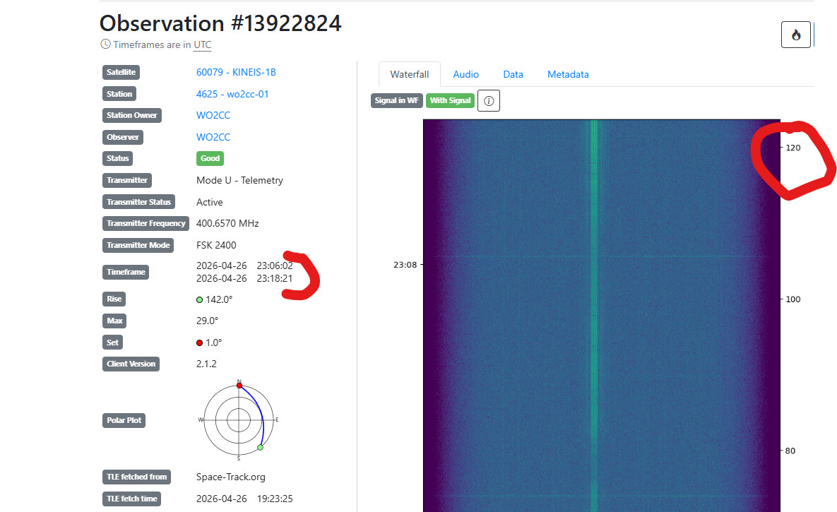

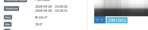

Regarding Observation 13922824
So, I’m trying to troubleshoot my station. This observation was ORIGINALLY auto-labelled as failed, and I was trying to look back into the log and see WHY it failed. (I’d had a series of failures because the SDR wasn’t registering as existing!)

So, I can see in the last couple lines of the log that the waterfall image and audio were (finally) successfully uploaded. When I look at the record, I see… something… I think it looks like an FSK signal that surprising strong at rise and set. Not yet my strong point, FSK…
So, I originally hit the green check because there was a signal there… but, now that I read the error logs, I’m not sure.
My Questions:

fast read, it think it caused by network . and the best of satnogs is, if your station disconnect from satno server (sometime it caused by network maintenance), just relax. maybe you will see at satno dashboard it black (failed), but when the client can connected to server, and finish upload all waterfall, and audio, it will turn black to orange or green.
but after i check again your obs, it set failed by system, because the audio recorded is too short:
it should be around 12 minutes.
To be honest, it fails correctly. Your registration is approx 2 minutes, and the expected pass time is about 12 minutes. Looks like a lot of data dropped somewhere.
Now that was a well timed reply -)
Ahhh… and that helps to explain why the signal was so strong at rise and set…
Okay.
That tells me there’s something going wrong inside my system that’s causing this. Yeah! More forensics!
Thanks for catching that, Bali AND pe2bz… I’m surrounded by wise people!
Copy paste from older post :slight_smile:
When the difference between audio duration and observation duration is more than 1min, network automatically mark the observation as failed.
This difference usually happens when there are lost samples. Samples that the cpu can not handle. The reason behind that tends to be either a high sample rate or a high cpu temperature that force cpu to run in lower frequency and lose samples or a not good power supply which has the same effect as the high temperature on cpu.
