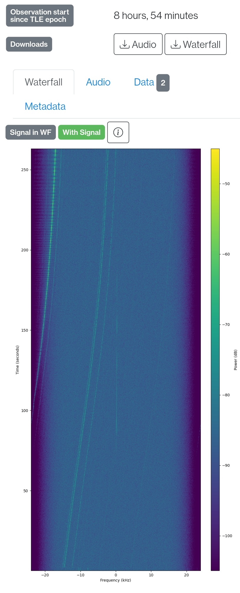

Regarding Observation 13351830 …
Hello, why the signal is bent at upper left corner?

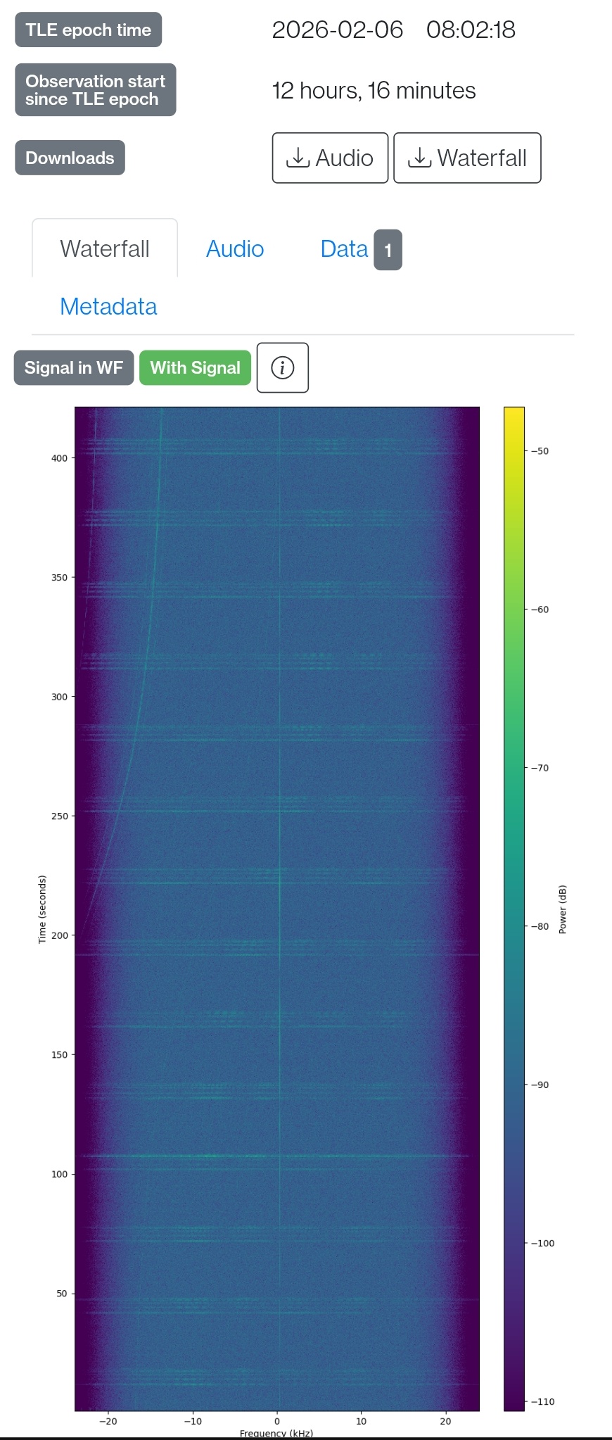

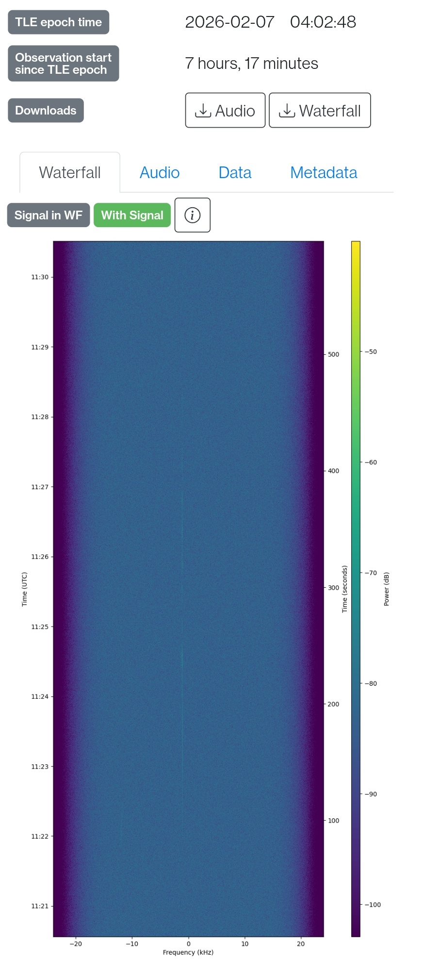

Hello, the “bent signal” looks to be just external noise as seen in these other observations of the same satellite. The signal or frequency you want to see is at 0 kHz, which you have. Nice ![]()
Thanks a lot.
