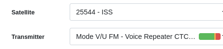

for iss , i recommend to obs at mode v/u fm. because the signal is always on.
