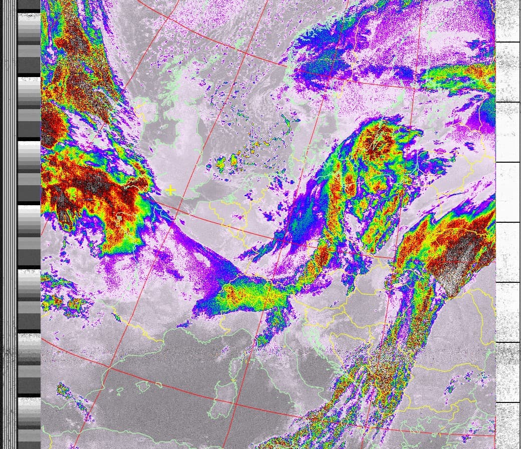

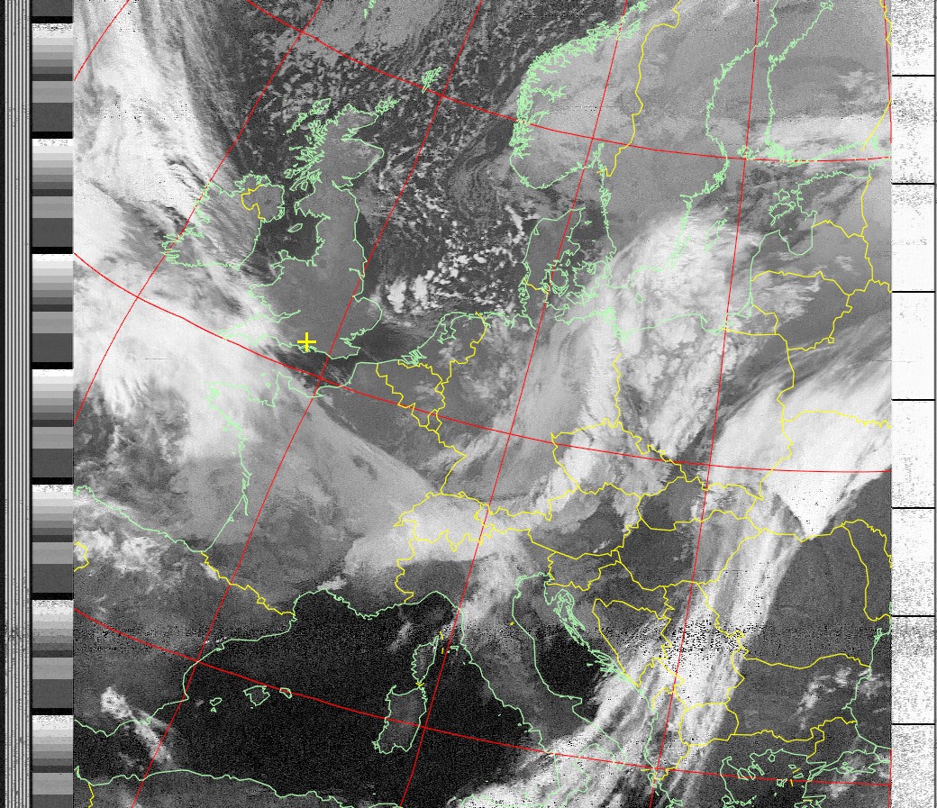

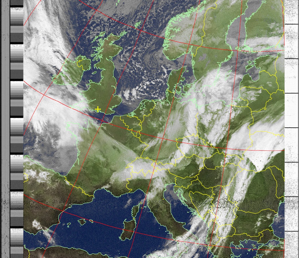

Images from NOAA-19 over Europe this evening at around 2015 UTC[grid]
[/grid]
