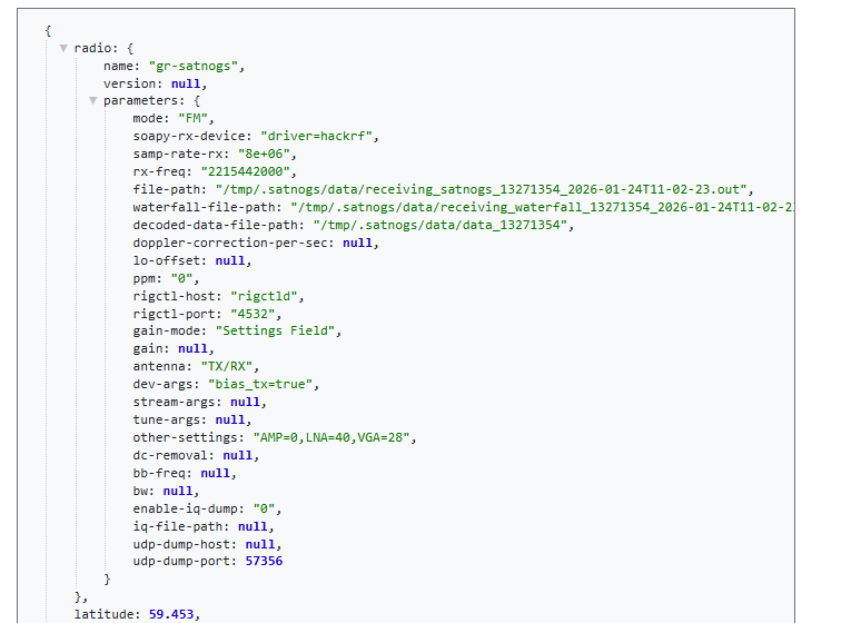

Hi,
I noticed this observation SatNOGS Network - Observation 13264122 with waterfall but gain appears to be not set / zero.
Don’t know if that helps but just to inform you
Ben

An observation from 11:02 local time still shows your gain is not set ?
I’m sorry, but where do you see that the gain is not set? The waterfall is set to show between -90 and -50 dB so when no signal present the waterfall will become dark.
If you look at the following observation you see a signal, it is not a satellite signal but some local interference but you see it in the waterfall.
My big mistake Lars, I assumed “Overall” but you set clearly “Settings Field” and the necessary gain fields.
