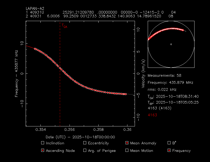

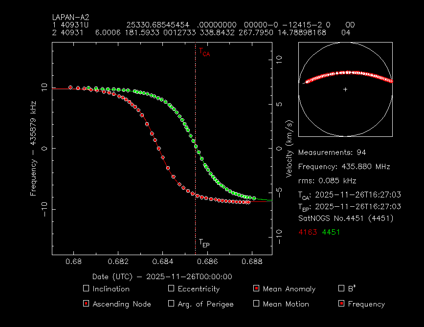

LAPAN-A2 TLE Update
strf file:
LAPAN-A2-18-OKTOBER-2025.dat (2.4 KB)
gpredict tle file:
lapan-a2_2025-10-18.txt (207 Bytes)
ikhnos:
please update to satnogs db
LAPAN-A2
1 40931U          25291.21209780  .00000000  00000-0 -12415-2 0    04
2 40931   6.0006  99.2509 0012733 338.8432 140.9063 14.78961520    08
# 20251018.35-20251018.36, 58 measurements, 0.022 kHz rms
thank you

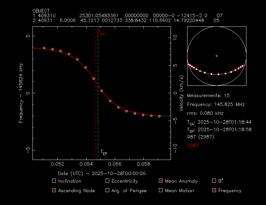

strf file:
LAPAN-A2-28-OKTOBER-2025.dat (630 Bytes)
gpredict tle file:
lapan-a2_2025-10-28.txt (149 Bytes)
ikhnos:
LAPAN-A2
1 40931U          25301.05483361  .00000000  00000-0 -12415-2 0    07
2 40931   6.0006  45.1217 0012733 338.8432 110.6602 14.79220448    05

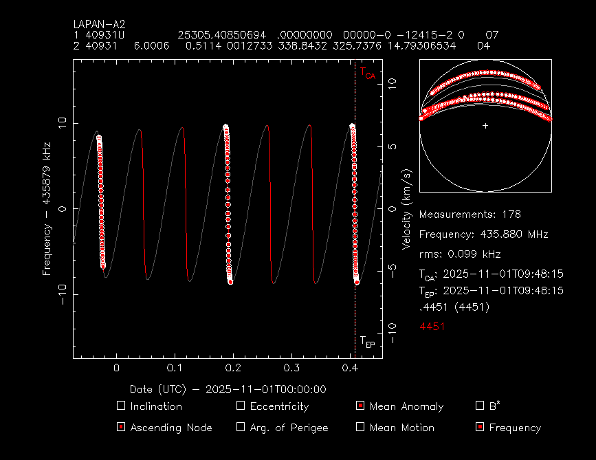

strf file:
LAPAN-A2-1-NOVEMBER-2025.dat (7.3 KB)
gpredict tle file:
lapan-a2_2025-11-01.txt (149 Bytes)
ikhnos:
LAPAN-A2
1 40931U          25305.40850694  .00000000  00000-0 -12415-2 0    07
2 40931   6.0006   0.5114 0012733 338.8432 325.7376 14.79306534    04
