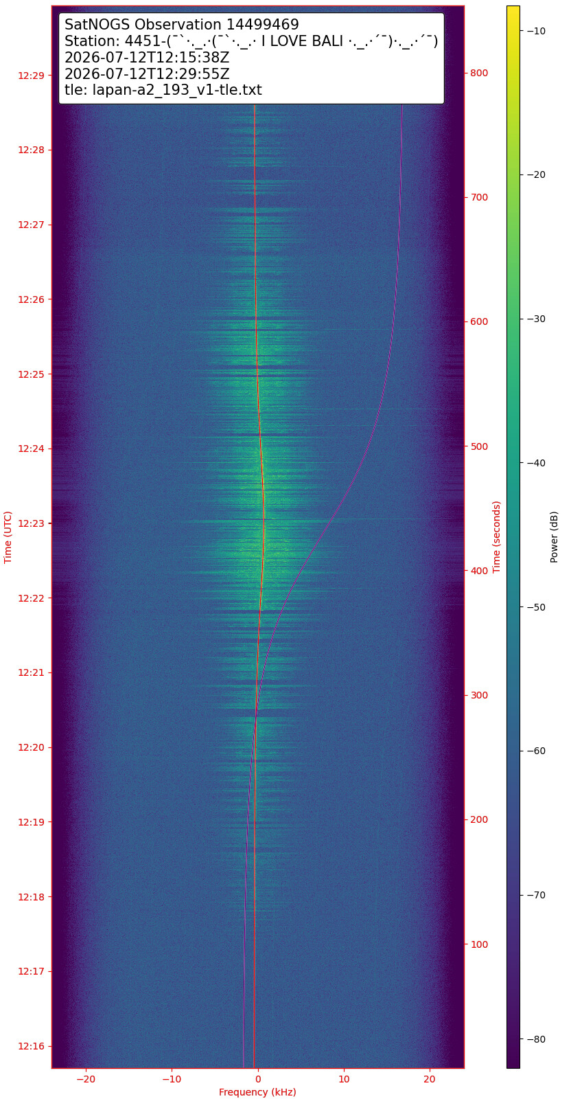

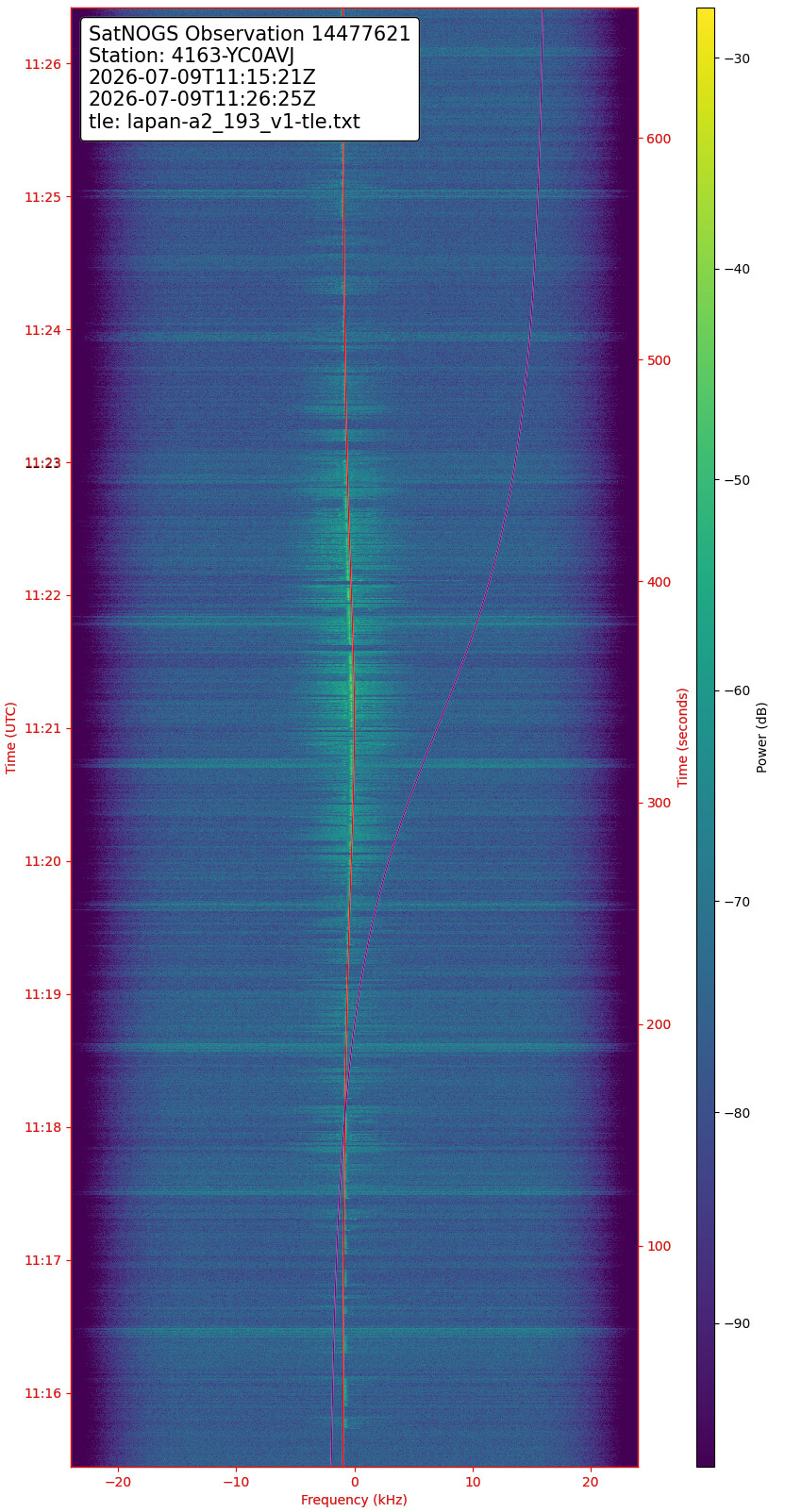

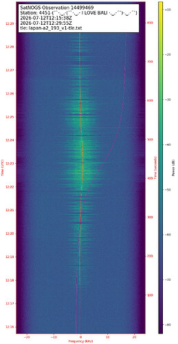

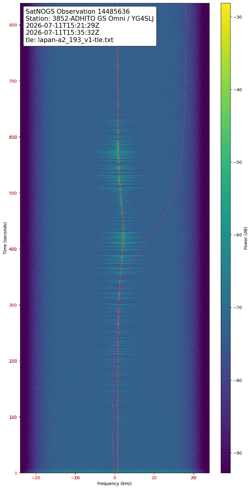

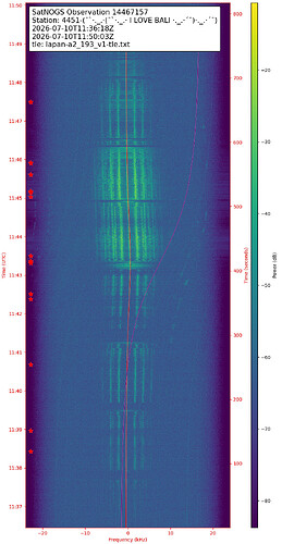

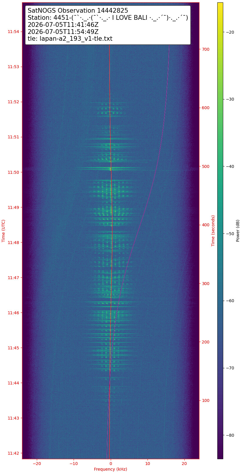

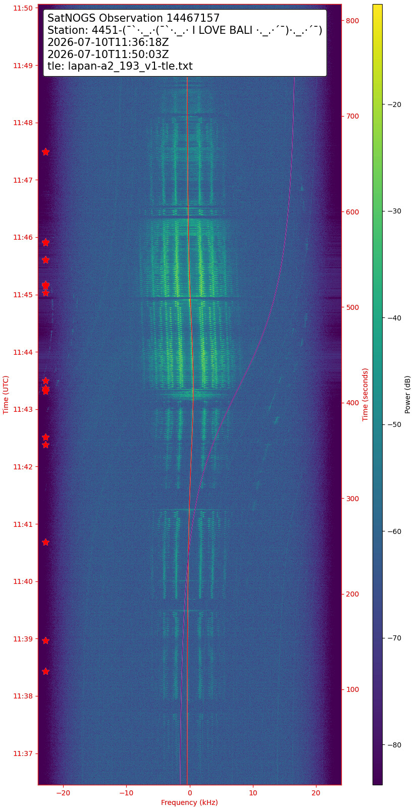

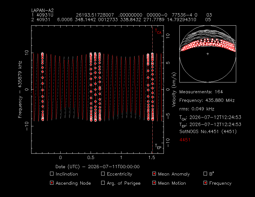

LAPAN-A2
1 40931U 26193.51728007 .00000000 00000-0 77536-4 0 03
2 40931 6.0006 348.1442 0012733 338.8432 271.7789 14.79294310 05
# 20260710.70-20260712.52, 164 measurements, 0.049 kHz rms
# 14499469_14499468_14482110_14482109_14482108_14475080.dat (total: 6 obs) (duration: 0 hours) (magic key: manual)
# generated using: https://github.com/hobisatelit/satno2tle (v0.03)
lapan-a2_193_v1-data.zip (19.3 KB)
lapan-a2_193_v1-tle.txt (391 Bytes)

Great catch of LAPAN-A2! My own station’s setup is a bit too humble to achieve this, so I truly appreciate you sharing such clean, detailed data for the community.

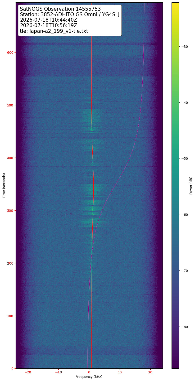

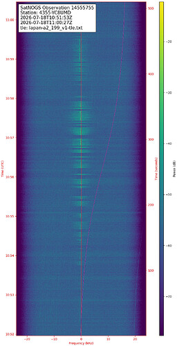

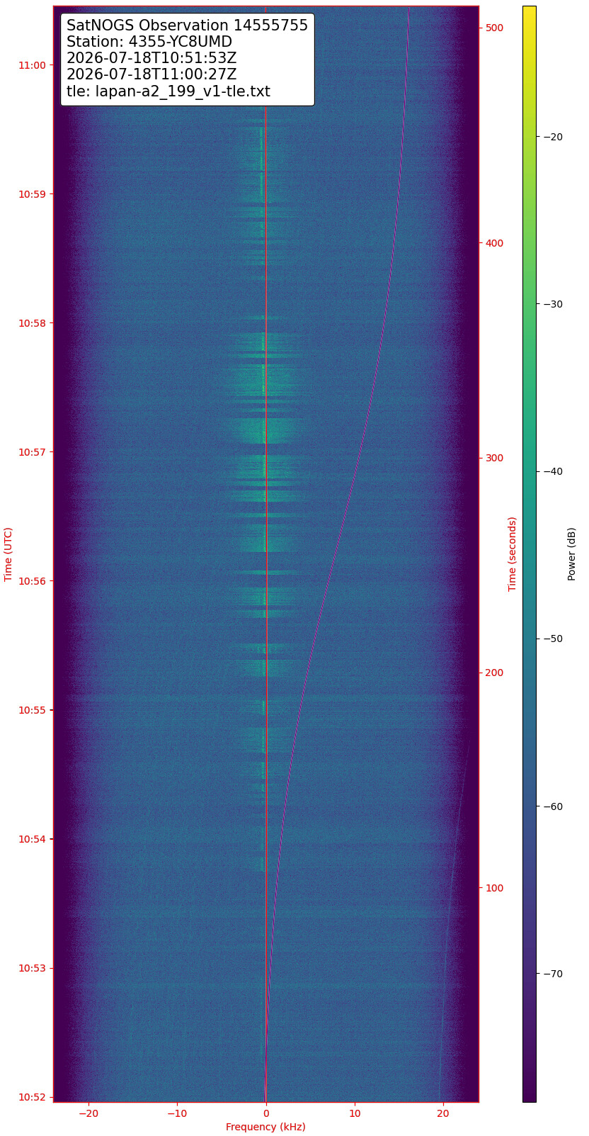

LAPAN-A2
1 40931U 26199.45381863 .00000000 00000-0 77536-4 0 07
2 40931 6.0006 322.6653 0012733 338.8432 273.6875 14.79294310 03
# 20260718.45-20260718.46, 25 measurements, 0.031 kHz rms
# 14555756.dat (total: 1 obs) (duration: 0 hours) (magic key: 25sfefef)
lapan-a2_199_v1-tle.txt (347 Bytes)
lapan-a2_199_v1-tle.zip (9.9 KB)

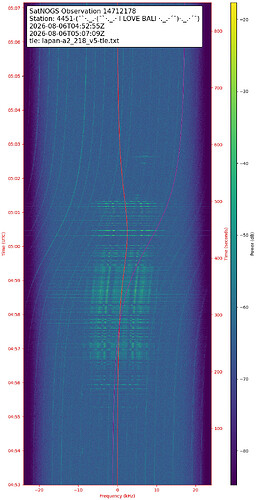

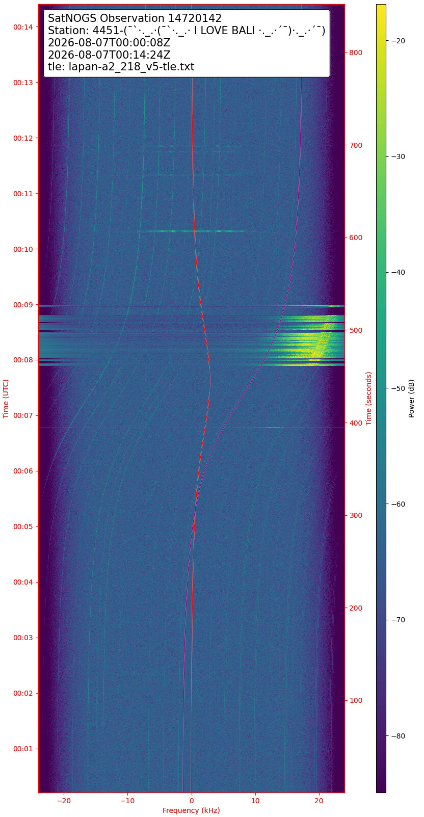

LAPAN-A2
1 40931U 26218.13739305 .00000000 00000-0 10387-3 0 02
2 40931 6.0006 185.8566 0012733 338.8432 319.5598 14.79294310 07
# 20260805.05-20260806.21, 43 measurements, 0.070 kHz rms
# 14712178_14712177_14712176_14702534.dat (total: 4 obs) (duration: 0 hours) (magic key: manual)
lapan-a2_218_v5-tle.txt (372 Bytes)
lapan-a2_218_v5-tle.zip (12.9 KB)

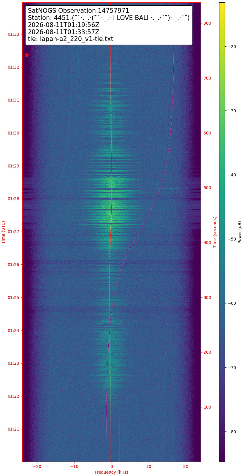

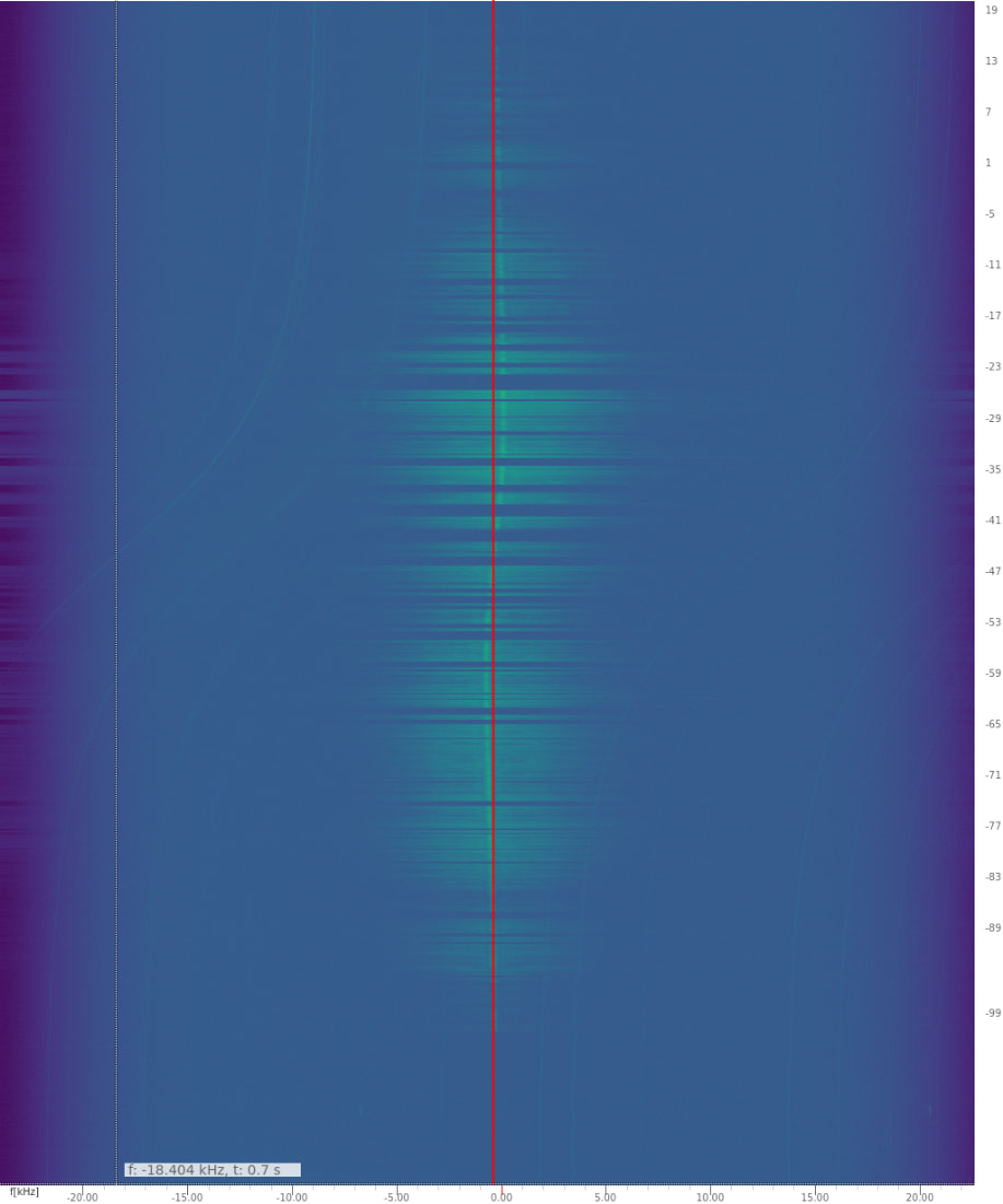

For the first time, I found a TLE that was less accurate, where at high elevation it’s usually slightly curved but this one is actually straight, whereas at lower elevation which is usually straight, it’s slightly curved instead.
Observation #14730213
elevation max: 61.0°
Observation #14730214
elevation max: 48.0°
still wondering whats causing this?
life must go on, fix this with more accurate TLE based on Observation #14730214
then verify later obs with ikhnos

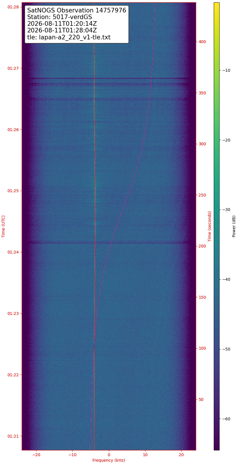

LAPAN-A2
1 40931U 26220.16386494 .00000000 00000-0 10387-3 0 05
2 40931 6.0006 158.1389 0012733 338.8432 353.2145 14.79294310 06
# 20260808.16-20260808.17, 26 measurements, 0.040 kHz rms
# 14730214.dat (total: 1 obs) (duration: 0 hours) (magic key: manual)
lapan-a2_220_v1-tle.txt (345 Bytes)
lapan-a2_220_v1-tle.zip (9.9 KB)

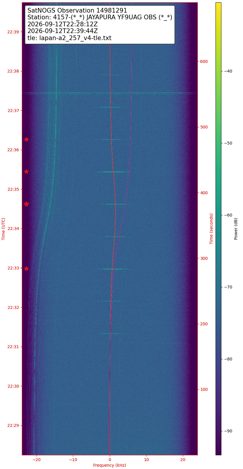

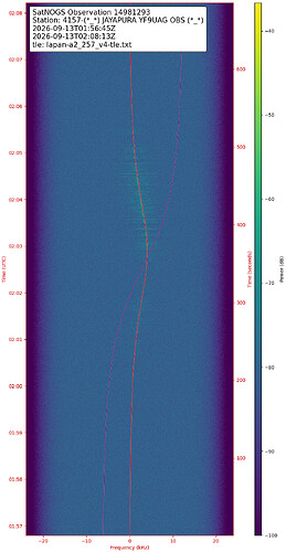

LAPAN-A2
1 40931U 26257.02208006 .00000000 00000-0 10000-5 0 06
2 40931 6.0006 250.8382 0012733 338.8432 247.7984 14.79304832 08
# 20260913.00-20260914.02, 126 measurements, 0.087 kHz rms
# 14991204_14986407_14986405_14986404.dat (total: 4 obs) (duration: 24 hours) (magic key: manual)
lapan-a2_257_v4-tle.txt (374 Bytes)
lapan-a2_257_v4.zip (17.3 KB)
