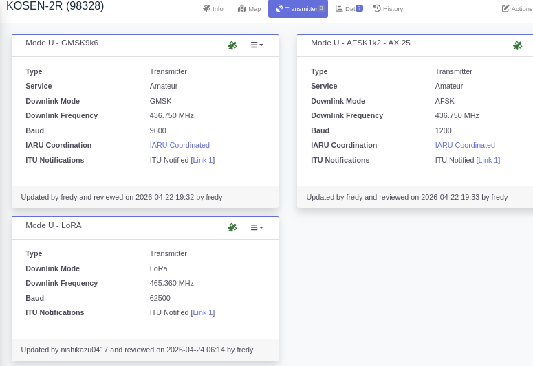

can the team confirm that the telemetry freq at db.satnogs.org is correct ? is all freq auto activated when the sat deployed? if not what main freq ? btw can the team provide the iq file example ?
Hello Bali,
Understood. I will check to them whether they can provide information regarding the current tracking objects and the transceiver information, as well as sample IQ files.
Please wait for a while.

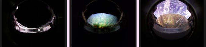

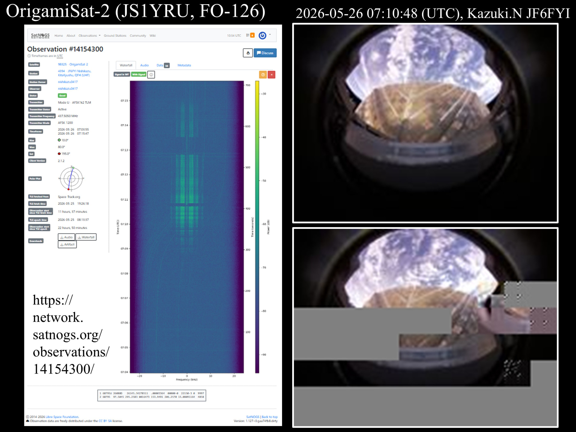

At around 2026-05-26 07:10 UTC, my SatNOGS GS successfully received the AFSK 1k2 telemetry downlink from OrigamiSat-2.
From a total of 59 received packets, I successfully reconstructed an thumbnail image captured by the onboard camera showing the deployed origami antenna membrane together with the Earth! :satellite::globe_showing_asia_australia:
SatNOGS Network - Observation 14154300
Congratulations. Great job. Do we know if such downlinks will occur for other parts of the world or only over Japan?

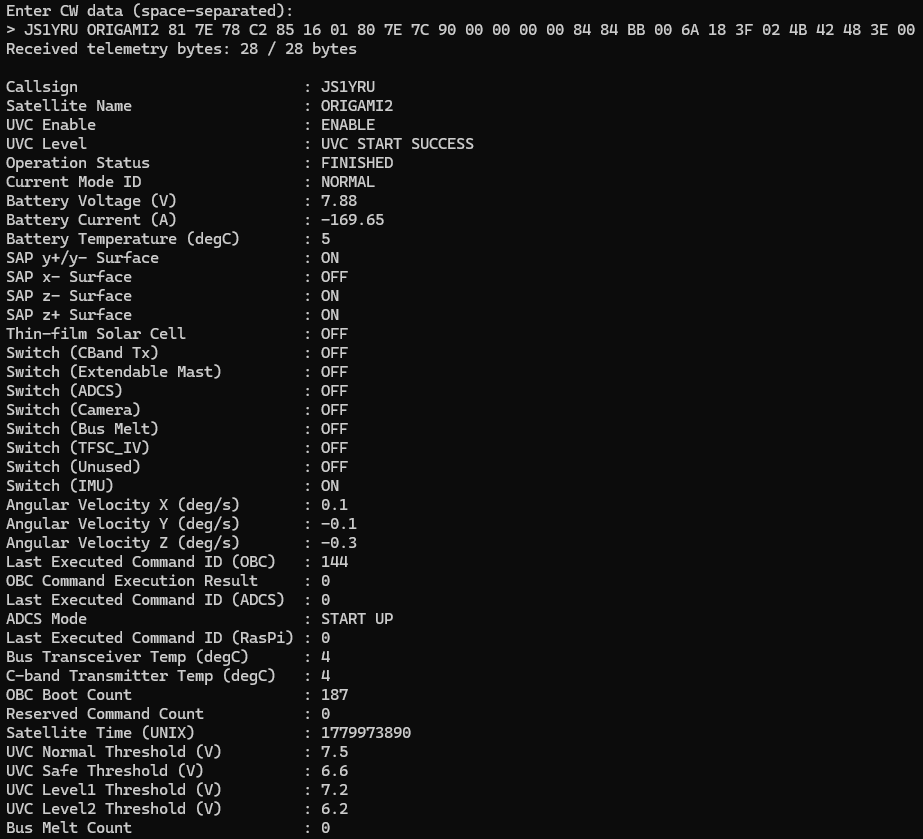

OrigamiSat-2 13:07-13:17 UTC
JS1YRU ORIGAMI2 81 7E 79 2B 84 12 01 80 7E 7A 90 00 00 00 00 83 84 BB 00 6A 18 3E B6 4B 42 48 3E 00
JS1YRU ORIGAMI2 81 7E 78 C2 85 16 01 80 7E 7C 90 00 00 00 00 84 84 BB 00 6A 18 3F 02 4B 42 48 3E 00
https://sonik.space/observations/1362711/
thank you je9pel

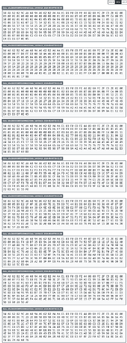

@je9pel @nishikazu0417
i try using the hex data from above obs., select data tab.
then select all, and copy paste into text file. than remove unwanted text and hex,
( like remove first 16 bytes ax25 header - 94 A6 62 B2 9C AA 60 94 A6 62 B2 A4 AA E1 03 F0 ), search the jpeg header FF D8 and footer FF D9
remove space and newline, then the last and important remove the error source , remove the huffman (FFC4 … ), remove the crc check (2 bytes at the end every line)
then running
and voila result not perfect, buat at least better than other noob. lol
i put the file here, so other noobs can follow:
final.txt (7.8 KB)
origami-obs-jepang-bersih-header-ax.txt (39.5 KB)
origami-obs-jepang-bersih-header-ax2.txt (13.3 KB)
origami-obs-jepang-bersih-header-ax3.txt (12.2 KB)
origami-obs-jepang-bersih-header-ax4.txt (8.1 KB)
origami-obs-jepang-bersih-header-ax5.txt (8.1 KB)
if you have secret sauce to make it perfect, please show your code here

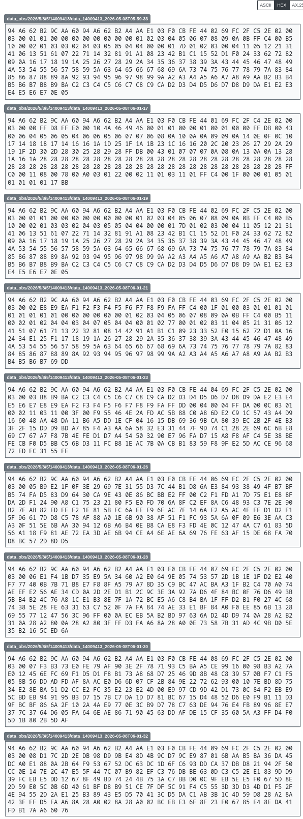

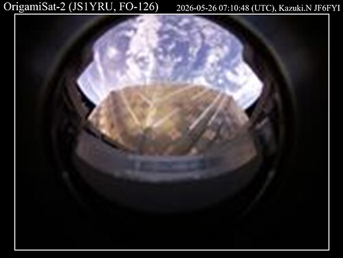

i try again, but without remove the huffman (FFC4)
origami-14154300-01.txt (37.5 KB)
origami-14154300-02.txt (12.6 KB)
origami-14154300-03.txt (11.8 KB)
origami-14154300-04.txt (11.7 KB)
origami-14154300-05.txt (11.6 KB)
origami-14154300-06.txt (7.7 KB)
and wow… cool:
thank you @nishikazu0417 for best obs!
conclusion: try first without remove the huffman. if the result is error like Bogus market length etc, try remove the huffman (FF C4 ..).

Hello @bali and @fredy,
I have received a reply from Associate Professor Tokumitsu, one of the members of the KOSEN-2R operations team at Yonago National College of Technology.
According to the information provided, the following details have been confirmed:
  • The object currently being tracked by the KOSEN-2R team is KAKUSHIN RISING OBJECT B (NORAD ID: 68793).
  • At present, the only planned transmitter mode is:
    • 465.360 MHz, AFSK 1200 bps
  • If communications are successfully established in the future, they may also consider:
    • 465.360 MHz, GMSK 9600 bps
  • Although the spacecraft is capable of transmitting DTMF signals, this mode is not expected to be used due to power consumption considerations.
  • The frequency 436.750 MHz, which was previously submitted to the IARU, will not be used for any transmissions.
In addition, they informed me that IQ samples of the transmitted signals should be available sometime next week.
Based on this information, I will update the corresponding entries in the SatNOGS Database. Please review the updates when they become available.
73,
Kazuki NISHIOKA, JF6FYI
Dear @fredy ,
I have one question regarding the SatNOGS DB update.
Since the current transmitter entry for KOSEN-2R contains frequency information that differs from the information provided by the KOSEN-2R operations team, would you prefer that I:
  1. Update the frequency and mode information of the existing transmitter entry, or
  2. Create a new transmitter entry and keep the existing one for historical/reference purposes?
I would appreciate your preference before making any changes.
73,
For the ones at 465.360 with the non-LoRa transmissions I suggest you create new entries.
If the 436.750 was never planned to be used then I suggest you set as invalid the current entries at this frequency with citation that explain this, if they were planned but not active, I suggest you set them as inactive.
