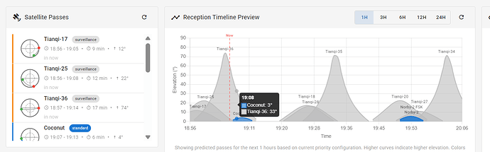

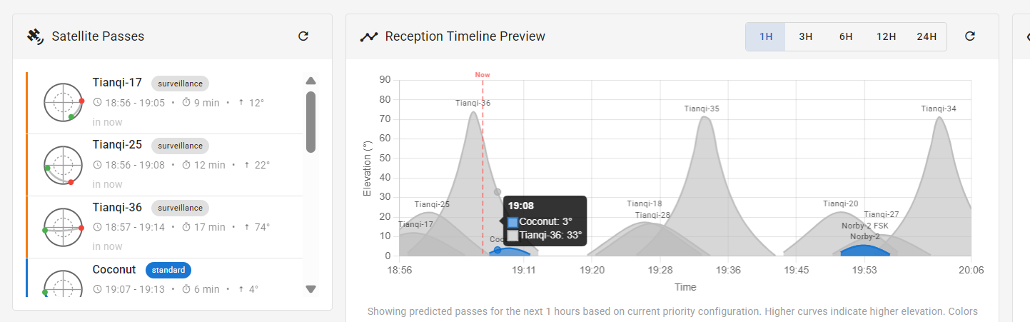

Standard means, there is no priority assigned by user, high prio are shown red, low prio green and surveillance prio - only tuned, when no other satellite passing - grey. What I cannot say is, how you get grey entries without labels. usually there it should say “surveillance”, blocked satellites are not shown in the list. So for me it seems, you have the Tianqi in the surveillance priority class, but I cannot say where the labels are gone :slight_smile: . Usually you get the best results, when you prioritize the satellites, which match the performace of your station best, because then the more favourable satellites are tuned instead of satellites your station cannot receive..

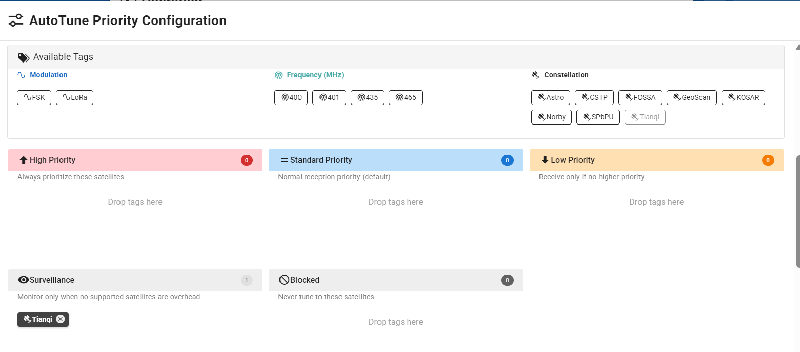

For my OE6ISP_1 it looks like this:
Prio settings
and preview

Hi @stefanp,

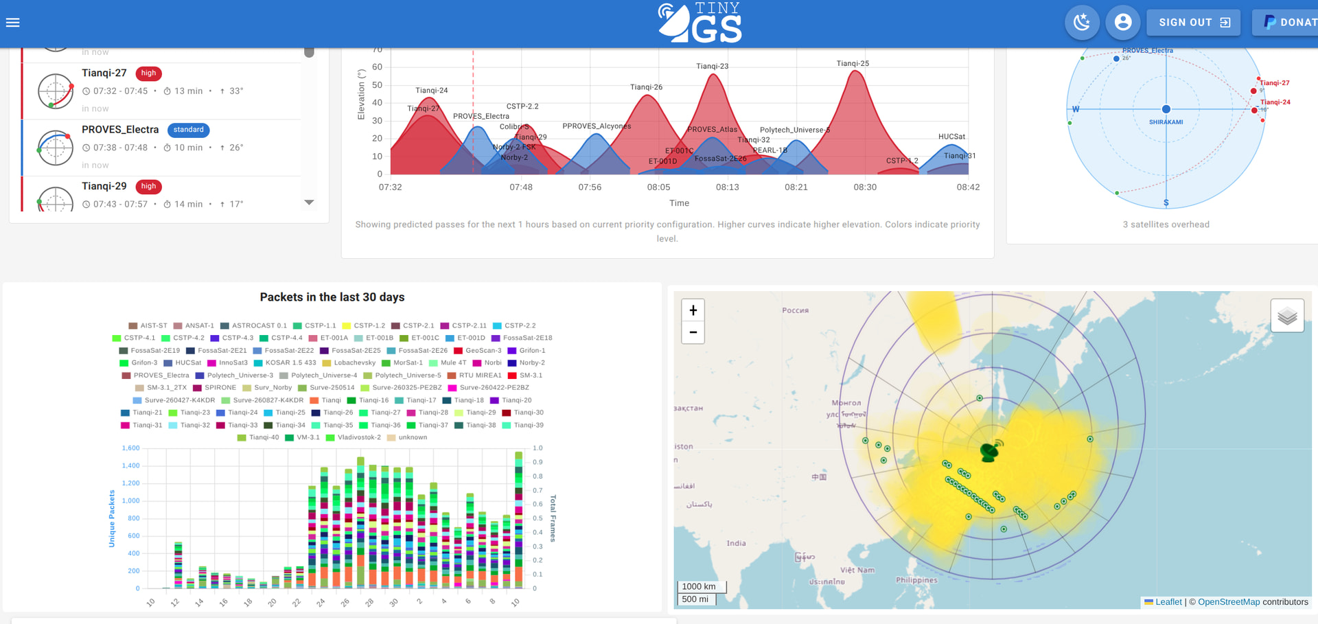

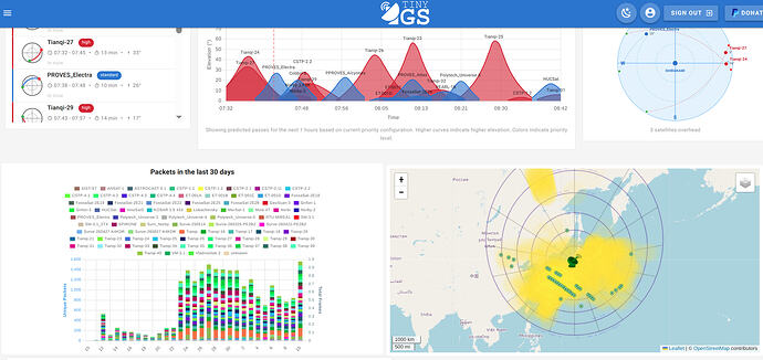

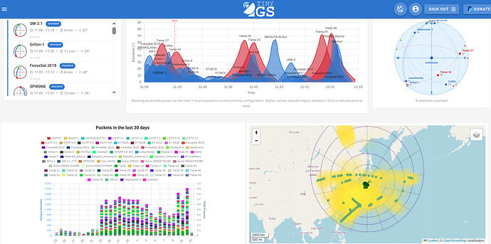

Following your advice, I adjusted my priority settings and set Tianqi to High Priority—and the results have been amazing!
My packet count jumped up significantly, almost reaching 1,600 packets in a single day! Prioritizing the satellites that best fit my station’s reception really made a huge difference. Thank you so much for the great tip!
