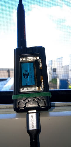

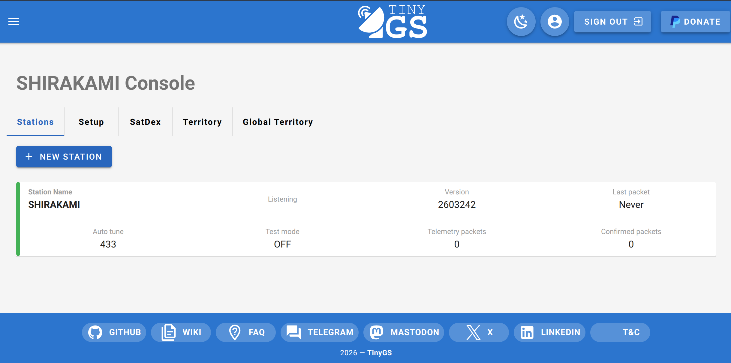

It took a long and winding road, but thanks to you all, it looks like SHIRAKAMI is finally on the air!
Next, I’ll get my antenna ready and take on the challenge of actual reception.
Sorry for all the trouble I caused, and thank you so much for your great help!

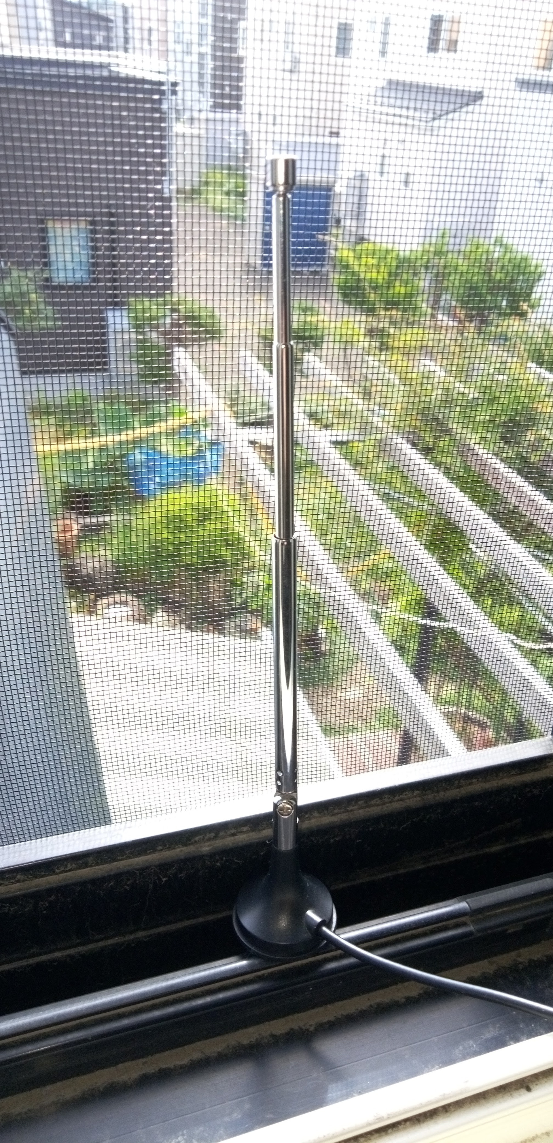

I swapped the stock antenna for a ham handheld antenna and now I’m standing by! Still no packets yet though… :satellite::sparkles:

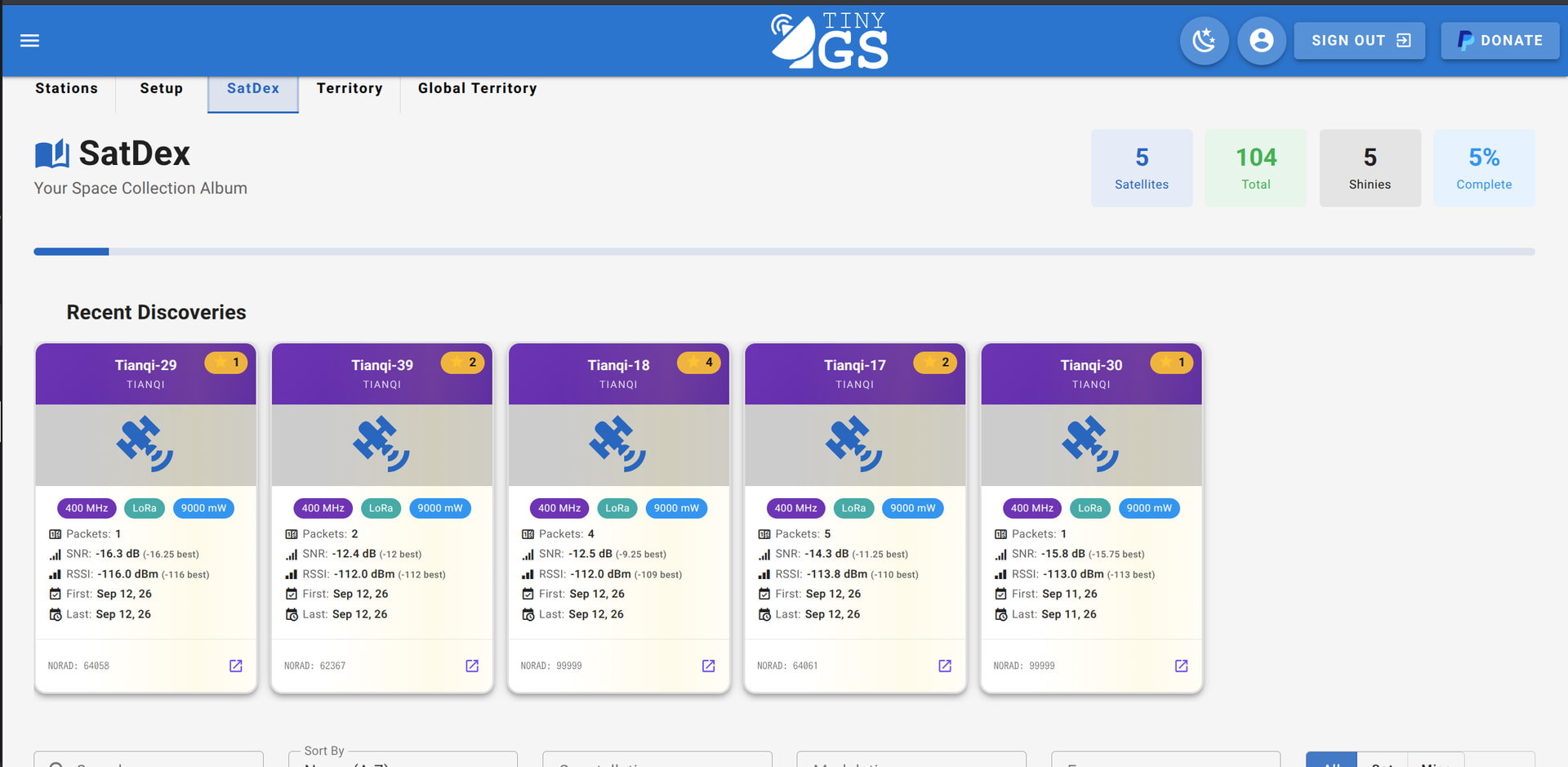

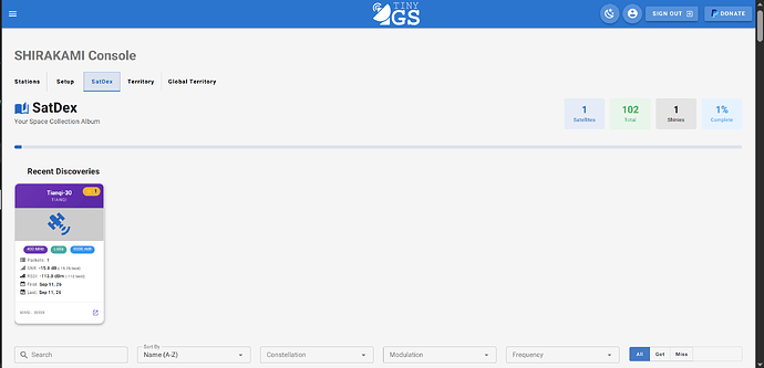

Look at this! :tada:

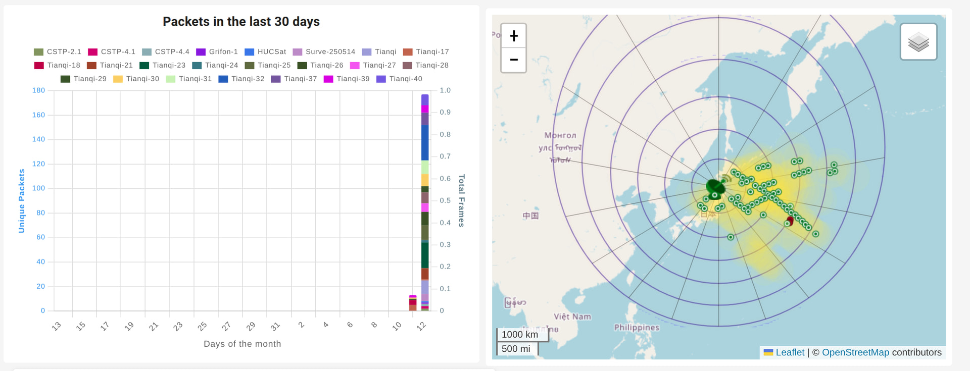

After all the struggles with initialization and debugging, SHIRAKAMI has successfully decoded its very first packet from Tianqi-30 and registered it in SatDex!
A huge thank you to everyone in the community for your patience, guidance, and endless support. The station is officially alive and collecting space data! :rocket::sparkles:

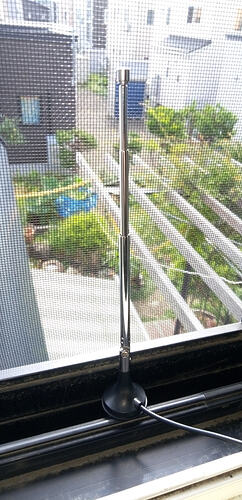

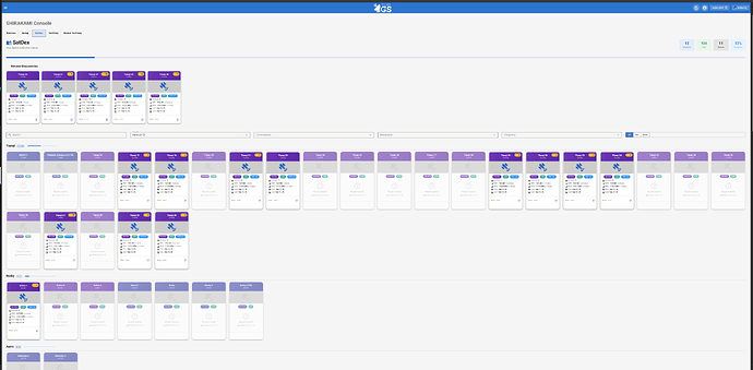

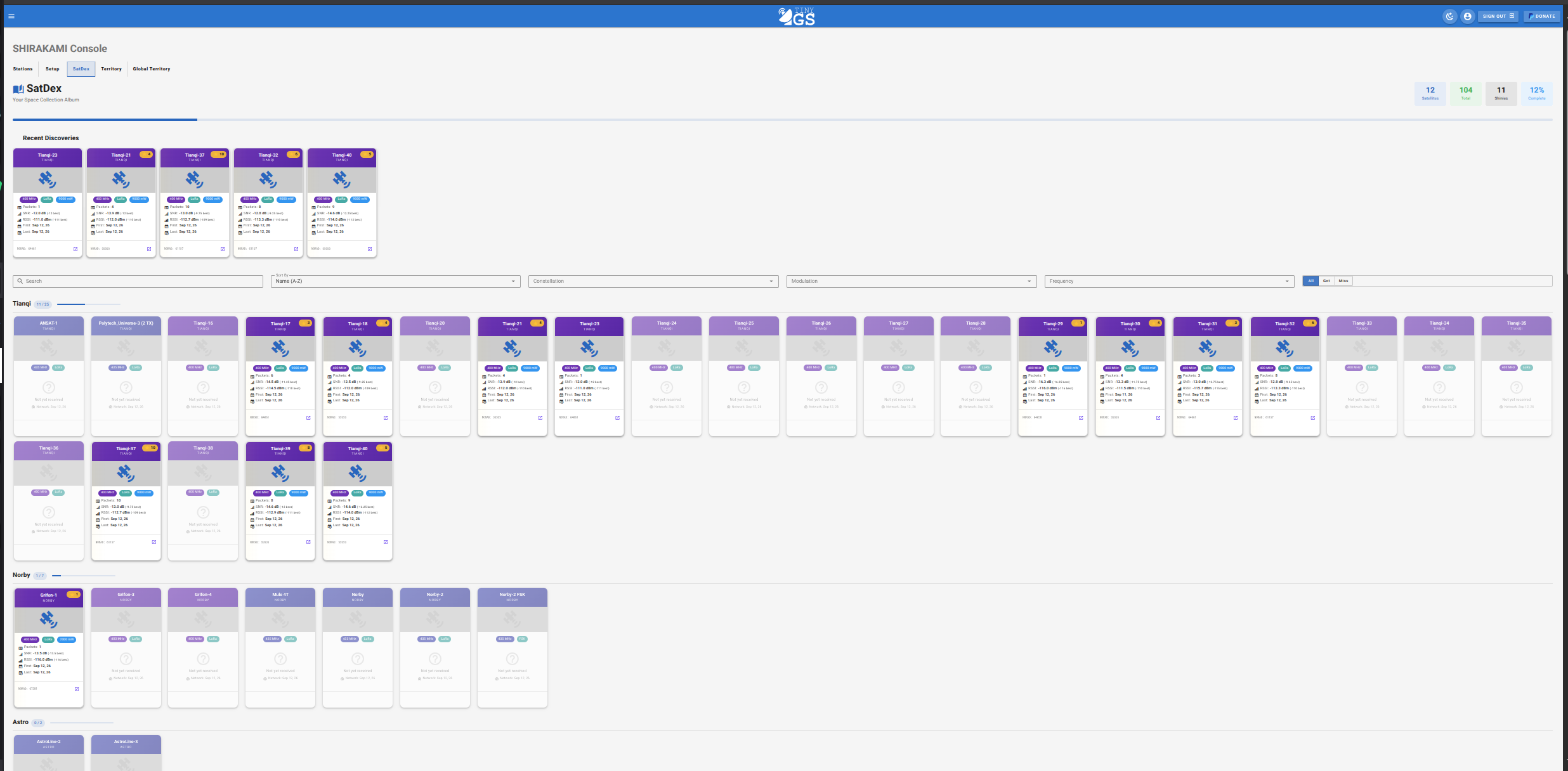

I adjusted my handy rod antenna to exactly 17 cm… and boom, 5 satellites captured! :rocket::sparkles:

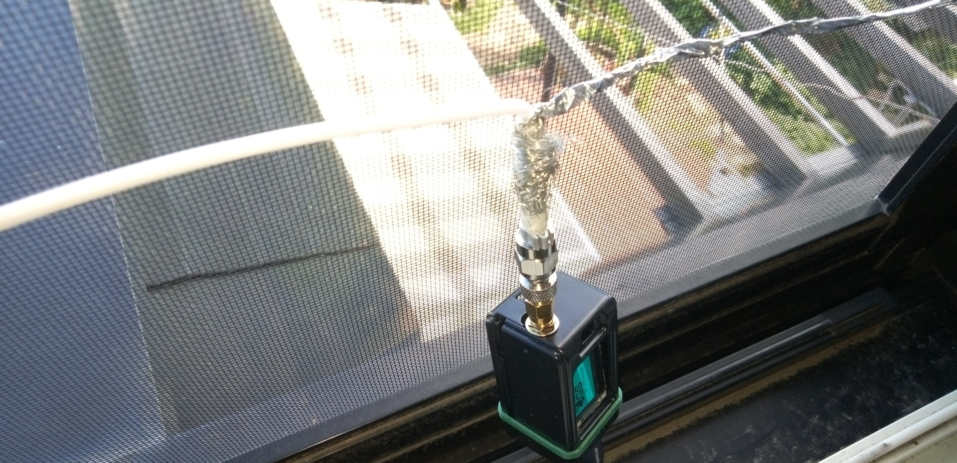

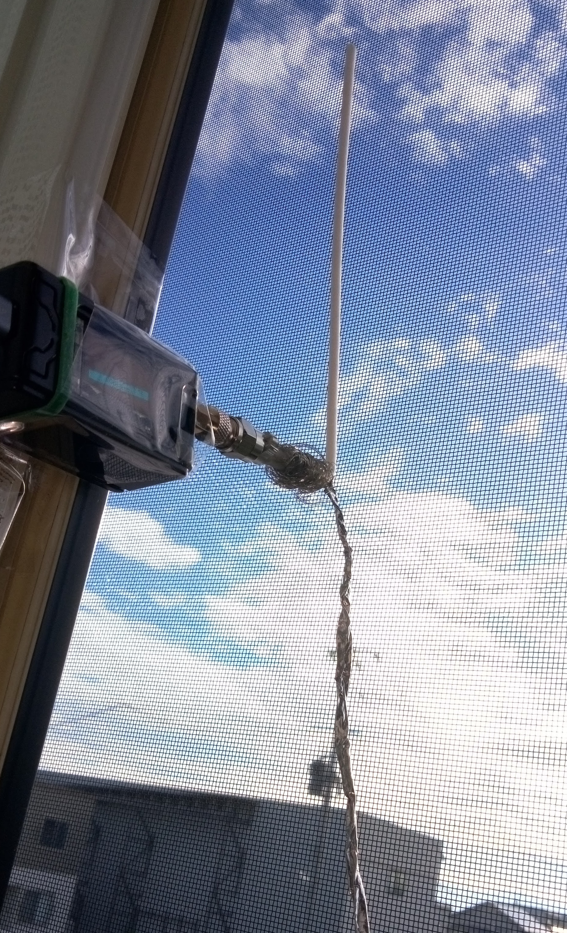

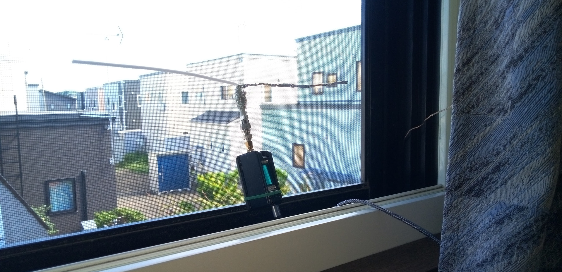

I replaced it with a quick, makeshift homebrew dipole antenna, and it turned out to be an absolute game-changer!
Here is my current setup and the latest SatDex collection.
Homebrew antennas are just the best! :rocket::sparkles:
Quick update! The makeshift dipole is still working hard and pulling in some great packets today. Homebrew antennas never disappoint! :rocket::chart_increasing:
Have a look at DK7ZB 70cm antennas, station 1696 is currently using the 4 element.
Thank you for the great suggestion, Jan!
As someone who gave up on indoor SatNOGS and came here for some quick fun, it’s more about an old-timer’s stubborn pride—proving just how much you can achieve with a lazy, makeshift wire antenna right by the window!

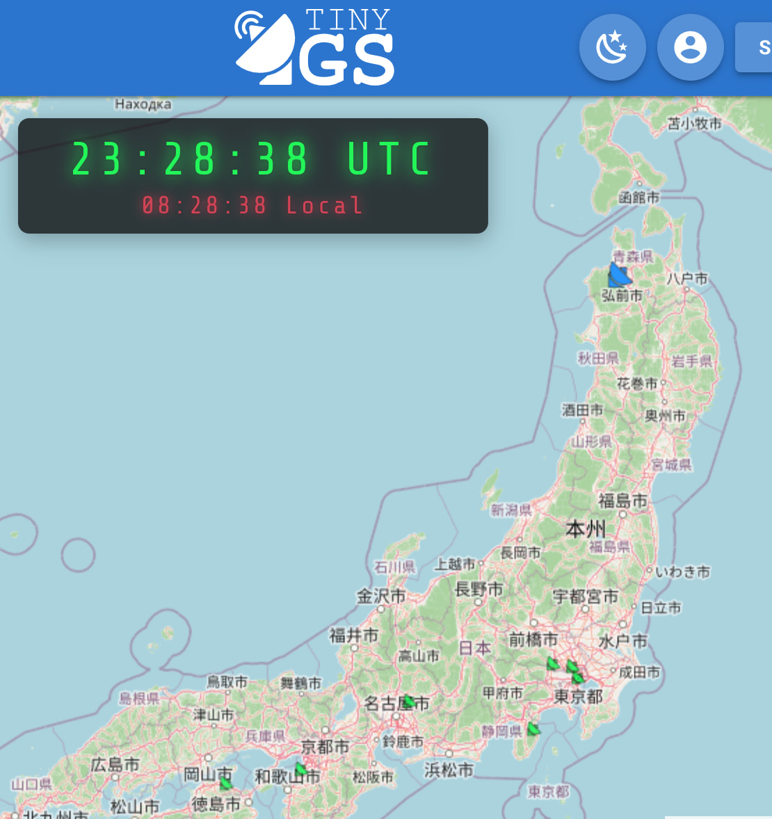

The 11th TinyGS station in Japan—SHIRAKAMI—is now up and running.
