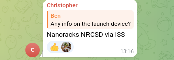

Deployment details (need verification):
from tinygs telegram chat:
if I interpret the above right, we have:

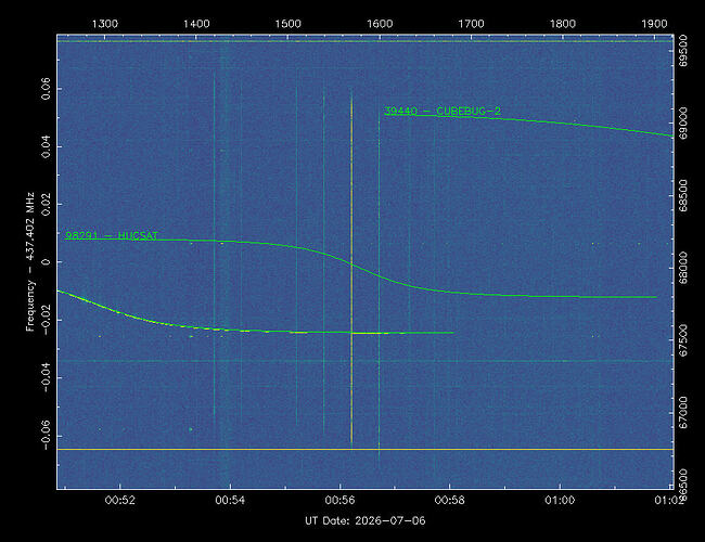

From @PE0SAT based on strf observation signals:
HUCSAT
1 98291U          26182.50817465  .00000000  00000-0 -62592-1 0    03
2 98291  51.6311 172.3219 0004224 255.0896 133.7992 15.49503254    02
COCONUT
1 98292U          26182.50817465  .00000000  00000-0 -62592-1 0    04
2 98292  51.6311 172.3219 0004224 255.0896 133.7992 15.49503254    03

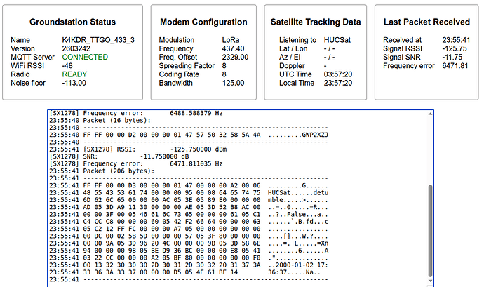

HUCSat is doing great, but nothing heard so far from the others.

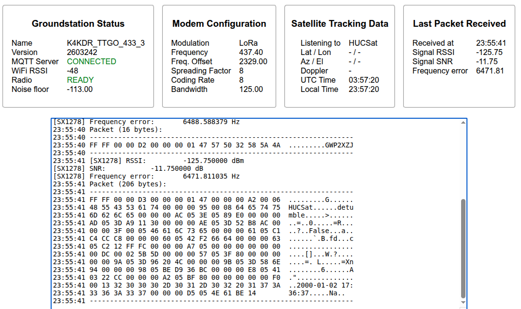

That is good to know, can you confirm that the signals I received are indeed from HUCSat?
They don’t look like LoRA.
I’m not aware if HUCSat is transmitting anything ELSE, but yes, we’re getting 125k LoRa from it on 437.400. ‘Most’ of the time, the sequence is a short packet followed by a longer one.

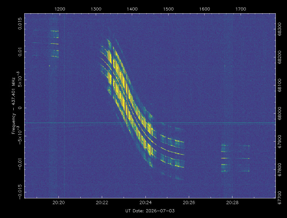

Thanks Scott,
Then we have a mystery signal on 437.400 MHz that seems to be from the same launch.
The search continues.

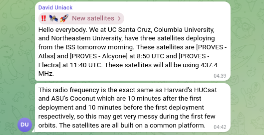

It’s an unusual deployment… all the satellites are reportedly using the same frequency.
I’ve been SDR-monitoring all the passes but so far have not seen anything but what turns out to be HUCSat when tested.
The one oddball is Coconut, which uses 62.5k packets. The others are all 125k.
It seems the mystery is solved, I have never seen STAR-A0 active on 437.400 before.

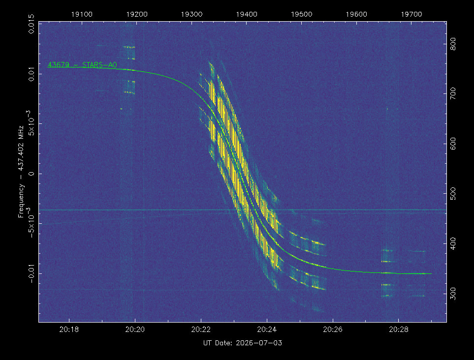

After adding some STARS-A0 obs in the network we have a successful reception https://network.satnogs.org/observations/14439654/
Replaying the IQ file tells us that it is 1k2 AFSK AX.25

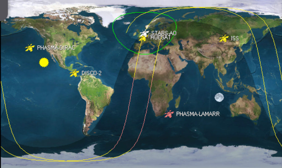

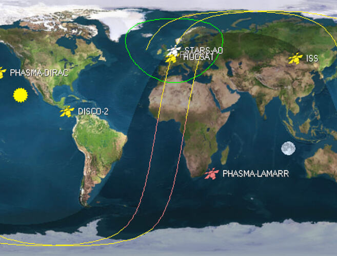

No sign of Stars-AO on a medium-elevation pass tonight.
I wonder if it only transmits in daylight, or if I just need it higher in the sky?

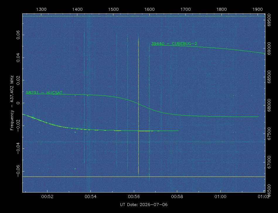

HUCSAT TLE Update:
These will be far from perfect but should be better then the preliminary.
Also without a way to identify the signal there is not 100% proof this is HUCSAT.
HUCSAT
1 98291U          26187.03915546  .00000000  00000-0  13146-3 0    07
2 98291  51.6458 186.9422 0010677 125.5812 340.4702 15.48446246    01
# 20260706.04-20260706.04, 7 measurements, 0.429 kHz rms

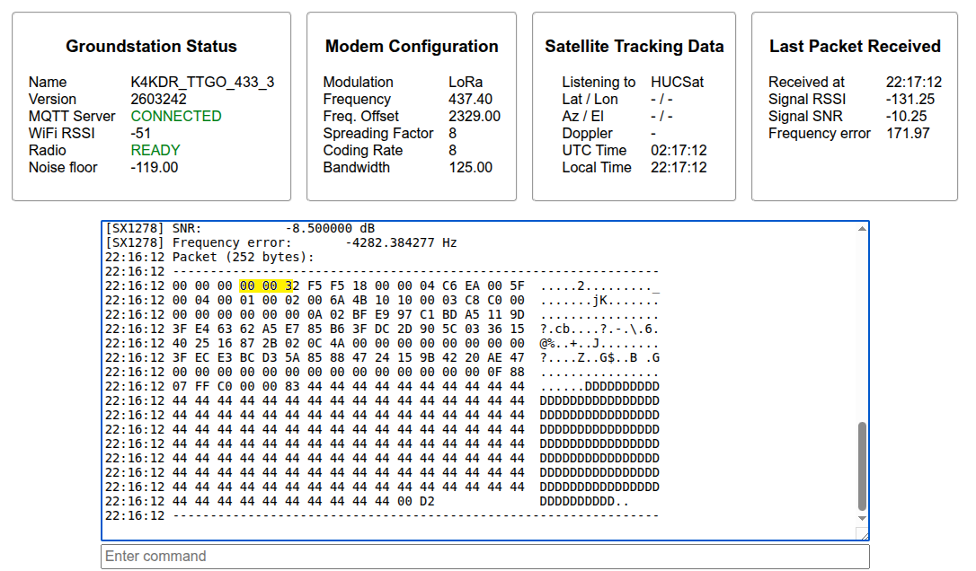

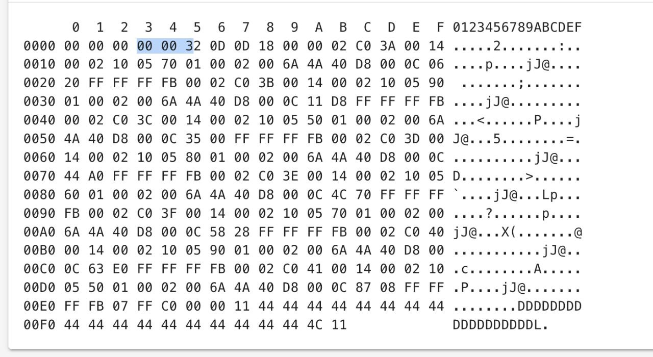

For anyone decoding any of the 437.400 LoRa packets from this deployment, we now have info on how to tell the -3- PROVES satellites apart:
The spacecraft id for Electra is 0x3 (Alcyone is 0x1 and Atlas is 0x2). These are in the CCDS primary header.
Example:
… so, this decode that I got last night was from PROVES-Electra:
Hello, and thank you for the TLE refinement! I can confirm that these telemetry beacons are from HUCSat.
Additionally, HUCSat has been correlated with NORAD ID 69794, and our HUCSat team has a correlation claim in progress with the Space-Track folks, so that change should be reflected there shortly.
Thanks,
Christopher | HUCSat Chief Engineer
