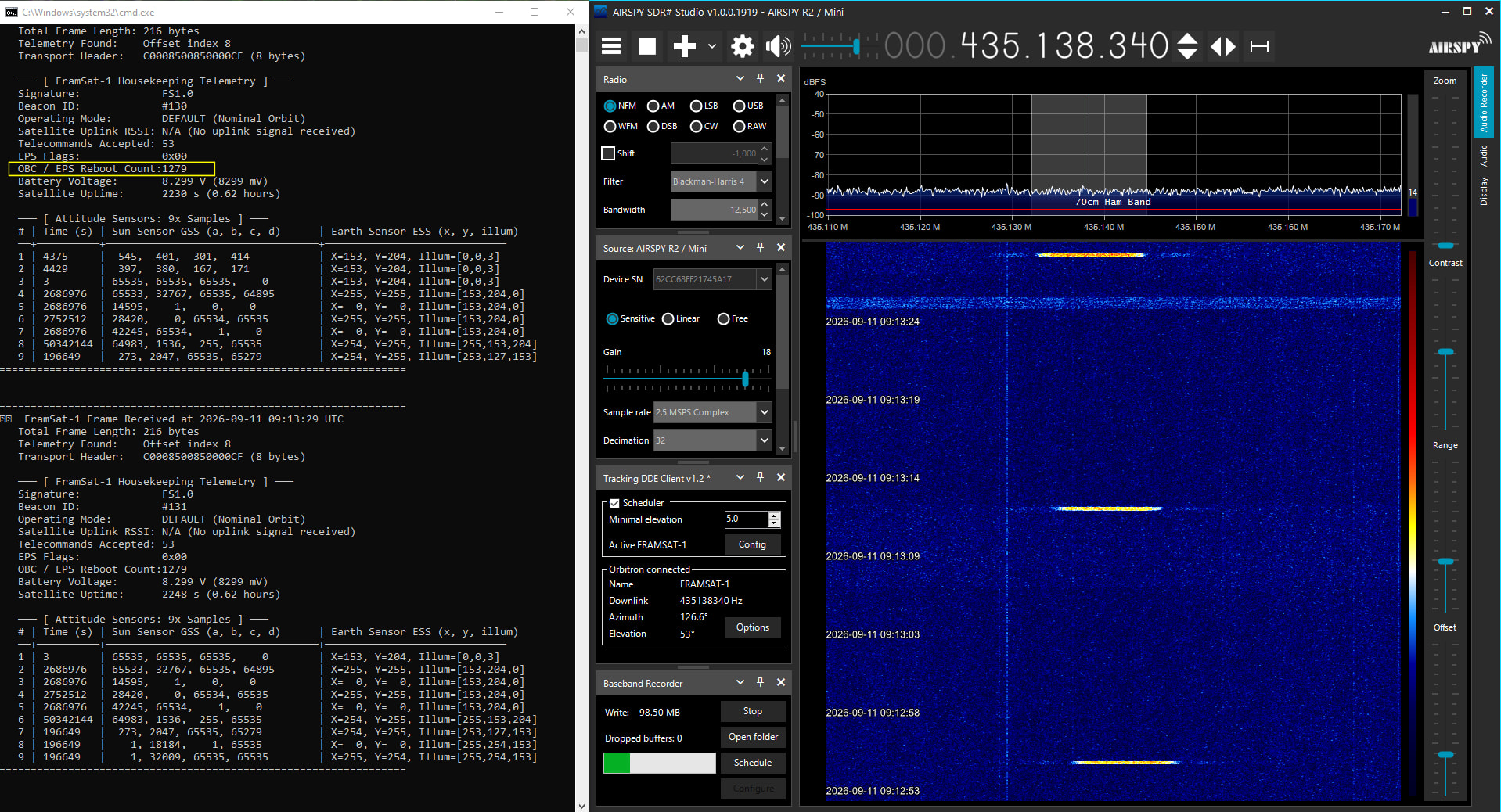

2026-09-11 09:10 UTC FramSat-1
The number of OBC/EPS restarts increased to 1279. :worried:
