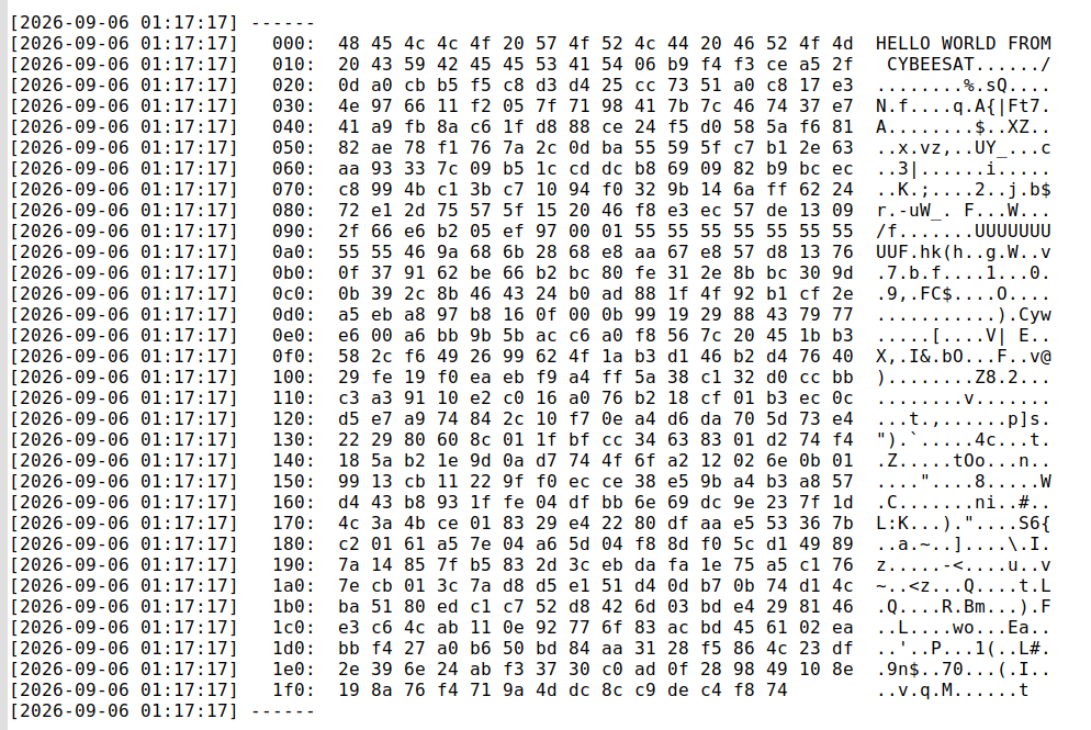

If someone has worked out a better decoder for CyBEEsat, please speak up since I can’t make any promises about the accuracy of this one.
Derived from https://gitlab.com/rccn/missions/cybeesat

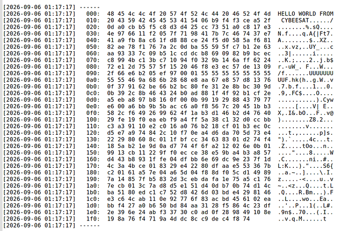

… which was a lot to absorb, I was able to output several frames including one with my beloved ASCII confirmation:
Here is the entire output:
frames.txt (9.2 KB)

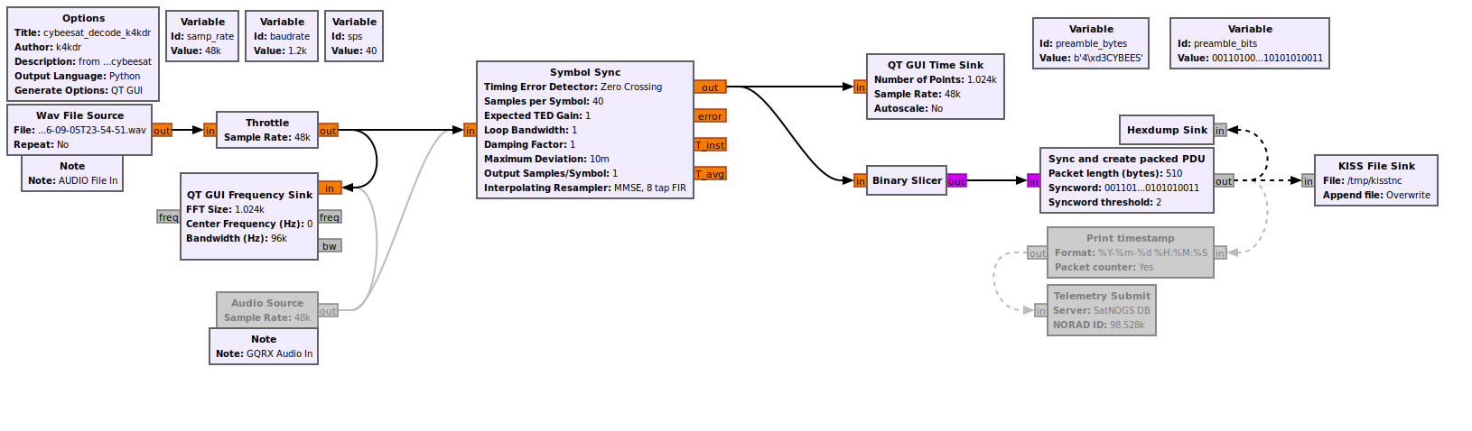

I will get my attempt at a flowgraph shared online ASAP as well as the audio snip that I used from: https://network.satnogs.org/observations/14941369/
… but here is a look at what I came up with:
