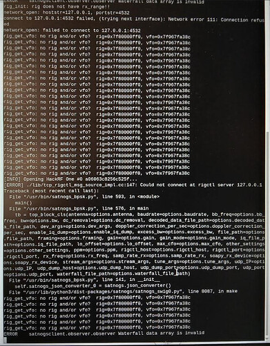

I am trying to set up a ground station using Satnogs and the HackRF One SDR. This is my first experience with ground stations, and as a novice it has been a bit of a learning curve. I am to the point where we are scheduling our first test observations and have cleared other errors (like getting the HackRF visible in Docker), but we are stuck on this last issue (below) to get our first waterfalls. Here is the readout for the last pass. All the passes now have this same error. The failure is connecting to 127.0.0.1.
rig_init: rig does not have rx_range!!
network_open: hoststr=127.0.0.1, portstr=4532
connect to 127.0.0.1:4532 failed, (trying next interface): Network error 111: Connection refused
network_open: failed to connect to 127.0.0.1:4532
rig_get_vfo: no rig and/or vfo? rig=0x7f80000ff0, vfo=0x7f967fa38c ( REPEAT MULTIPAL TIMES)
[INFO] Opening HackRF One #0 a06063c8256c525f…
[ERROR] ./lib/tcp_rigctl_msg_source_impl.cc:147: Could not connect at rigctl server 127.0.0.1
ERROR satnogsclient.observer.observer Waterfall data array is invalid
Any guidance is greatly appreciated.

and the last 3 observation attempt 2 on Friday and 1 on Monday. Window was open over weekend which I believe is why there were communication errors in between the Friday and Monday attempts (normal?)

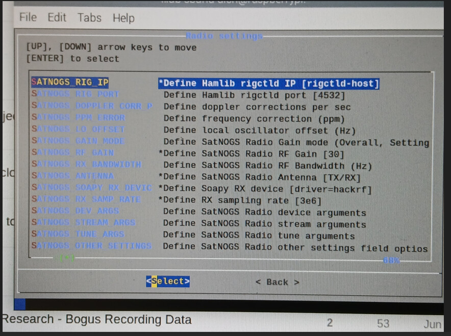

Well looking at the log file the client is unable to connect to the doppler correction service.

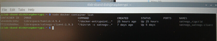

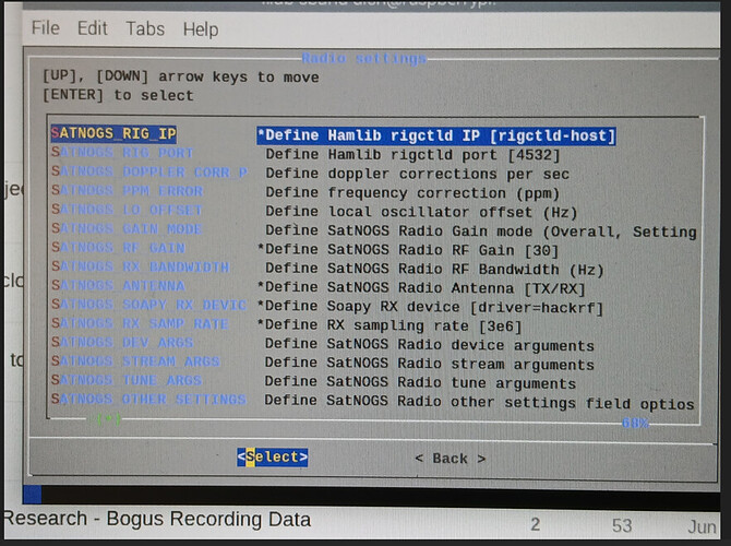

There one should use the rigctl service name and if I am correct that should be satnogs_rigctld and not rigctld-host
docker container list should give the name if in doubt.

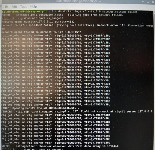

Thanks!! I have changed. I tried to double-check using “docker container list” but was getting a permissions error - will try again later.

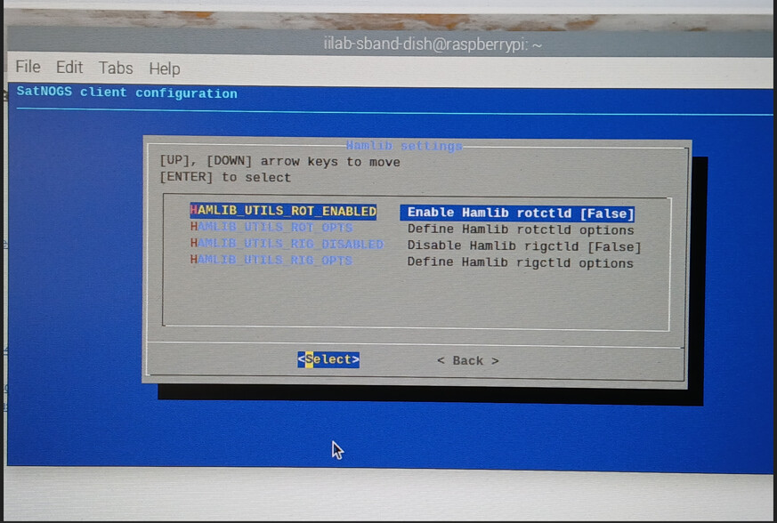

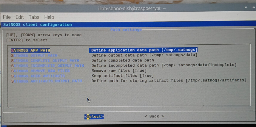

Could you also check these below, please, and see if anything else sticks out. (Someone “borrowed” my antenna, so I have to wait till tomorrow to schedule new passes anyway)
Regarding the permission denied you can add sudo to the command this should allow you to run it.
Other default settings should be fine.
Thanks you. I will try to run new observation tonight using satnogs_rigctld instead of rigctld-host. I have changed it. I also ran the “sudo docker container list” and got this. Not sure if that is good or not.

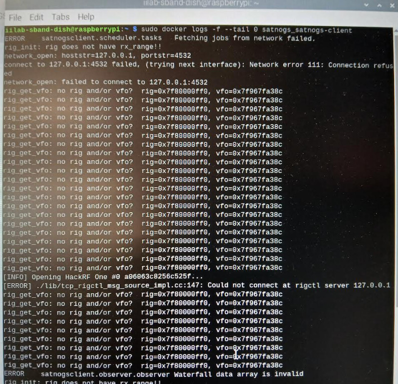

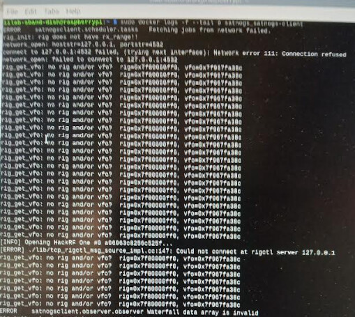

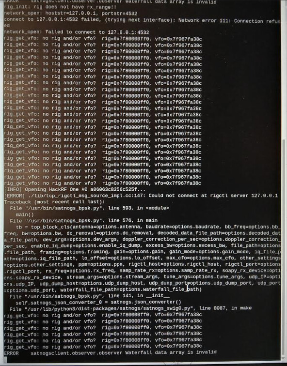

First two observations ran and failed. Here is what the logs looked like - Both look same. Suggestions?
The container names look oke I only doubt if the versions are correct, hamlib 4.5.4 and satnogs 1.9.3 at the same time shouldn’t be an available setup. I get the impression a lot of manual changes are tried that are now causing other new challenges.

I scheduled 4 passes and it looks like the same error as before, which seems to center on failing to connect. However…….I see a possible discrepancy. It says 127.0.0.1:4532
This one below has some more verbiage, but 2 after this one are the same as the one above.

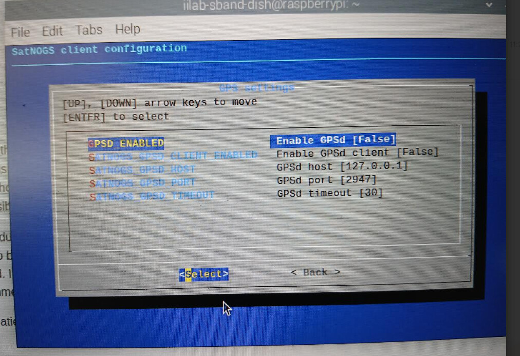

However on this page in the client, it says a different port - I know it says GPSd and false but is there any other page or place this comes into play? Could all the manual tinkering have broken something else somewhere else, related to the port?

Have a look at this observation and compare with your configuration. (This station has a LNA in combination with the HackRF)
gain-mode: "Settings Field" in combination with other-settings: "AMP=14,LNA=40,VGA=26" opens the option to be more granular in your gain settings.
lo-offset: "200000" can be used to move the HackRF DC spike out of the reception area.
