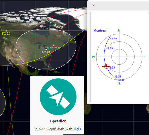

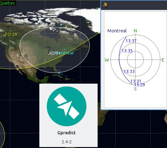

Hi,
I got two different version of Gpredict, two different PC.
First version work very fine (beta version I believe)
Tracking my antenna correctly
My second PC version doesn’t detect my home observation location.
(Both system run the rotctld cmd in terminal windows)
(This version is, I bebieve the latest) Any idea..? VE2DSK
INFO Hamlib
rigctld and rotctld 4.5.5 version working on first PC
rigctld and rotctld 4.6.5 version non working on the other PC
Hi,
my conclusion is…
I’m using DragonOS for a lot of SDR and other utilities
DragonOS Resolute (26.04) come with Gpredict 2.4.2 (rigctld not work for me)
DragonOS Noble (24.04) previous version come with Gpredict 2.3.xx (rigctld work for me)
