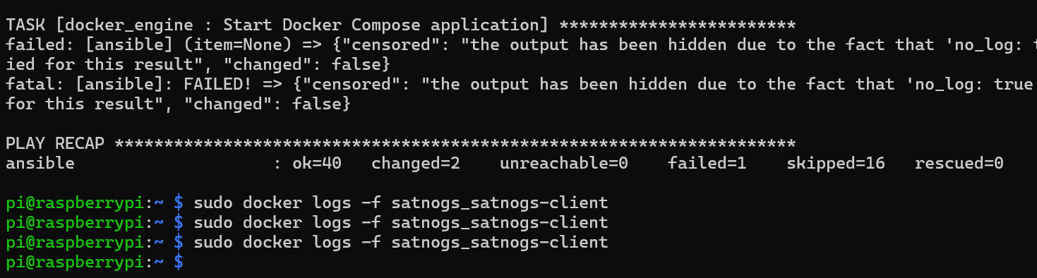

Using satnogs-setup for my 1.9.3 docker installation and changing only SDR-gain triggered an automatic update, which failed and prevents the client from starting.
Were there any major changes?
How can I get this up and running again?

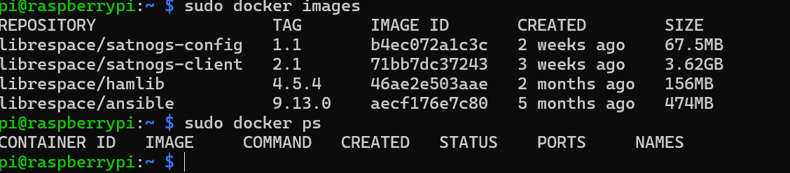

sudo docker images
sudo docker ps
bali
December 8, 2025, 9:05am
4
ok. now your stations has beed upgraded to satnogs_client 2.1.
the default id of user has been change from 999 to 500
Ok, why does docker fail? How can I get it up again?
