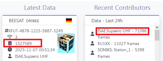

Error in submitted frames

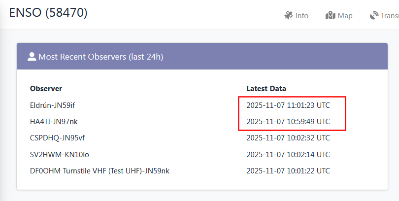

Screenshot taken at 10:19 UTC. How is this possible?
Probably someone hasn’t set right the timestamp. I’ll open an issue to add an additional check if timestamp is in the future then to not accept it. Thanks for noting this!

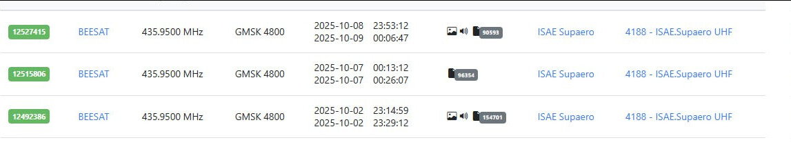

How do you like this?
BEESAT is usually not active, it is turned on only on major holidays.
I moved this in a new topic in order to discuss it without spamming the β€œENSO re-entry” one.

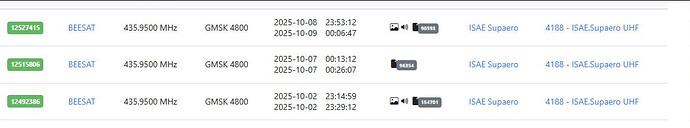

Looking in https://network.satnogs.org/observations/12492386/ the frames comes from the gr-satellites running in parallel with the satnogs-client. All of them are noise frames as there isn’t any signal visible and the pass is very low.
With the current architecture, unfortunately the noise frames are reaching DB. Maybe we should reconsider it. Any suggestion is more than welcome on how we should handle this situation.
The issue is indeed with gr-satellites, we at TU Berlin have also noticed it. The cause is the new MobiTUB decoder by @kerel designed for TUBIN/TUBiX20. BEESAT-1 causes here a problem due to different framing. The good thing is it was already fixed in gr-satellites, see:
