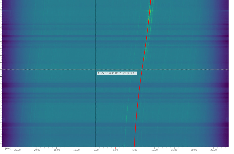

(Concluded) Observation 13354199: KNACKSAT-2 (98532) APRS or FSK9k6 - Digipeater - AX.25 G3RUH
Regarding Observation 13354199

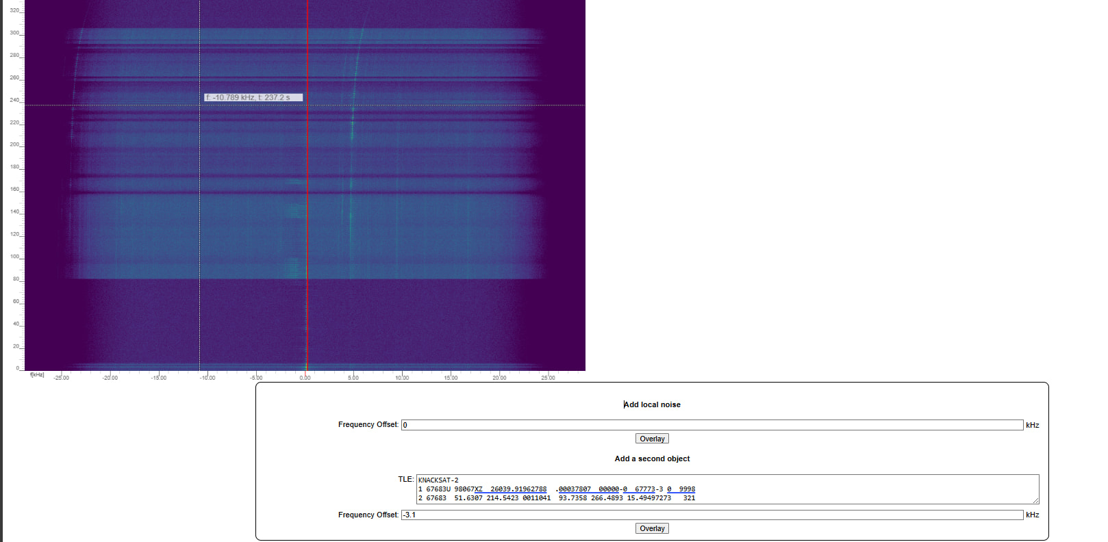

I’m not sure, look like interference from local
you can make sure and test it with artefact
follow the tutorial here
Sure, Thank you I will check this. I’m still new with this.

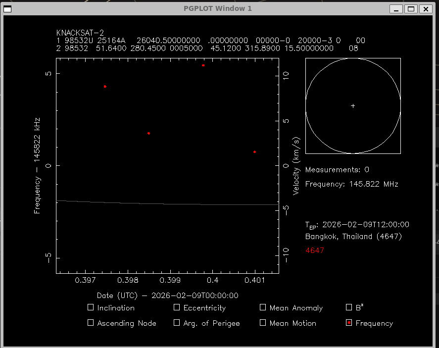

I’m downloading STRF now, it perfectly alight with TLE which right now is ISS
Confrimed: NOT knacksat2
