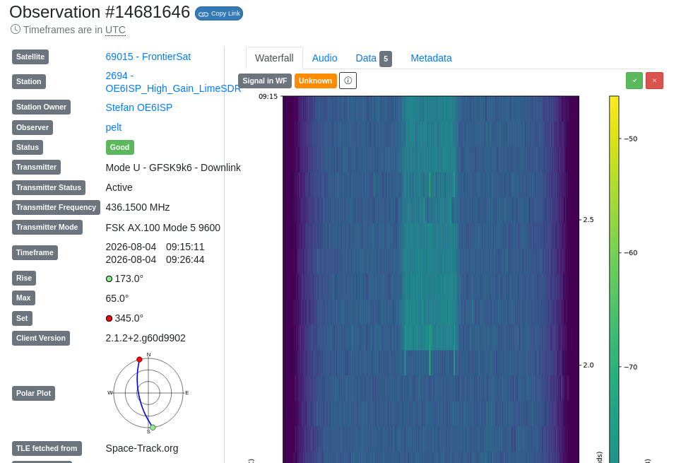

Hi,
is there any progress solving this already known issue?
For some time I was able to work around this problem by using gr-satellites, but recently it always crashes with “invalid pointer”. So it is not possible to stable decode any of the ax.100-satellites.
I am using the latest librespace/satnogs-client:master-unstable image
Stefan / OE6ISP

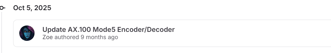

there were major changes last october
I went back to V2.0 and there it obviousely works perfectly.
So I would assume, it was the update last October, that broke something.

Thanks for checking. I don’t see how changes from that commit affect performance at first glance so I have to check it more thoroughly.
It is not about the performance, but more the fact, that ALL decodes fail with “symol errors” and the observations finally crashing with “invalid pointer” after this commit in 2.1.

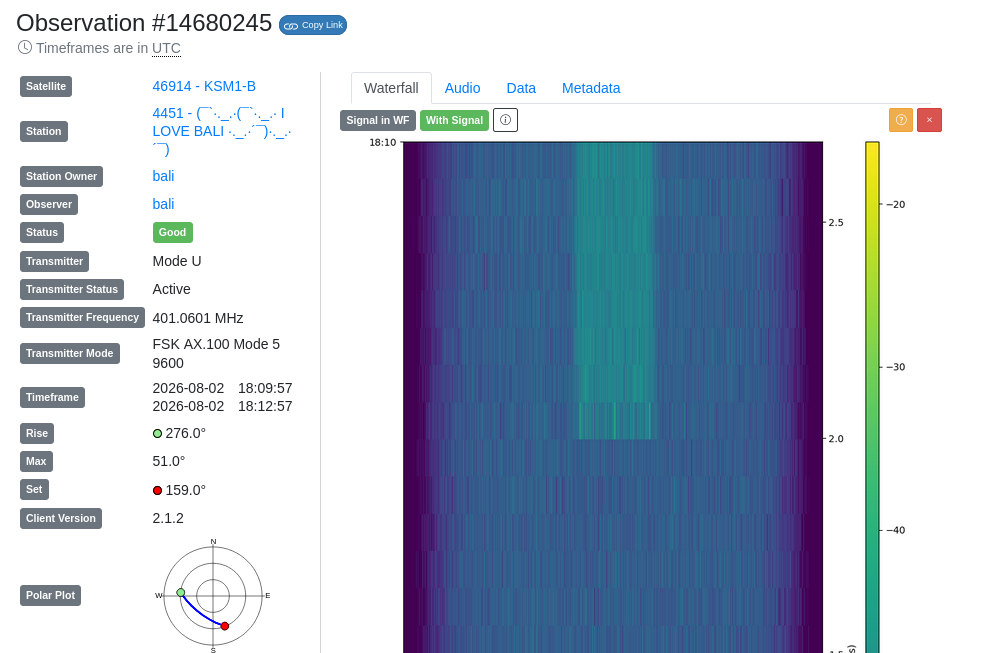

same case with @stefanp , with different satellite:
i check on network, and seen all some 2.1.2 station affected by this bug.
indication: the waterfall interval shorter than obs timeframe
As far as I could find, the problem is specific for all satellites with AX.100 MODE 5 - as the error-message says, there is a problem with the RS-decoder.
The short waterfall comes from the crash, that terminates the obs early.

Looking at the recorded IQ file size, I get the impression the whole flowgraph is crashing
… the log looks exactly like mine.
My station reported all records with wrong RS block and usually crashed after the 5th, sometimes earlier.
